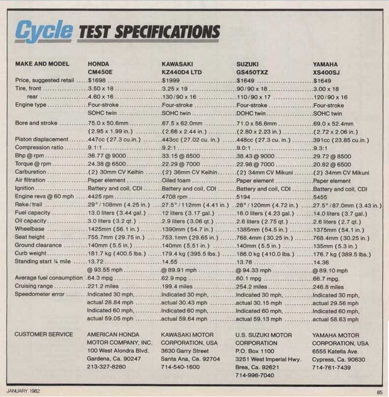

martin_csr Wrote: "What do you mean when you say the stock carburetors are crap? Also, do you have the complete stock airbox? "
Excellent question! The KZ440 bikes ran perfectly fine when new, so the carbs were well matched for the engines. However, the KZ440 was never really intended to be the quickest bike in its class as the image below shows. It’s a road test comparison from January 1982 Cycle Magazine. Changing carbs is not going to turn an average performing bike into a superbike, so if one is looking for a really quick bike it might be wise to select a different model rather than trying to make a KZ440 a rocket. Ed

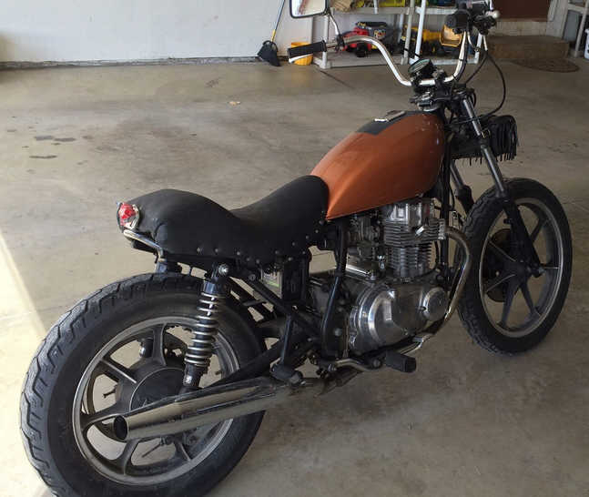

11 Jul 2017 08:09 - 11 Jul 2017 08:11martin_csr wrote: I was thinking new carburetors would be pricy & his 440 might be running poorly because of a missing airbox. ???
I believe you are absolutely correct! I found a picture he posted (see image below) so if that is the bike he still has it is missing the airbox. To make matters worse, the bike came with CV carbs, so tuning them to run well may be beyond his (or maybe anyone's) capability. The stock CV carbs were very good carbs, but if one rips out the air box all bets are off. Ed

Re: 1981 KZ440 carb recommendation
11 Jul 2017 08:11 - 11 Jul 2017 09:04
For easier tuning then I guess new mechanical slide carburetors would be a reasonable option.
To the op: some guys have had success fabricating an airbox & using the stock carburetors.
31 Jul 2017 19:47
I struggled for weeks tuning the stock setup without an airbox, those CVs are tricky as they come. Went to the stock airbox and had them dialed in pretty quickly with straight pipes. Never heard of anyone getting a great tune with pods on stock.
