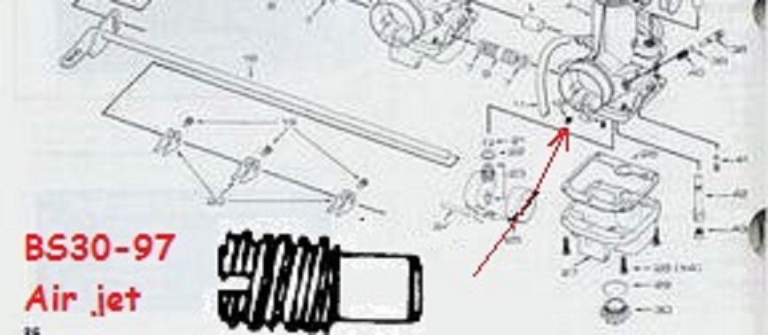

Where adjusting the pilot air screw produces no discernible difference in rpm, it's likely that the pilot circuits are not perfectly clean. It's important that the orifices are clean and clear where the pilot circuits exit into the carb bores.
It's also important that the air jets BS30-97 are clean and clear.
Properly set up, the 29's will produce a strong and steady low rpm idle, and very acceptable everyday street-riding performance, with no extra maintenance requirements, at least with the stock air box and reasonably free-breathing 4>1 exhaust.
