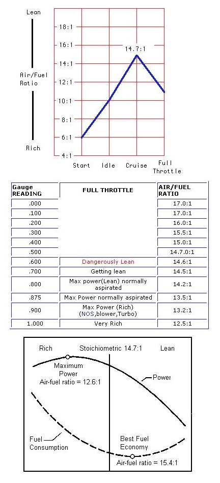

Getting these carbs dialed in is not easy.
I did a sync on them and have all four carbs dead on. They were way off. I will place a number to the carbs to show the difference though the rack.
1. 8
2. 9
3. 12
4. 11
_________________________________________________________________
This is the setup I have as of tonight
P-6 NEEDLE JET (UP TWO FROM STOCK P-4)
-3 SLOT ON JET NEEDLE (STOCK)
17.5 PILOT JET (STOCK)
PILOT FUEL SCREW (1-TURN)
0.8 AIR JET (STOCK)
130 MAIN JET
B8ES PLUGS AT 0.26 GAP
DYNA-S AT 38 DEG TIMMING
IDLE:
12.8 AFR
PART THROTTLE OR CRUISE:
13.3 AFR
WIDE OPEN THROTTLE:
10.5 to 11 AFR
Running rich and laying down, not pulling. Would like to get AFR up to 12.2

Seems your running as follows...
Idle: Still Lean
MID: Slightly rich but pending temps and % of accuracy of the Wego, may be ok
WOT: Too Rich
Obviously other factors such as ignition timing, cam specifications/degreeing, head porting, etc.... all come into the equation as well...
AZ temps & Elevation on my setup....
NOTE: pending ambient AZ temps (80 - 100F) @ ~ 1200 elevation, low humidty <30%...
IDLE: AFR ~ 10.8 - 11.5 @ 1000-1200 rpm
Cruise - MID Range, steady throttle @ 4000-5500 rpm (~ 60 - 75 mph), ~ 13 - 14.3
WOT: ~ 12. - 14, pending throttle twist vs steady throttle
Maybe this will help.....
Idle: Still Lean
WOT: Too Rich

Well I tried a new setup today and it really liked it. I am very close .
Idles great and is really pulling hard all the way through without laying down. Sick fast.
My high lean was 15.4 AFR
My low rich was 10.4 AFR
The great news is these were just quick spikes about a second in duration max. My avg AFR was 13.5.
The RS carbs are a bit harder to tune due to the accel pump......you can set it to come in at different throttle positions, need to mess with this and get it right.
COLD START IDLE: 10.5 AFR
WARM IDLE: 11.9
PART THROTTLE / CRUISE: 13.4 AFR
WIDE OPEN THROTTLE: 12.8 AFR
