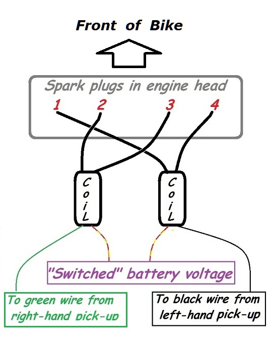

Here's a dumb question for you guys...what order should the spark plug wires go on the two coils underneath the gas tank?

schmjj01 wrote: ...what order should the spark plug wires go on the two coils underneath the gas tank?
Regardless of which coil is mounted where, the important thing is that the wire from the left pick-up (under the points cover) goes to whichever coil is firing the outside spark plugs #1 and #4.
And that the wire from the right pick-up (under the points cover) goes to whichever coil is firing the inside spark plugs #2 and #3.

One coil fires 1 & 4 (the outer cylinders) the other coil fires 2 & 3.
