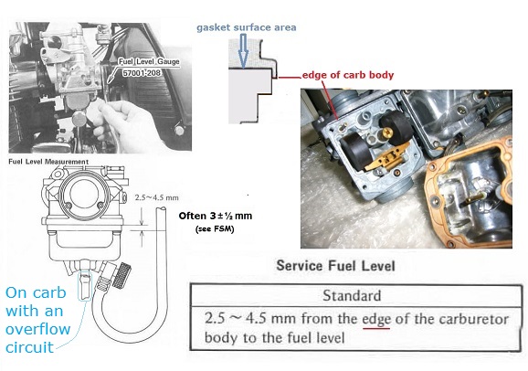

Patton, that drawing is misleading. It shows the service level up to the edge of the carb body, but area 4 should start 2.5mm below the edge of the carb body. Si?

29 Aug 2013 01:33Haybus wrote: Patton, that drawing is misleading. It shows the service level up to the edge of the carb body, but area 4 should start 2.5mm below the edge of the carb body. Si?
Alan
Many thanks for the heads-up!
Will make the correction, and edit the post.

Ok. That is the way I did it. I measured from the visual transition between the bowl and the body (the edge), and I am at about 3 mm for each carb. Maybe I should check again just to be sure.

When checking the fuel level in the bowl I have found that it's best to actually measure with a ruler and the clear tube held against the carb body. You can hold the tube for carb 2 against carb 1 and that works. Spec is 4 +/- 1mm according to the Haynes manual.

For the fuel level, I used a marker to make two lines. One line was lined up with the edge of the carb body, while the second line represented the 3mm. Since the marker lines were think, it isn't the most accurate. I will use a ruler and try to be more precise.

Your method of measuring sounds pretty good and I'm sure its fine. I used to do eyeball but found I was way out when I actually measured.
I did check the Haynes manual and corrected my post above as the spec for fuel level 4mm +/- 1 mm, Getting the fuel level right in spec was the single biggest improvement I made to how my bike runs
