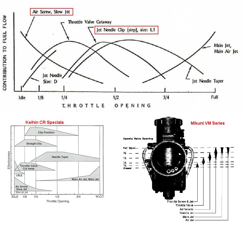

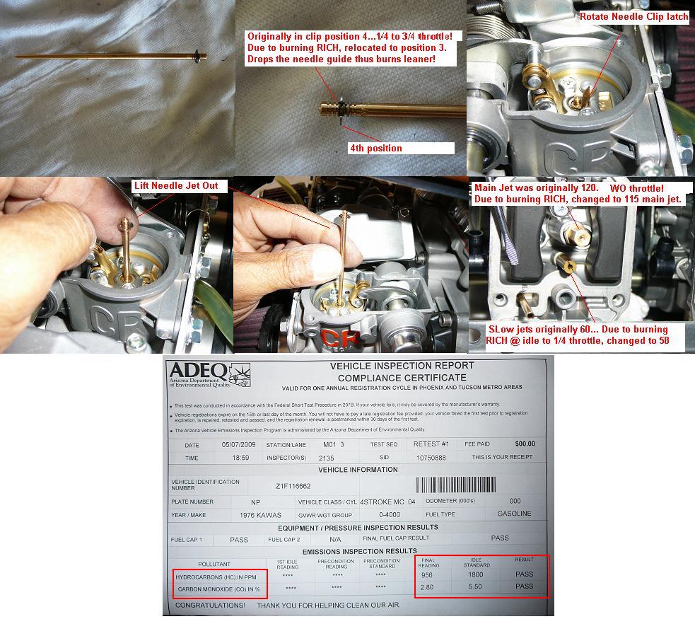

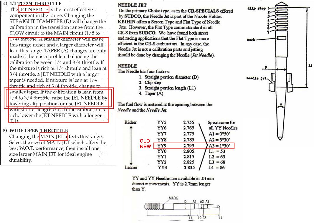

"YY8 needles at 2nd clip."... this leans it out, sounds as though running lean @ 3/4 throttle to WOP thus you'd want to richen it!
You'd want to lower the clip position down to raise the needle for more gas flow....
Possibly different needle... In case you need...
Plug conditions...?
Plug conditions...?

How is it that nobody even questioned the #80 Slow Jet? I can't see how it could possibly want that much pilot jet. Where are your air screws? 4 turns out I'll wager.
The first thing you want to do is address that situation. It is the single number that immediately jumps out as being out in left field. Regardless of the fact that you're having top end issues, that's got to be way too much fuel being dumped in through the pilot circuit.
It appears you have electrical issues also but you need to start with a reasonable jetting spec. Something around a #60 slow jet is much more reasonable.

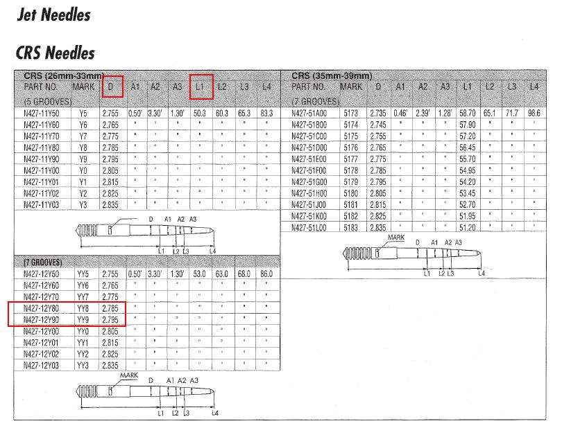

When i bought the carbs from new they were jetting for my bike: 65 sj, 1 turn out air screw and YY8 needle, but idle "hangs" after blipping the throttle and the engine be slow to retun to idle after running. I couldn´t solve it turning the air screw, even Colortune indicated leaness whith all the turns of air screw. I tried with several sj: 70, 75 and 80 and always 1 or 3/4 turn out but less than 1 turn out because when blipping the throttle, the rpm fall back down below the set idle speed and then recover, and turning out the screw the engine "hangs". I know 80 sj is so high but it´s the only one that let the idle stable and almost perfect at 1250-1500 rpm. Maybe with richer needle diameter i can try with smaller slow jets. I knew installing these carbs would be a little adventure because i haven´t found any info in all Internet about cr29´s on a Kz650. I´ll post a video at idle
Anyway I'm not an expert and probably doing something wrong.
