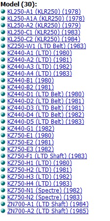

It fits 30 different Kawasaki models. 16014-1011 SCREW,PILOT ADJUST
