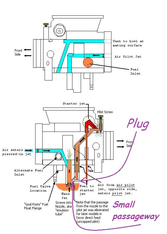

Am thinking the tiny passage is blocked that's supposed to supply fuel from the main to the pilot circuit.
Carbs won't perform correctly without the plugs.

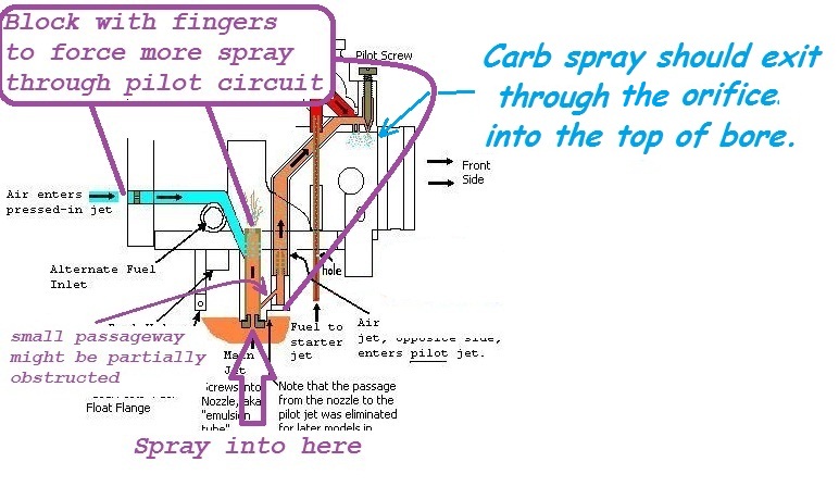

I had a GS1100 that wouldnt run because the air hole was plugged up. If you block the pilot jet hole with one finger and the hole where the fuel comes out in the carb with the other and spray carb cleaner in the air holes it should come out the idle mixture screw hole unless its plugged. I dont think you can see the hole. I had to saw an old carb in half to find it actually existed. I fished a piece of guitar string each way to clean it out. Whether its there on your year KZ or not I dont know. Its there on 83 Suzuki GS1100s though. I had the carbs & airbox off 9 times before I figured that out so good luck

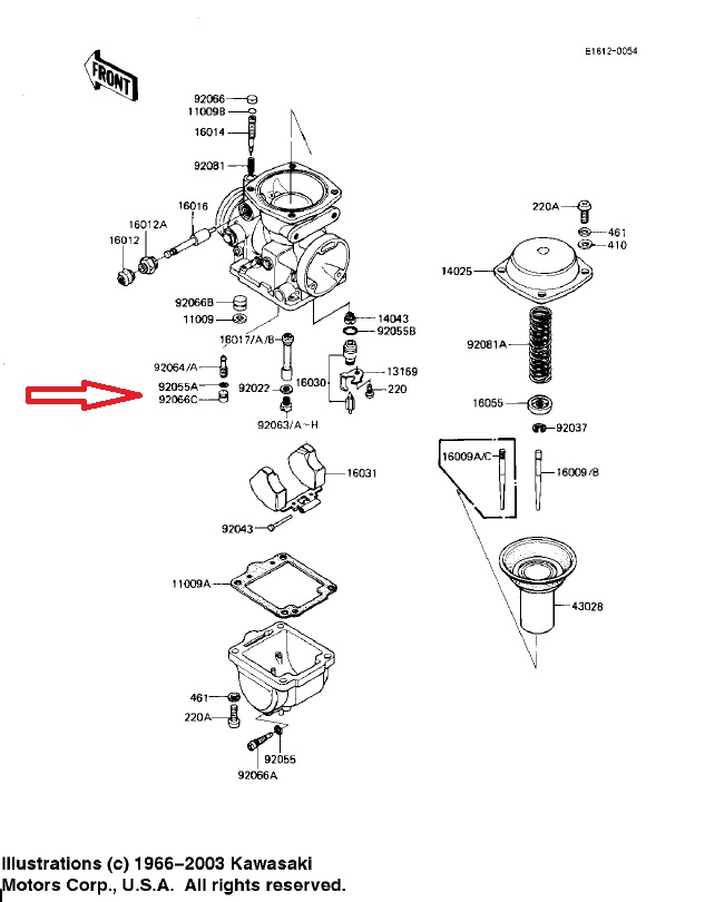

The diagram at kawasaki.com shows the plugs and o'rings, which would indicate that the pilot circuit likely receives fuel via the tiny passage from the main circuit.
