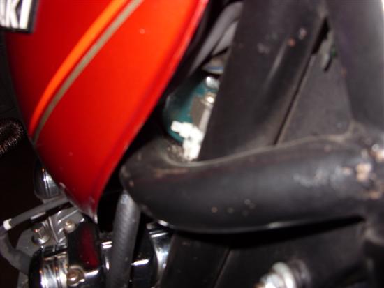

OK, so I got out there this morning and started doing some checking.
It's getting fuel.
I pulled a plug and checked it. No fire.
Checked it at the coils. No juice.
I wondered if the relay had gone out in my trusty WG Coil Mod mod again, No juice was coming out of it, but no juice was going into it, either.
Checked the fuse between the battery and the relay; it was blown. Replaced it, and it fired right up!
Got to wondering about why that fuse had blown. WG calls for a 10a fuse, but I hate to blow fuses, so I'd put in a 75a fuse, and it still blew it.
While I was looking around, I actually saw the cause. The Dyna Green coils are bigger than stock, and mounting them using the stock mounts leaves the tolerances kinda tight. When I'd installed the coils, I put thin rubber sleeves around the studs to make sure the contact on the coils didn't touch the studs, but I guess it worked loose and rubbed through it, as the coil was arcing on the stud. I wrapped the stud in tape, and moved the contact on the coil as far away from the stud as possible, then tightened it up. That'll hold it for now, but I'm gonna have to find a better way to mount those coils.
I'm also gonna have to start carrying extra fuses.
Still, I'm really relieved it was something so simple. It's a beautiful day, so I'm going to go get the tag sorted out on it, then go for a nice, long ride.

When mounting Dyna coils on 1976 KZ900-B1 LTD, may wrap the stock mounting spacers with small nylon tie straps which serve to insulate the spacers from the heads of the screws used to attach the coil leads to the primary terminals. (See following pic.)
Other insulation options would include tape, rubber, etc., or fitting non-conductive mounting spacers (such as plastic).
Then there's always the MacGyvr special coil remounting designs. :lol:
Such as suspended with a strip of baby diaper, or hung inside a old sock, or kept inside a tank bag.
Any of which should work just fine, the point being that the coil need not be grounded to function otherwise normally. Hanging suspended in mid-air would also be okay, but should include a leash so it won't float off. :lol:
