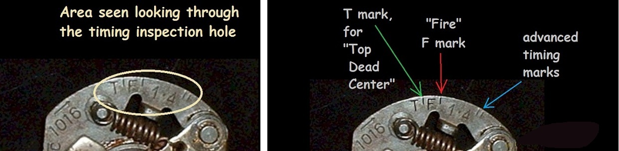

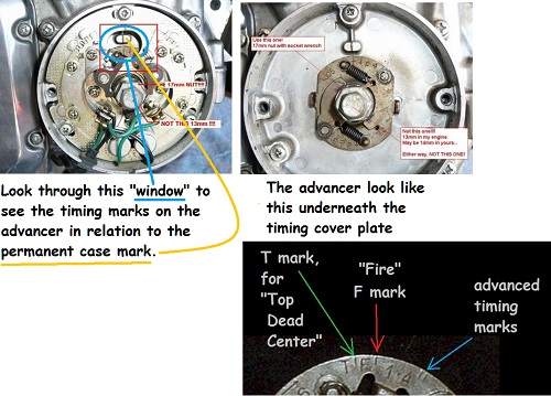

Do you have a timing light? Can you verify the timing on all 4 plugs? That is, from F mark to double line mark and back, and at the RPMs specified in the manual. To get marks on the 2-3 side, just draw a line from the 1-4 mark, through the center of the advancer, to the other side. You'll have to estimate a little bit.

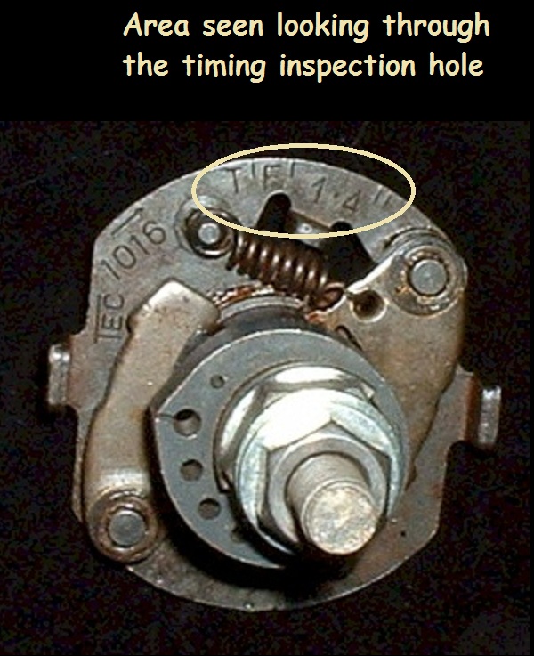

It sounds like a possibly frozen advancer. That will stop a motor from developing any power, but it may rev fully with no load. Have you tried moving the advancer by hand? It should easily move forward to a stop, then snap back... like a well oiled gun.

OK so i'm not exactly sure what should spin inside this thing, but nothing moves by hand... i've seen posts about the oblong lobe lobe spinning clockwise but the pictures always show it out of the bike, do i need to remove the unit in order to see if it spins?
OK i took the plate off and even the levers wont move and there is bits of rest kinda everywhere but not covering it, and what looks like corrosion? white substance inside it but not on anything else, the plate and mags are nice n clean n pretty, almost like they are newish... i hit it all pretty good with 3-3-6 and i'll see if anything else moves in the morning.
