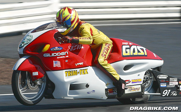

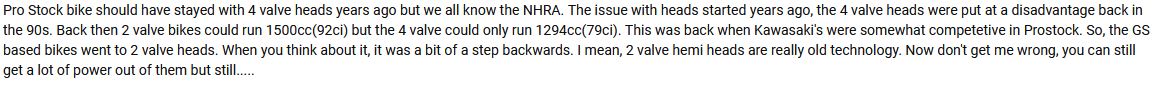

I think I may have answered my own question, not 100% sure but it was a comment on a Utube Video showing this bike :

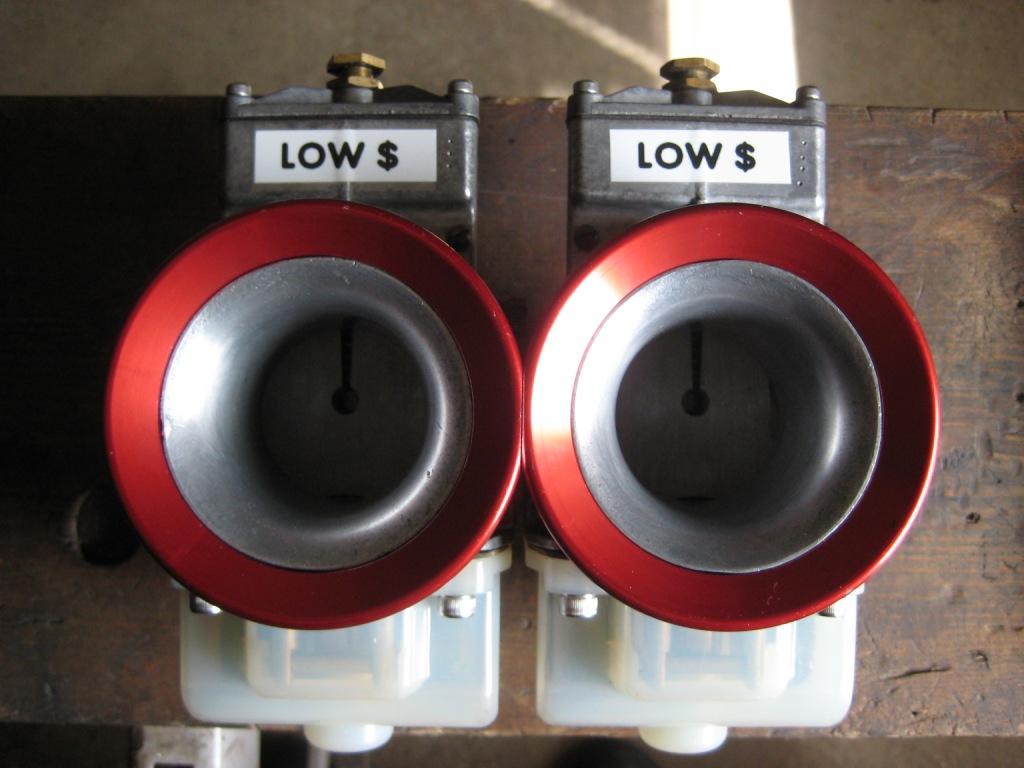

I am asking the motor size because I bought some Lectron Rods that were supposedly in this bike.
I don't know too much about the carbs I bought but they are 40mm, was looking used for 38's for over 4 years.
The 40's came with 2-1 rods, I was told that the engine would not run great with them.
The FBG rods are 2-0 said they would work better on my 1327cc motor and that they were out of the "Pro Stock" bike he ran in AMA Pro Star.

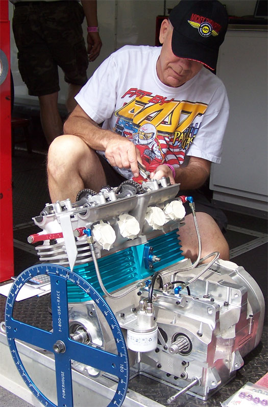

The Vortex heads came out just about that time so not sure if it was 2V 1500 or 4V 1300. Not sure if Paul would have jumped on 4V so quickly, seems like the kind of guy that would wait.
I am not sure how old this picture is but that looks like a 2V head :

29 Oct 2022 12:21Wow! That's the biggest timing protractor I've ever seenI think I may have answered my own question, not 100% sure but it was a comment on a Utube Video showing this bike :
