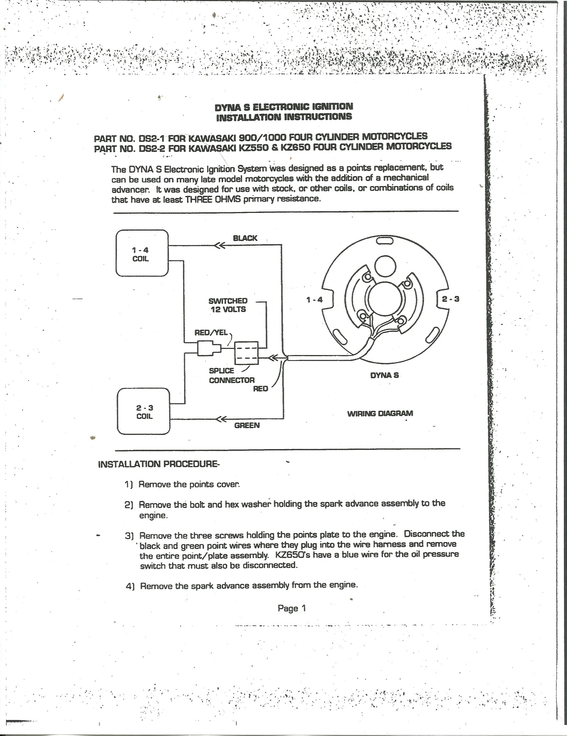

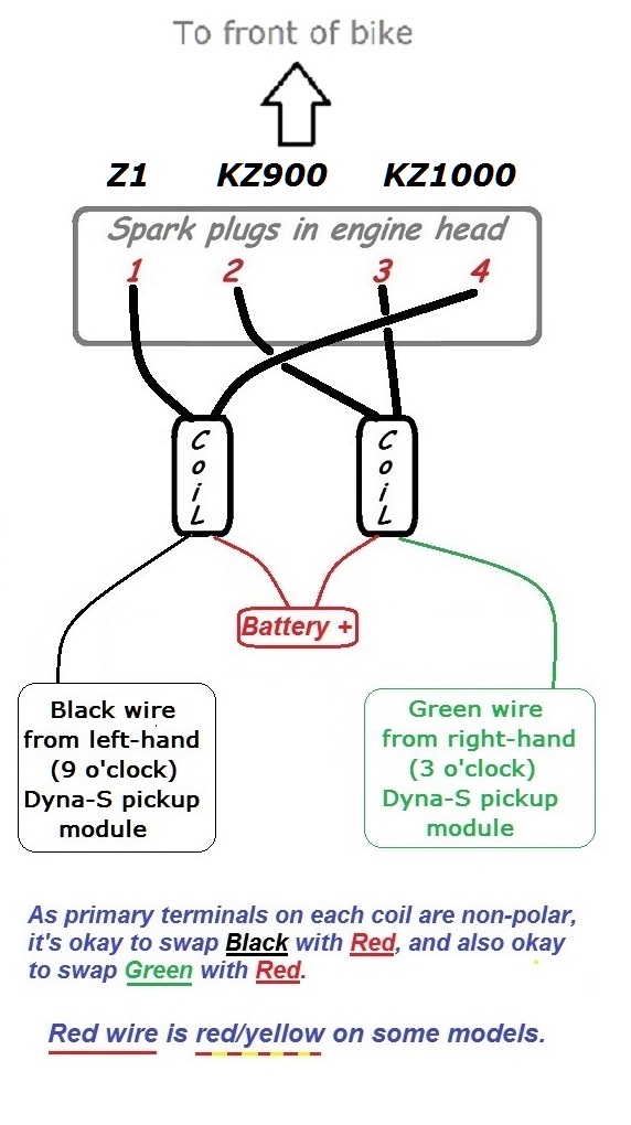

Ignition wiring for a total loss ignition without any charging system components should be relatively simple.
Is the Dyna-S complete with its red wire, green wire and black wire?
Which of the following ignition components are already fitted?
Two separate ignition coils;
Four spark plug wires;

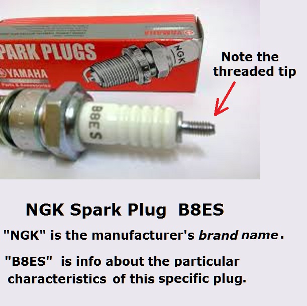

Four B8ES spark plugs;
Four caps to connect the plug wires to the spark plugs;
Battery;
Negative battery cable;
Red or red/yellow wire from battery positive to each coil?

To be honest I haven't taken a good look at it, and I am told it is a complete dyna s, I am very green when it comes to working on bikes...how will I know if the plus are B8ES? No battery...I will look and try to get pictures later today to help

10 Jul 2016 07:26For info about how to interpret the code letters and numbers on the spark plug,
click here > www.blasterforum.com/threads/how-to-read...rk-plug-codes.43775/

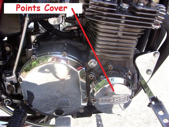

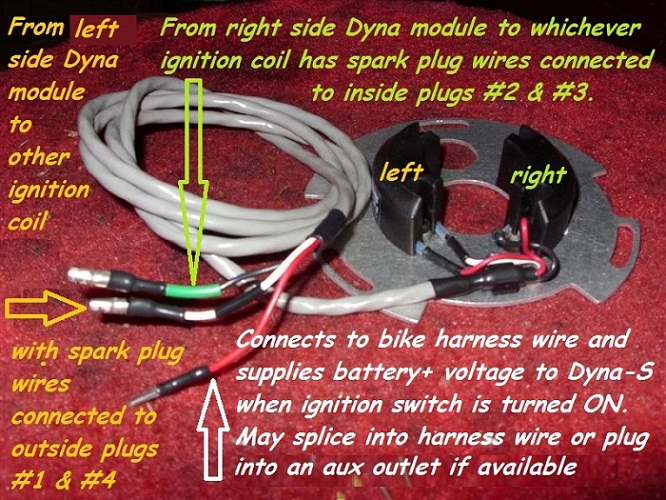

To see the Dyna-S, first remove the "points cover."

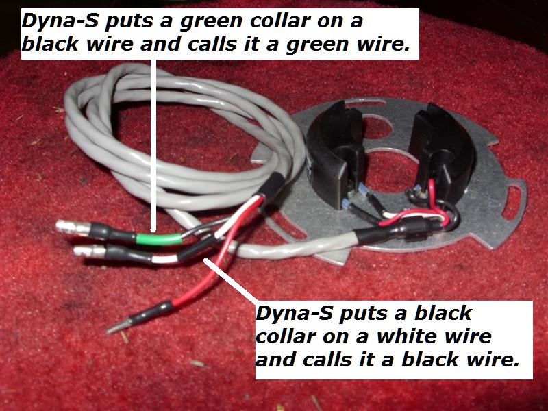

Here's what the Dyna-S looks like:
Note the three wires

B10ES are too cold.
