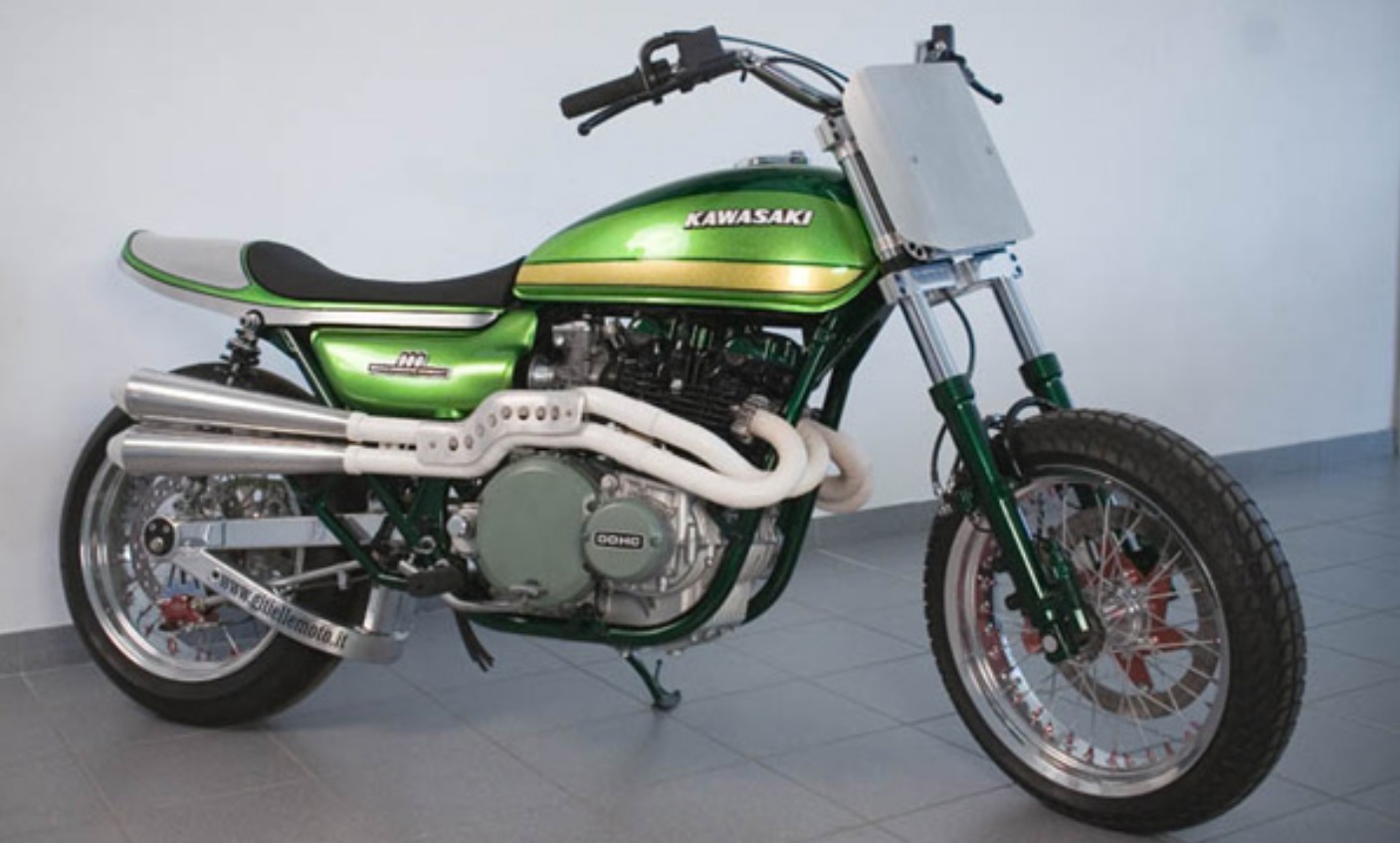

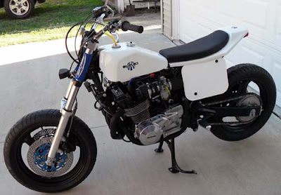

No reason you can't build a KZ550 flat tracker
street tracker style bike.

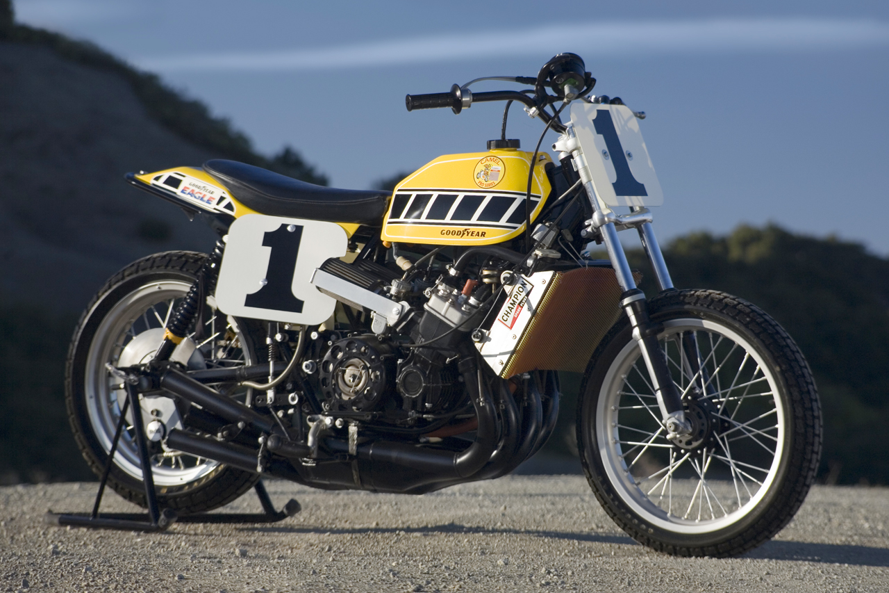

I also came across this not too long ago :woohoo:
OK, so it's not a Kawasaki... but you get the idea!

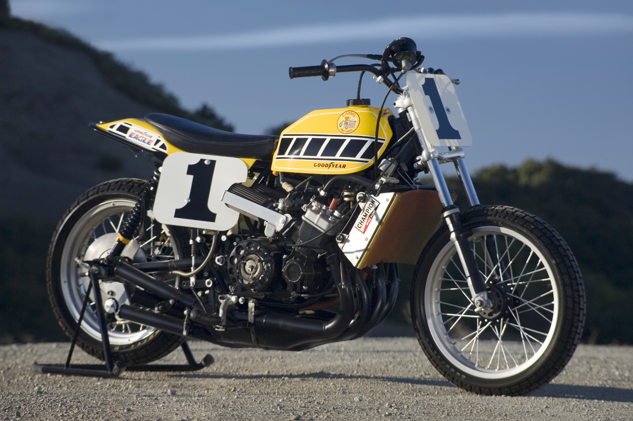

10 May 2014 19:55...Patton! What are trying to do, start a WAR? :blink:
...Well, at least it's not an Eddie Lawson Special. :whistle:
...oh my, did I just say the "E" word? :S
... :laugh:
