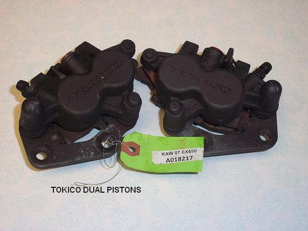

I had these 2 calipers on the e bay for 7 days. Only $14.99? No bids. I paid 3 times that a year ago for a project that fizzled out. They probally cost $3-4 hundred at the dealer.
Nothing some 1/4" aluminum plate can't hand fabricate up to use on most anything.
cgi.ebay.com/ws/eBayISAPI.dll?ViewItem&i...ageName=STRK:MESE:IT

He races in Spain and in most classes of european vintage racing, double piston (meaning side by side ) calipers like yours are not allowed. Same situation in Italy, that's why i use Brembos P08s
I know AHRMA in the USA allows 17" wheels and modern brakes on older racers but in europe things are different.

11 Jan 2013 23:21Ill give ya $50 for the pairz1kzonly wrote: I had these 2 calipers on the e bay for 7 days. Only $14.99? No bids. I paid 3 times that a year ago for a project that fizzled out. They probally cost $3-4 hundred at the dealer.

12 Jan 2013 18:13Thank You Wireman! We have a deal!wireman wrote:Ill give ya $50 for the pairz1kzonly wrote: I had these 2 calipers on the e bay for 7 days. Only $14.99? No bids. I paid 3 times that a year ago for a project that fizzled out. They probally cost $3-4 hundred at the dealer.
I'll type to ya soon.
Marty

Like wrote Turboguzzi those Tokico aren´t allowed but I'm not entirely sure. Anyway they are for sure a big improvement for the originals
