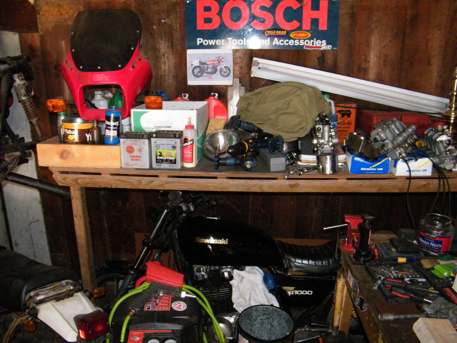

what is most entertaining and telling for me....what is old is new again..hats off to the other land masses...but we seem to have the original deal here...a ray of light shined on KZR.....the old is new again.....good bikes but our friend seems to have good gene pool too....those other riders may have had better backing on those old time sheets...but it seems the true legend is the one who goes and goes and goes
notice the overall set up and stance as this beuaty changes and chases the times....simple bike and intense engineering leading to a U.S.A version of a go fast Z...rules dictate flow to a degree..small at that....but this bike...from even early shots....Z usa
the basic lines of the greatest series of bikes ever produced to date...change little...blurr your eyelids and the bikes lines and curves are still in the same places..one gets weekend glory and one can win daytona.....the wheel here...the tubing bent as such...the rider picks the adjustments and throw and pulls....and off you go to do what these bikes have did on every land mass.....walk away.....
i see many more stories here....to me as a KZ Rider for 3 decades.....this deserves more than a welcome...but the seat at the head of the table,.,,,pics...scan em...stories...tell em....lies....you wont need any...your bike and creds are as good as any i have ever seen on this site and i await a chance to learn and absorb more history....know that all you share will be in the books for good now
thank you a lot
Craig....3 miles from the corkscrew...and a place to tune it and camp...tri tip and tacos...GP
thank you a lot
