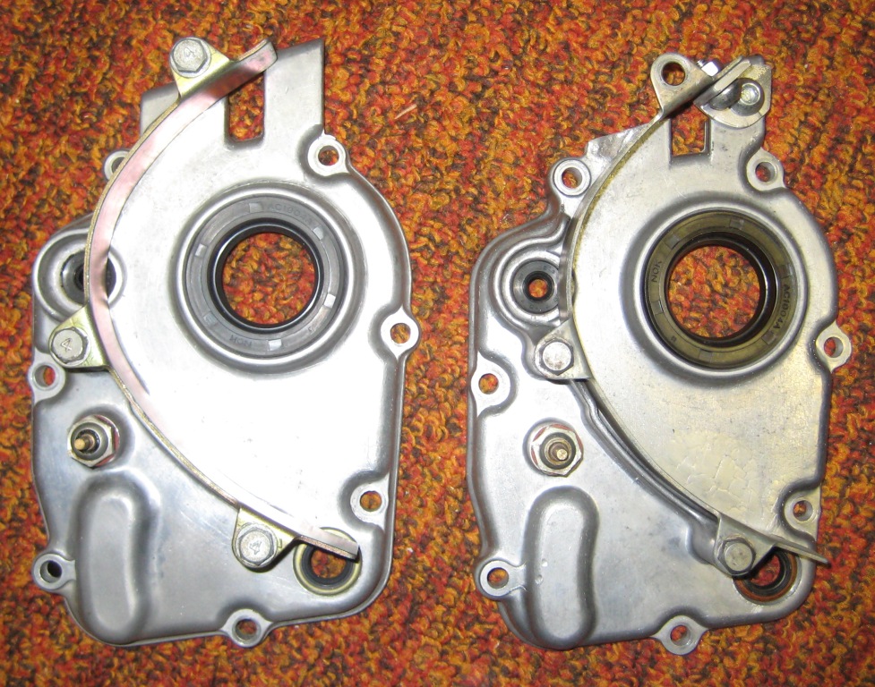

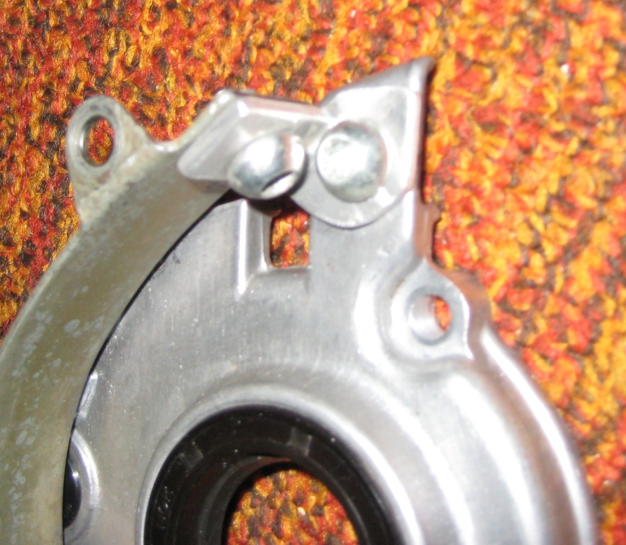

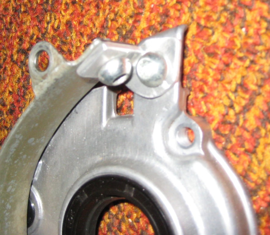

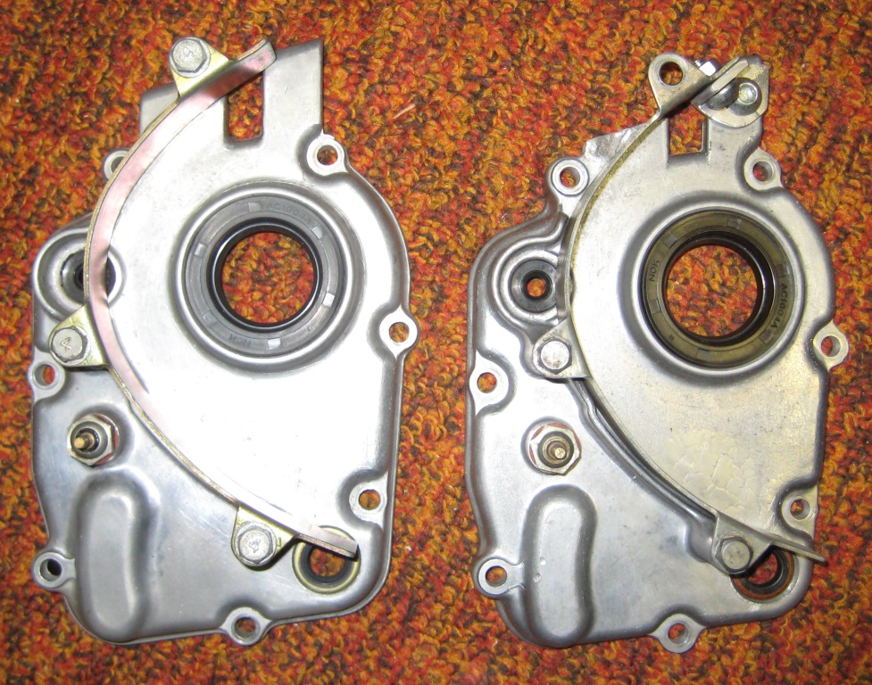

02 Dec 2025 13:34 - 02 Dec 2025 13:37That front sprocket chain guard is the same part number as all KZ/GPZ550's and all KZ650's.My mission cover appears ok but it is missing the chain guard and top tab to hold it on. (Which appears to be a common failure on these engines if the chain breaks.
Its common to find the top mount tab on the mission cover broken off from a chain break on 650/750 engines. Its easily fixed with a simple bent bracket that no one will see, you drill a bolt hole on the tab next to it as shown below.

Thanks for posting. The photos help too. I restored a KZ650C 2 years ago and it had the same issue. (Yes same part #) All the parts were there so I had it welded. When I do restorations I try hard to keep everything original. If I can find a good used (affordable) one, I will do that before a bracket repair but the repair you show is certainly in the cards. 👍
