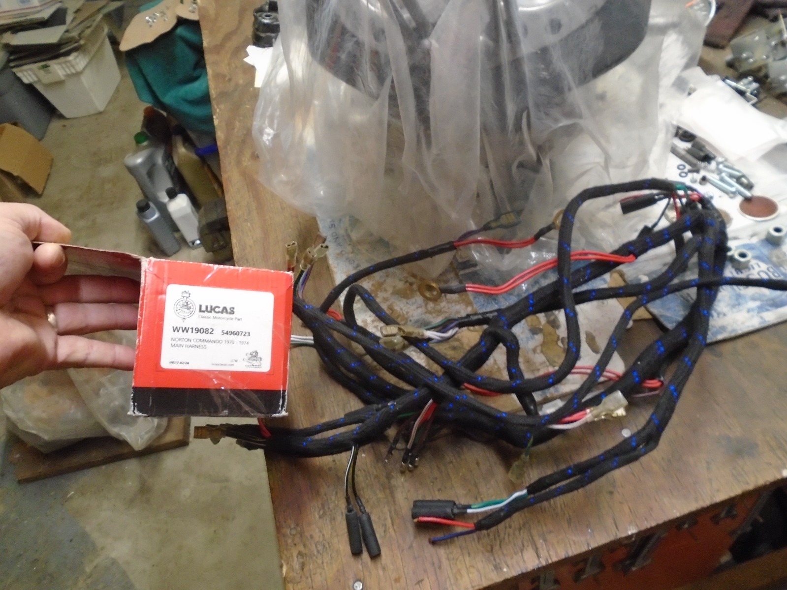

Grumpy, I know you're sending your harness, or are planning to shortly. Here's a New Norton Main harness, wish Kawasaki offered such easy access for replacements. This is the braided version but also had the PVC variation. Vinsky might get a kick out the view of LUCAS boxed stuff!!

02 Sep 2025 04:22I hope the box is "flame retardant" LolGrumpy, I know you're sending your harness, or are planning to shortly. Here's a New Norton Main harness, wish Kawasaki offered such easy access for replacements. This is the braided version but also had the PVC variation. Vinsky might get a kick out the view of LUCAS boxed stuff!!
