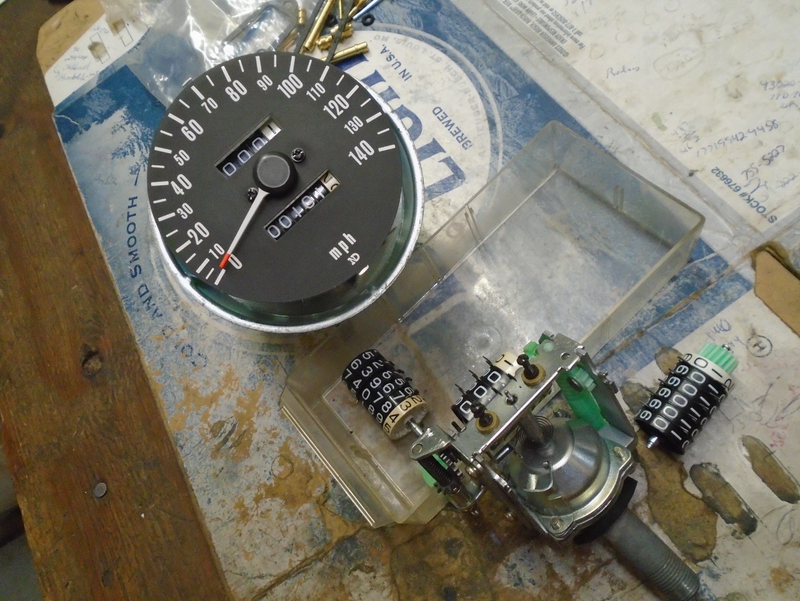

Noteworthy Rich. Don't become too enamored, now that you said someone had already opened it, with your new found gift. Check for function first and a wild swing needle, should sweep with a bit of damping. NOT just flop side to side with a "TING". If someone fudged-up the mechanism, let me know. Run an old length of square tach cable in your drill in reverse, CCW, and watch the action. If needed i have spares of the 140mph (US) versions here if needed. You were only wanting the faceplate anyway.

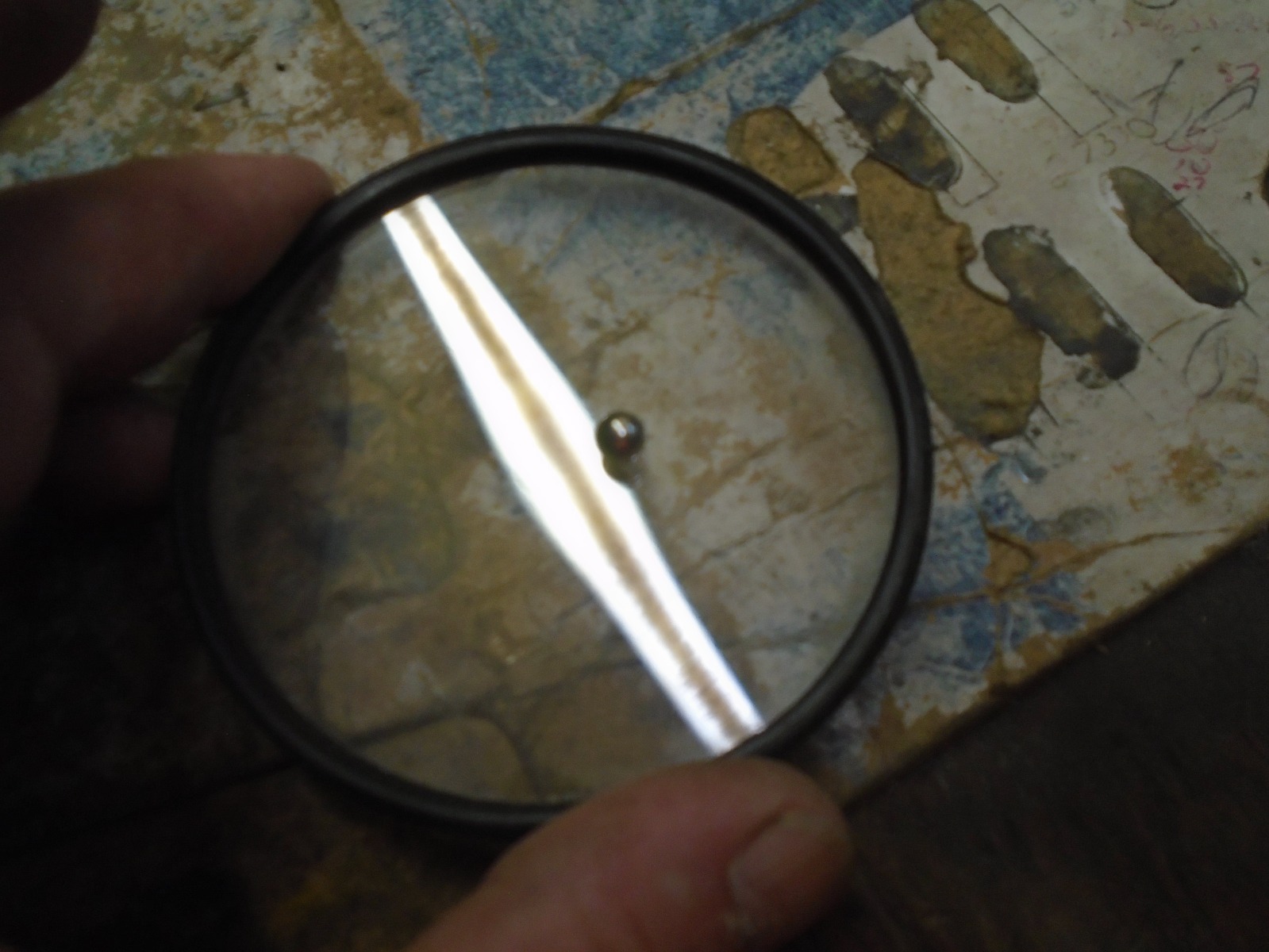

Went to digging, knocking off bird feathers, dead bug carcasses and dust but found the needed plate glass. More dust them anything, ha. Easy to decern flat from convex, just drop a ball bearing in the center and swirl, comes right back to center. Anything else??

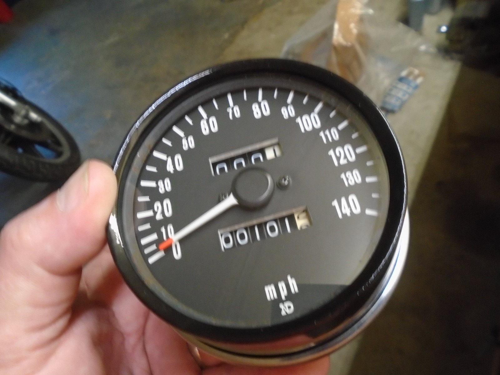

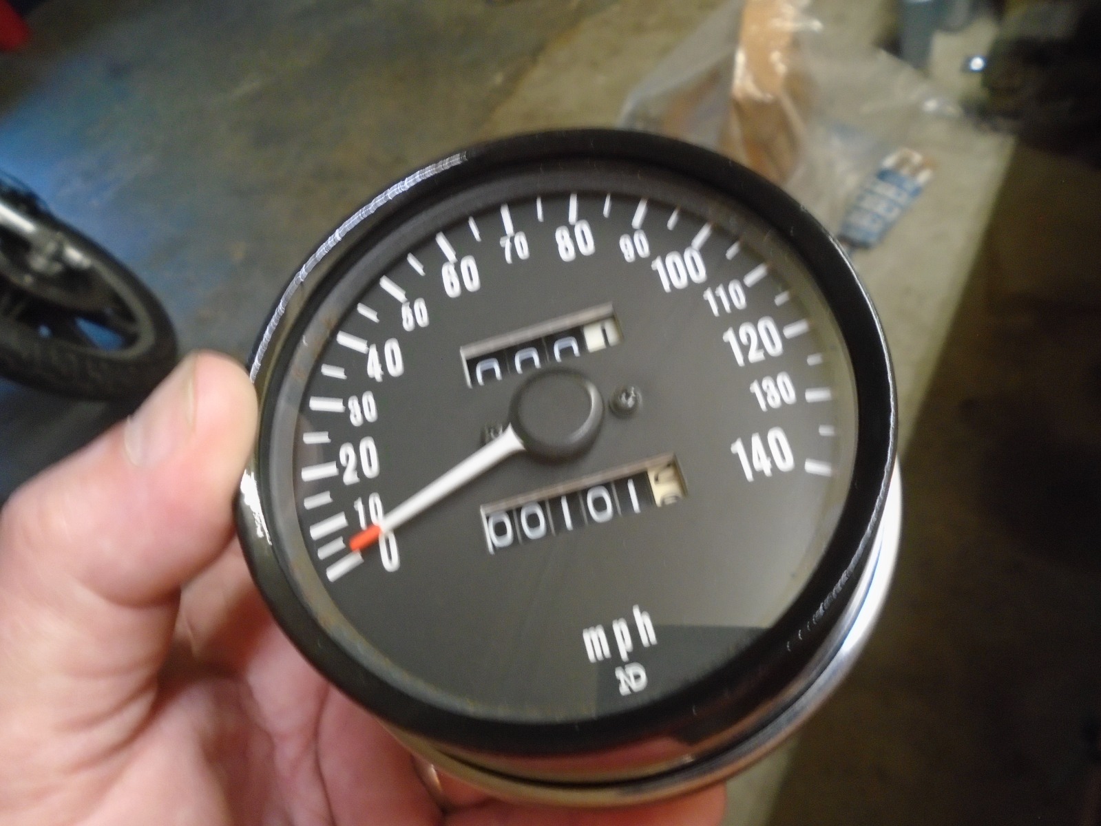

Cleaned-up the glass and installed a better rubber, suitable for showing-off. Remarkable as often not, glass has not suffered from Any knicks/gouges or scuffing as i frequently see! A real gem example of a unique item. Loosely attached to a 140/220 gauge so you see it in its splendor. As mentioned, the drives are ALL the same it's just the faceplate that differs them.

Awesome news for the glass👍
