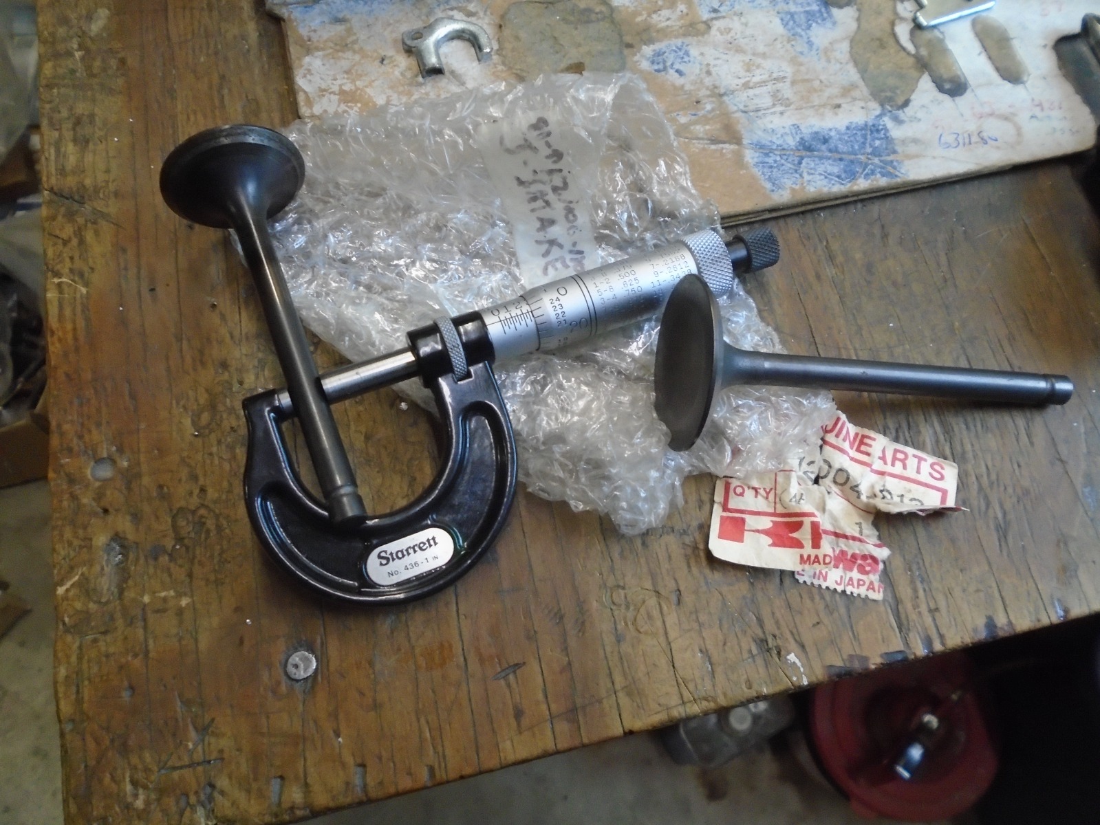

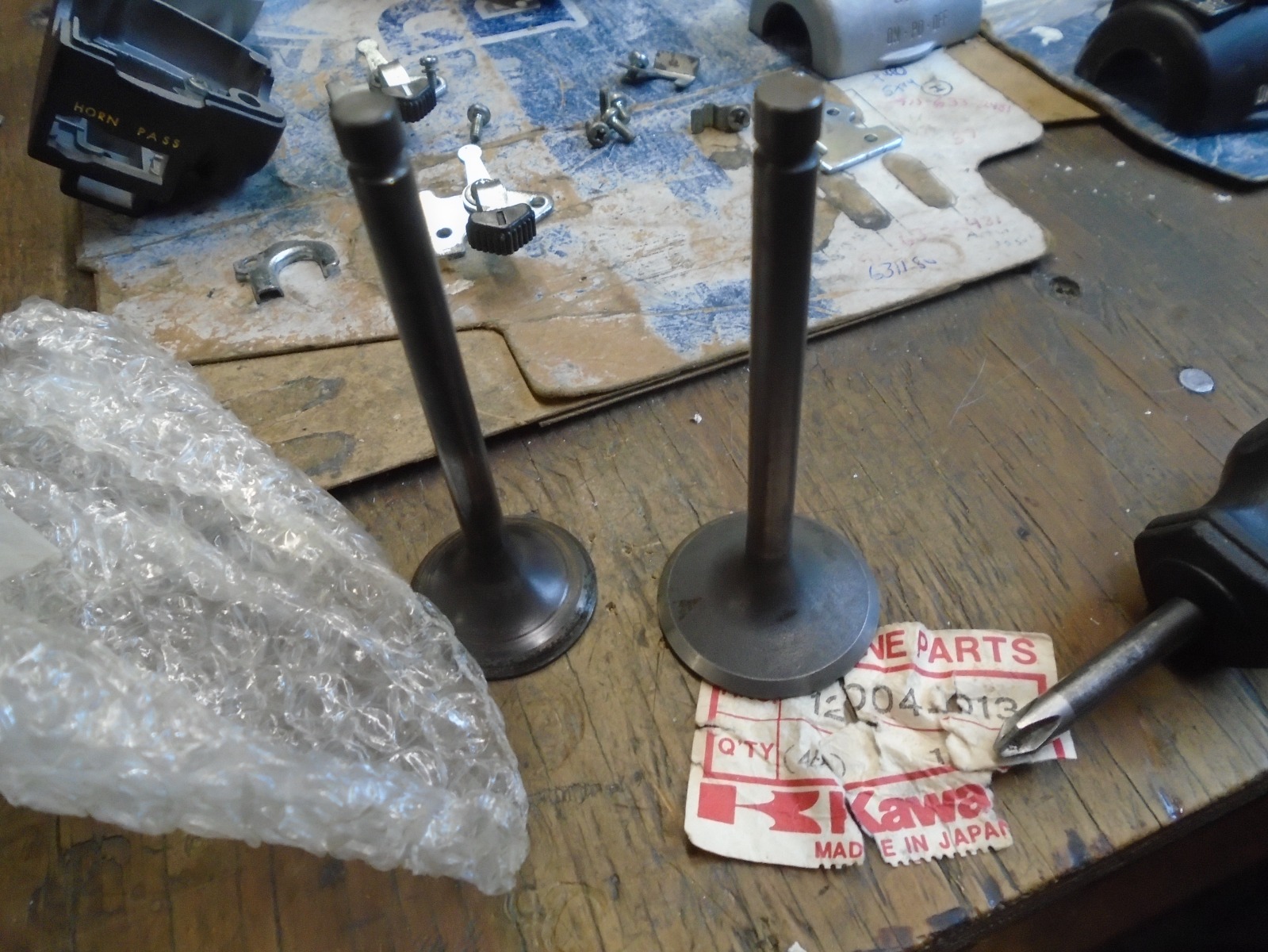

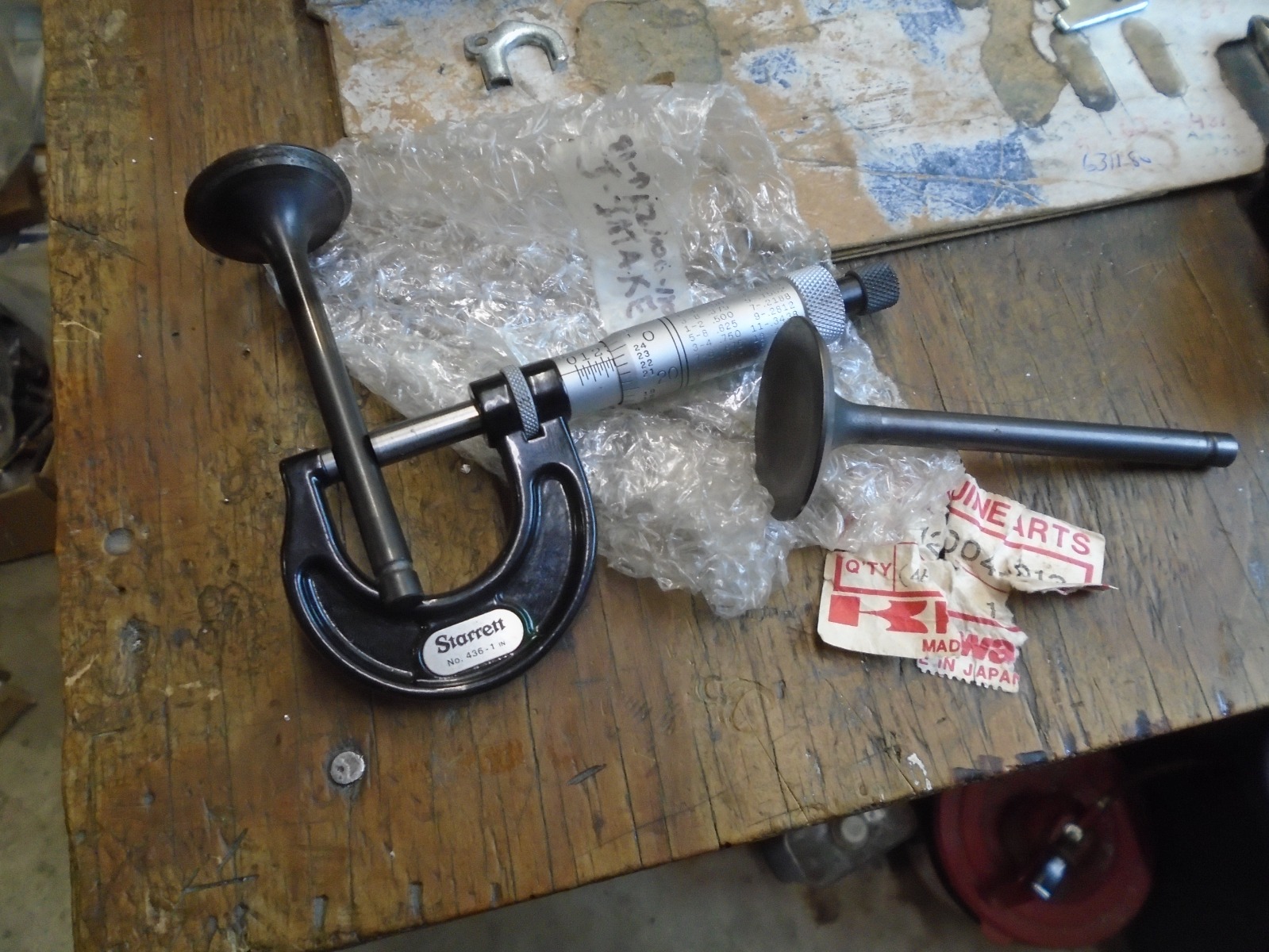

Why just have one when You can have two! The intake is NOS, other Exhaust    also OEM but used and checked for consistent stem thickness and "should" be straight. Have a baggie of good "round" keepers you want to slice a bit of the tops off but just pedestrian and not pictured.

Kawasaki part numbers are Intake 12004-1013, Exhaust 12005-1011. And never faced exhaust valve with minimal wear and good margin on tulip.

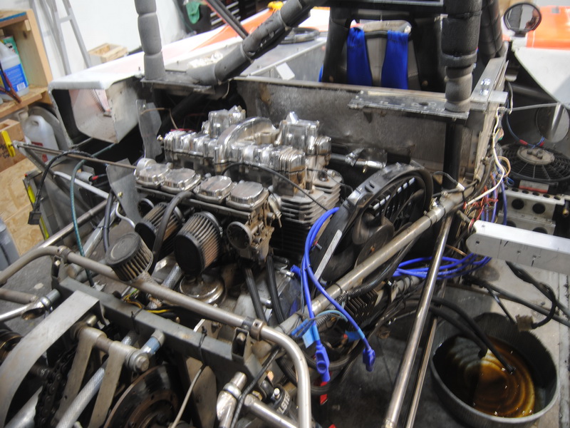

Being in a car the cylinder head is quite easy to get to, on the other hand the clutch cover is about 1/2' from a frame tube so the motor has to come out and assembling the exhaust is like a jigsaw puzzle.  Currently working on a new longer throttle cable.  Nobody wants to make custom lengths anymore and Motion Pro is about 6 months out.  So I'm using a stock KZ one as I need the 90 degree bend and then adapting to a special made straight one about 30" long that I can have made.  Of course special mounting required to keep it as straight and friction free as possible.
