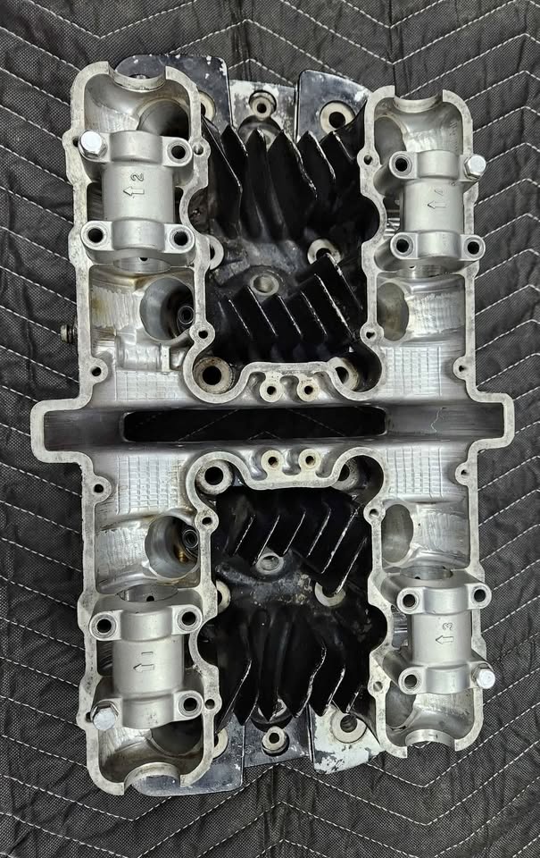

Re: Kz 1000 cylinder head
03 Feb 2025 15:19
There is a complete early KZ1000 head at the KZMarket on FB. $100.
www.facebook.com/groups/624151011024459/..._activity&ref=notif#

For a head with original matched caps, no broken,or lost fins, no more than maximum very small cracks in the plug threads to seats, is it an very, very fair offer for 100 bucks.
