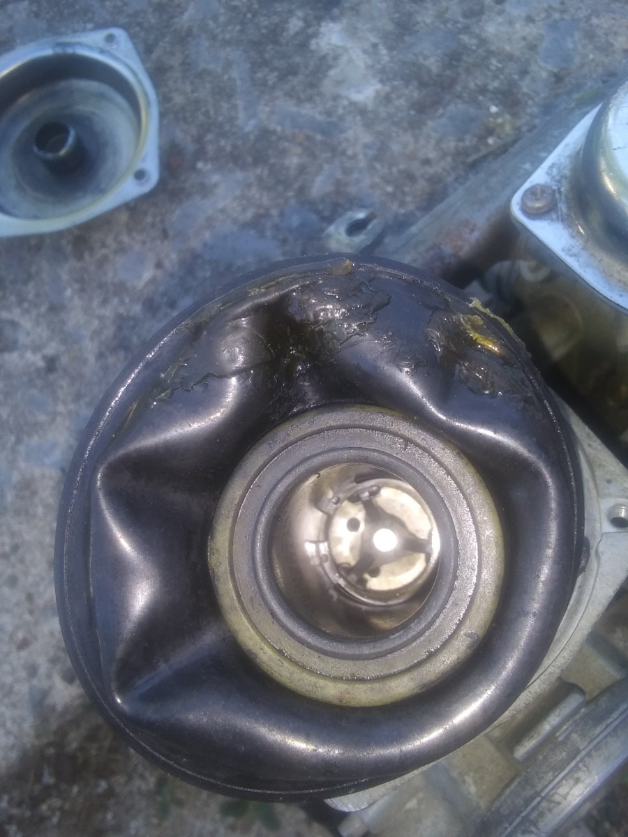

I don't really know if they are totally shot, been going on what a buddy has told me. But for other reasons I'm thinking he's talkin out his butt.
Could not get it to idle below 1800 rpm. The idle adjustment screws had no effect what so ever. Was told the diaphragms were messed up and holding the "needles" open. Found that to be true, they were full of holes and patched with what I think was rubber cement. Cleaned that up and re-patched them with electrical tape, just to see if I could make it work till I could get new ones. It hasn't ran since and he said the "idle fuel supply" was blocked and would be easier to replace.

I am not sure what he means by the idle fuel supply, but if the bike sat unriddennfor a long time, it is quite likely that the low speed circuit is clogged with dried fuel. A careful cleaning will solve that. I do not see a spring in the picture. If the coil spring that sits on top of the diaphragm is missing, the slide may well stay up when the engine runs.
Bottom line is that the carbs may just need a full on cleaning, some new gaskets and o-rings, replacing the diaphragms and any missing parts, and adjusting. The diaphragms are pricy, but there is no guarantee that another set of used carbs will be any better than what you have.
Maybe you could carefully disassemble them, take some good pictures as you do, and let the folks here help you assess what you have.

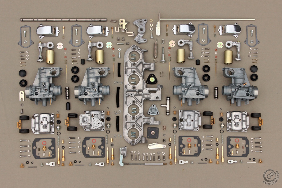

15 Mar 2021 22:15
The following user(s) said Thank You: Mr. E

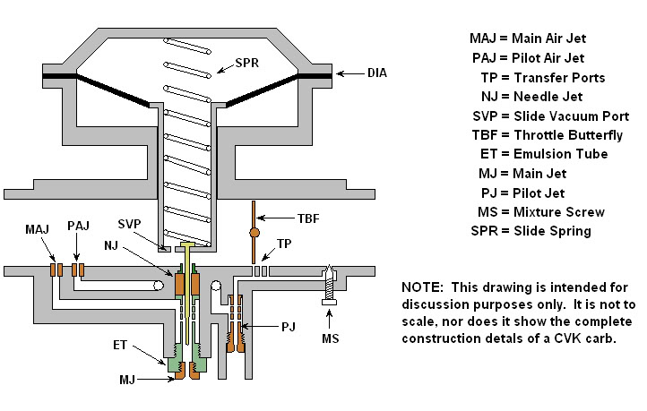

Although this is a different model carb, it will give you a basic idea of what is supposed to go on in there. Notice on the right side of the carb, you will see the pilot jet, mixture screw and some small passages. They control the idle and low speed mixture. They are tiny and are easily clogged.
The following user(s) said Thank You: Stumpy4u

- Mr. E
- Posts: 106
- Thanks: 32
Re: Looking for carbs
17 Mar 2021 13:43
Cool breakout. Haven't seen that one
1977 kz1000 - the Rooster, 1981 KZ750 Chopper, 1975 KZ400 , 1984 GPZ750
- Posts: 8148
- Thanks: 2645
17 Mar 2021 18:14I stole it from Gazzz.Cool breakout. Haven't seen that one
