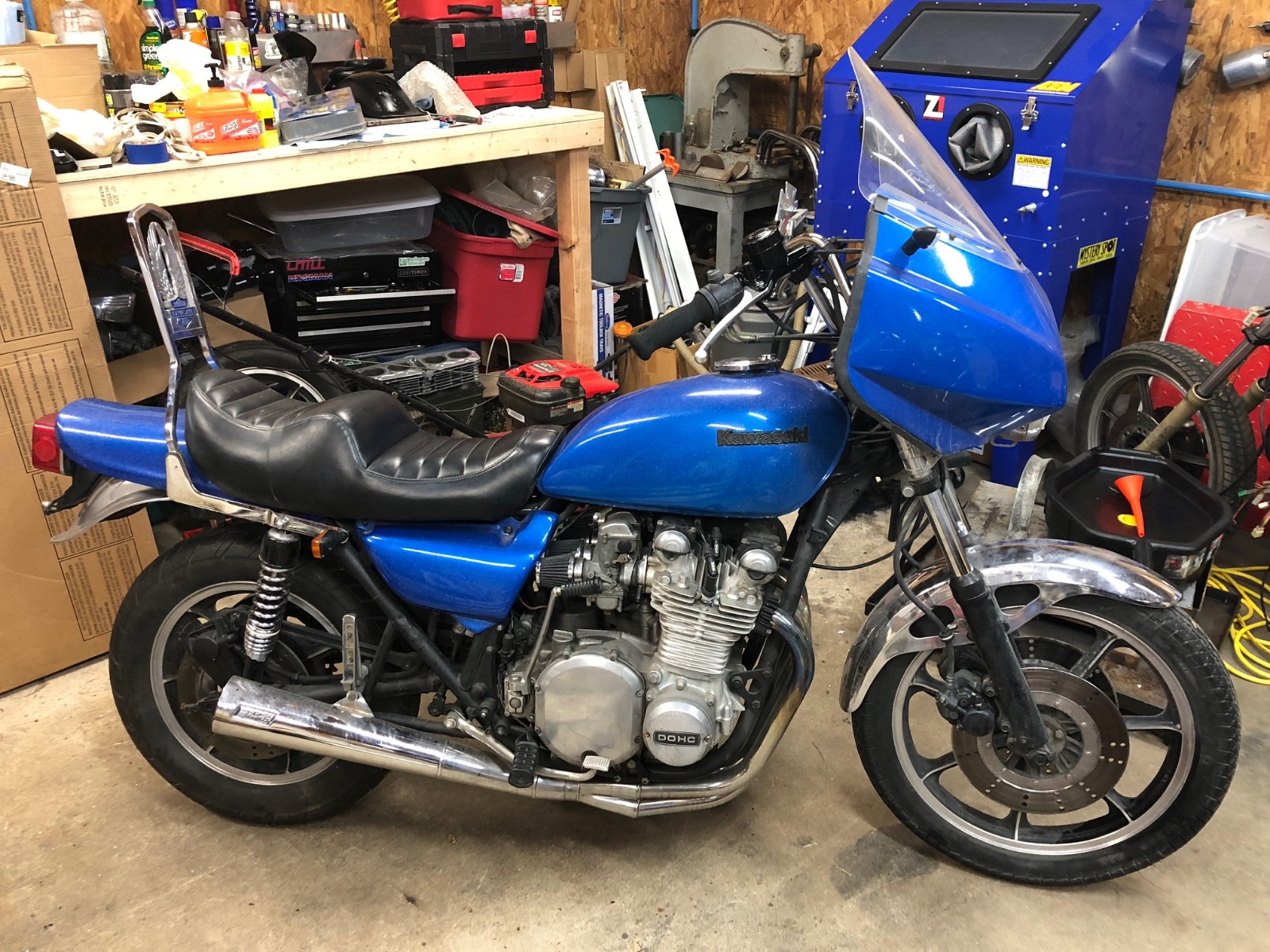

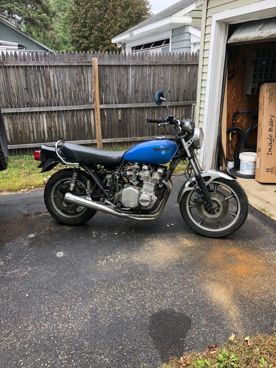

evryone loves pics, here is the bike when I brought it home, and so far "fixing it"

It's a nice looking bike but visibly very little of it is from a Z1, including the entire front end, shocks, carbs, wheels, rear brake, right control switch, air intake, valve cover, etc etc. You may want to just enjoy riding it as it is, particularly if it's reliable as it is. There is a great book on Z1's by John Brookes...I recommend it if you want to learn about them.

Thank you for saving it from whomever did that to it.

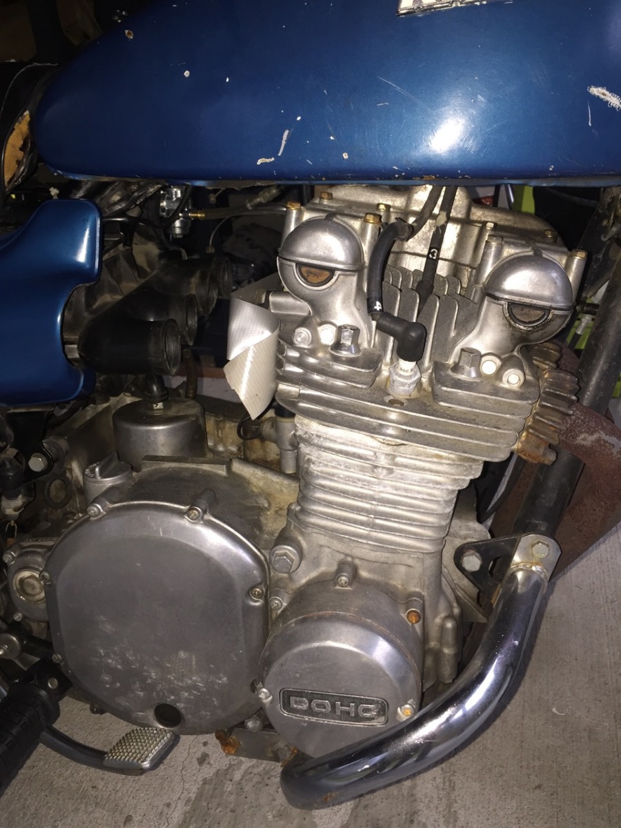

valve cover looks z1 to me

This blue one is a Z1 valve cover from engine S/N 554xx. (Close to this frame S/N) Note there are no semi circles on the end.
The candy apple red one is from S/N 72000 (approx). Again, no semi circle on the cover. I think they started that in '77.
Because of the rather large amount of non-Z1 parts on the bike I thought perhaps the engine isn't Z1...hence my question.
