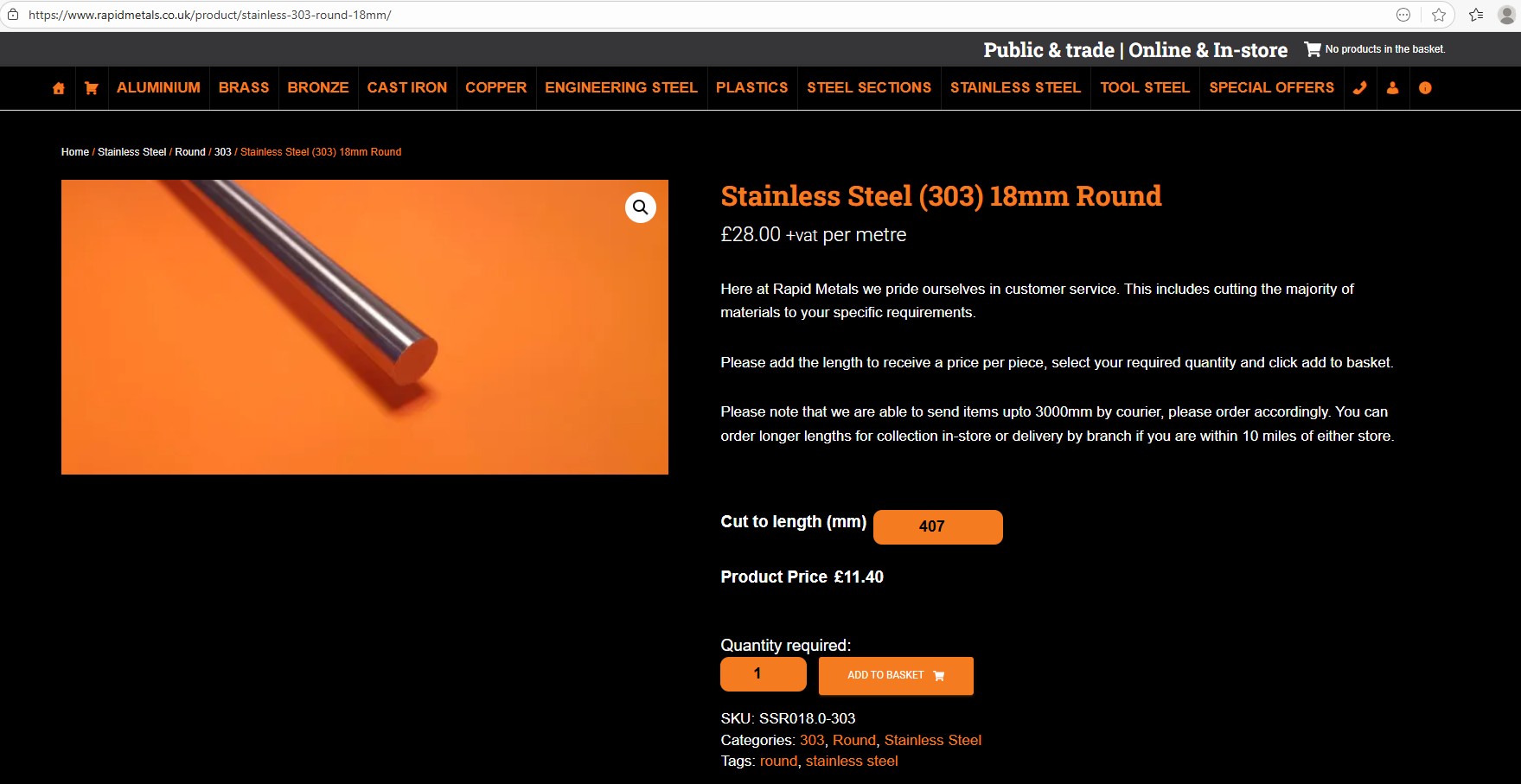

26 Jan 2026 09:02Stusco as you are in the UK Rapid Metals can supply 18mm 303 stainless (the length you need is £11.40 + VAT and postage so probably around £20 all in) you may need to get it shaved if your bushings are slightly under 18mmId have one but mine is 18mm

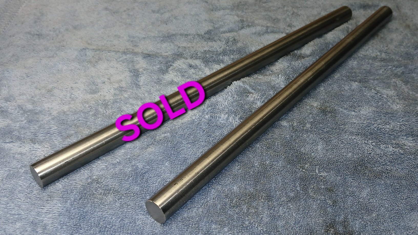

26 Jan 2026 09:38Please follow Wookie58's recommendation...Id have one but mine is 18mm
I currently ship to confirmed addresses in the USA only.
1982 KZ1100-A2/1170 sleeper 😀
- daveo
- Posts: 3188
- Thanks: 906
Re: Crankshaft Indexing Rod
26 Jan 2026 09:48PM sent...If still available, I'll take one. Switch to private messages and we can set up payment.
Until further notice, one 17mm rod is available.

The 17mm indexing rods are
SOLD
Thanks for looking...

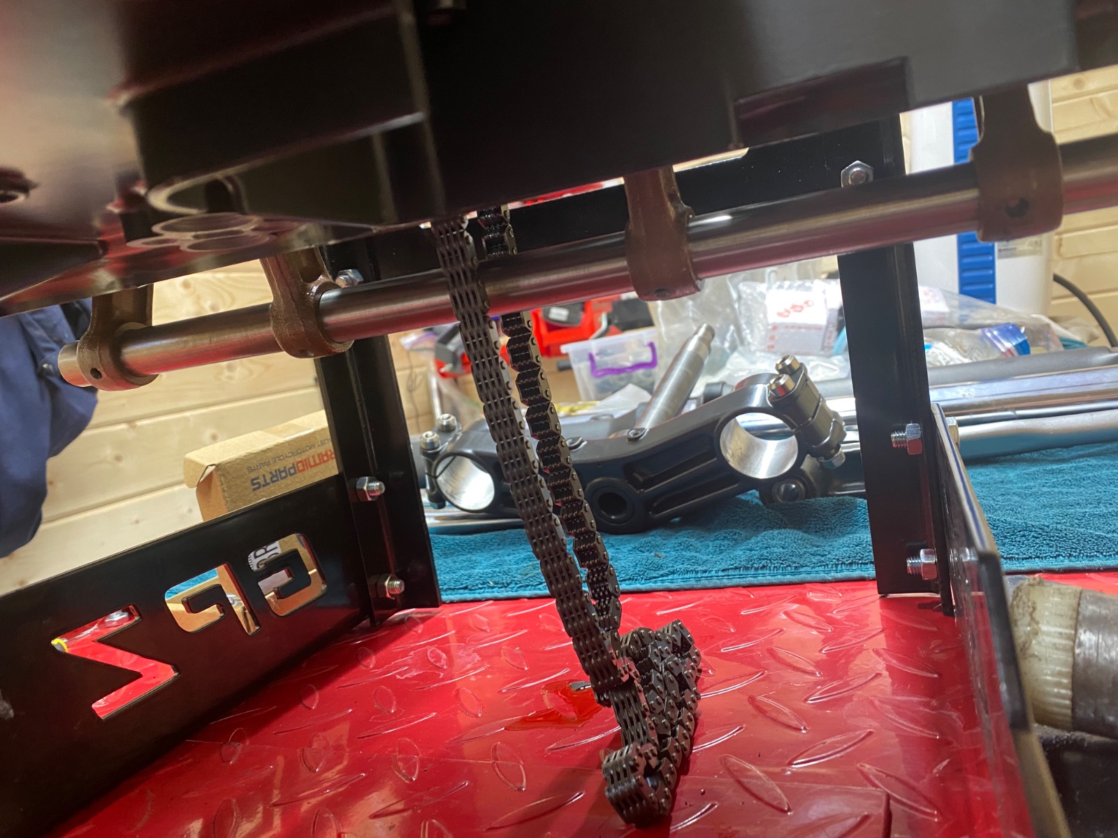

Got mine today. Used it now im happy to button up the bottom end after getting my crank rebuilt and welded

I bought from rapid its 18mm didn’t need turned down.
just checked they don’t have 17mm
