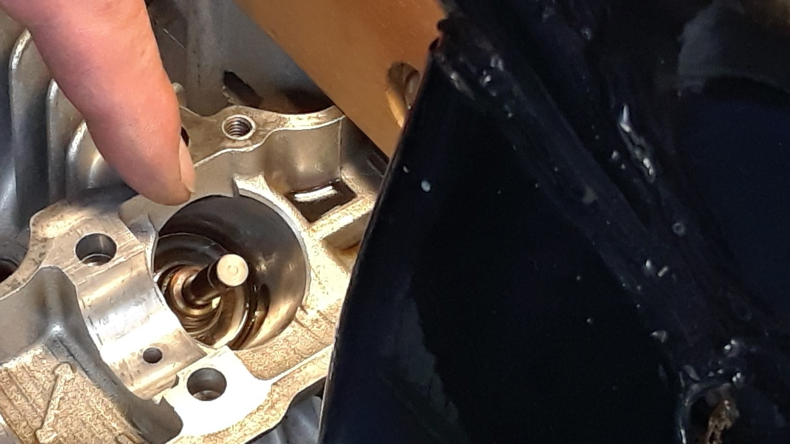

Might be getting ahead of myself, but this is exactly where I am with the tool that permitted me to find the valve guide issue in the video below:

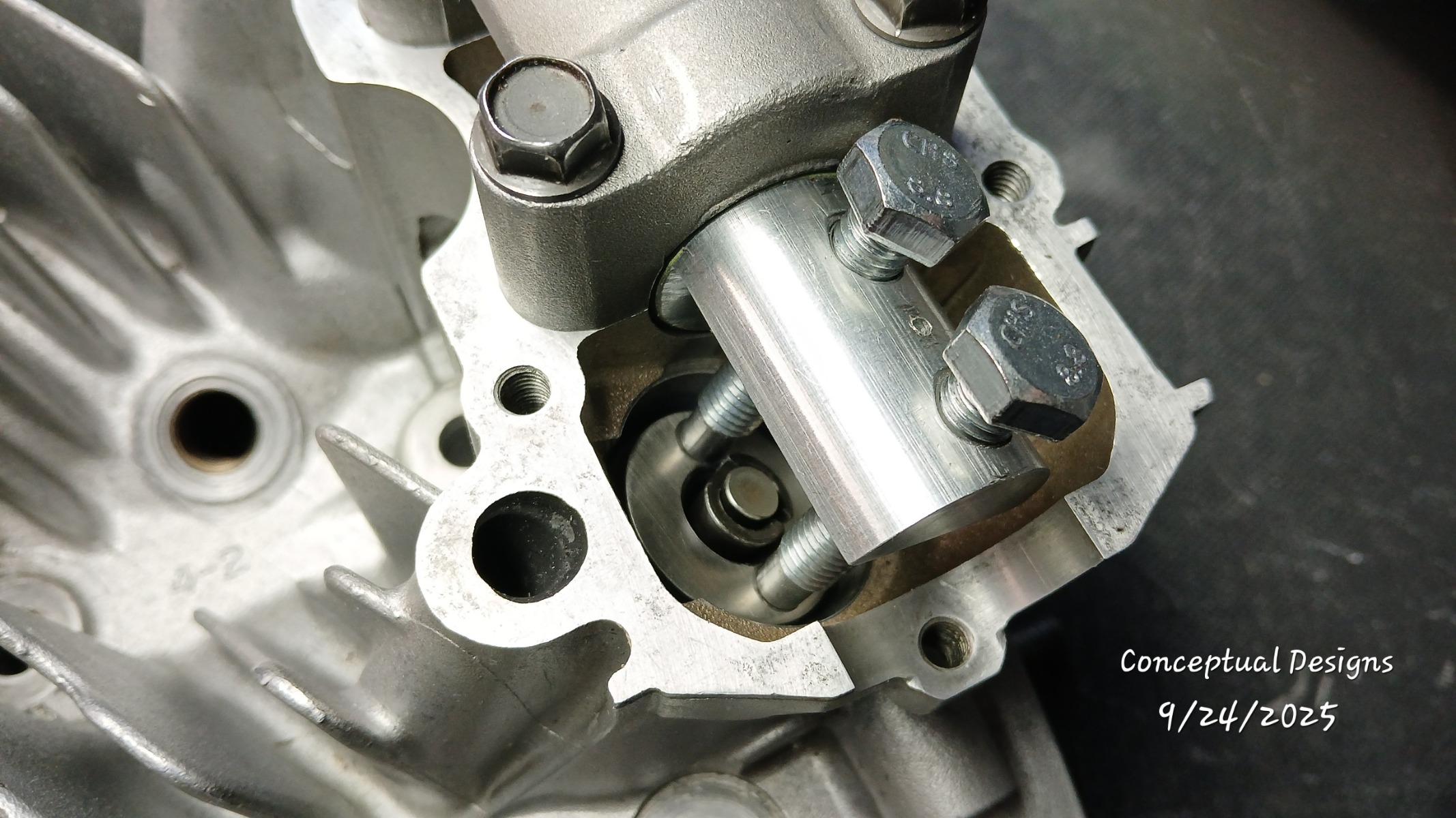

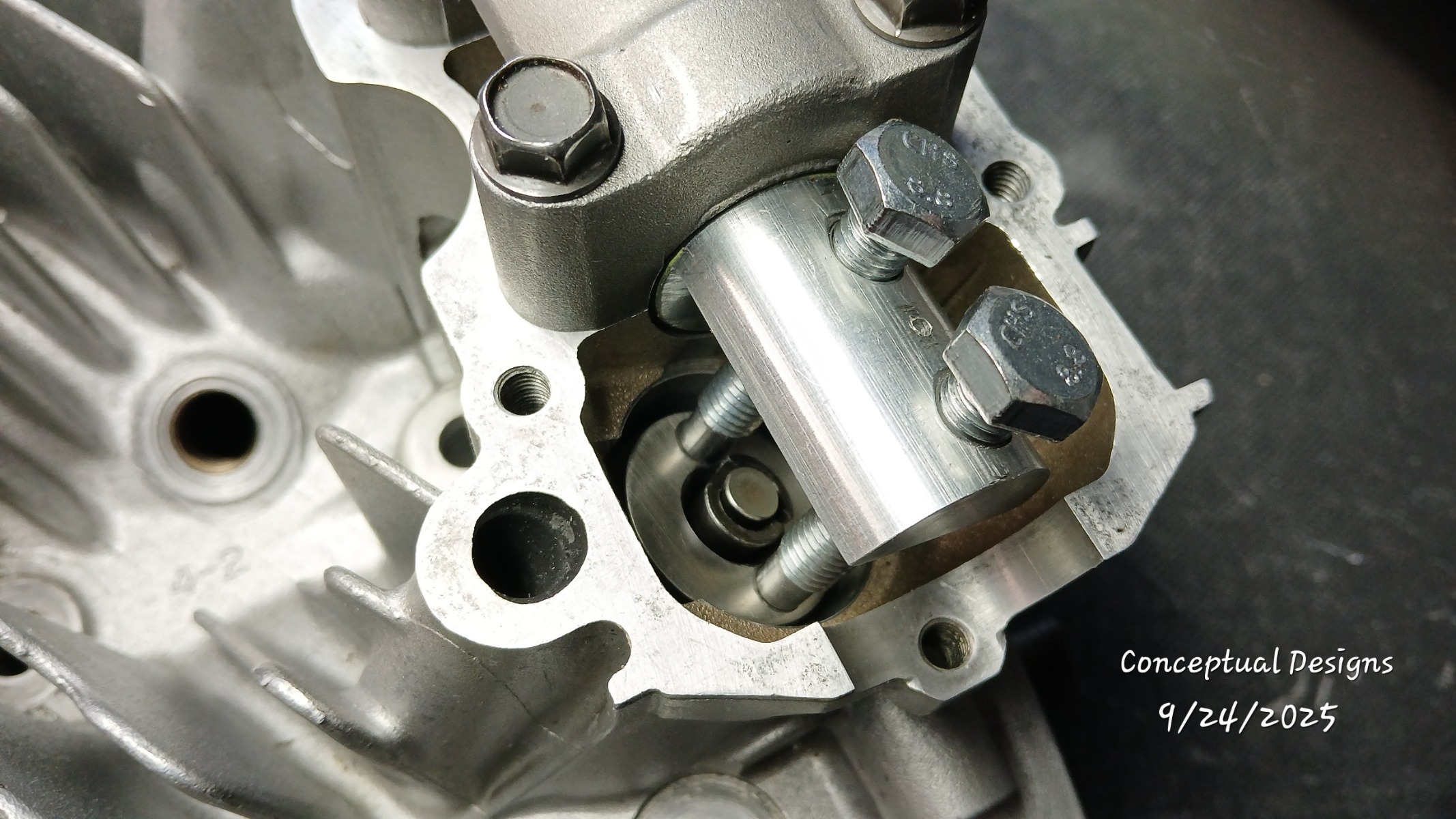

This tool facilitates valve spring and seal access while the engine remains assembled in the frame with the camshafts removed.
Designed for a KZ1100 J-motor, it should likewise work on others with a similar valve train configuration.

Re: Marketing A Tool
24 Jun 2026 02:12

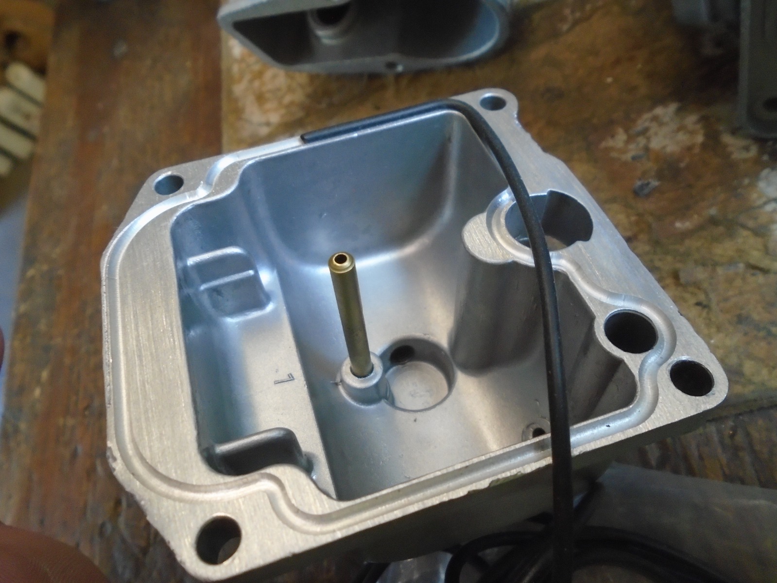

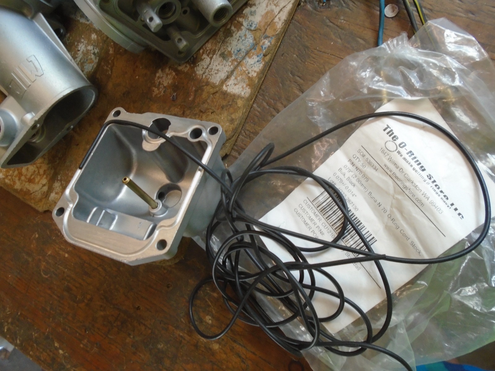

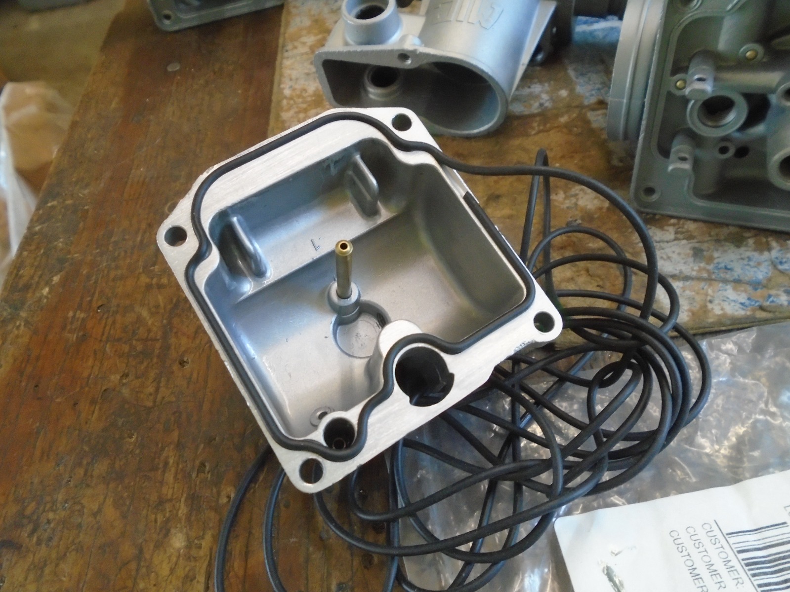

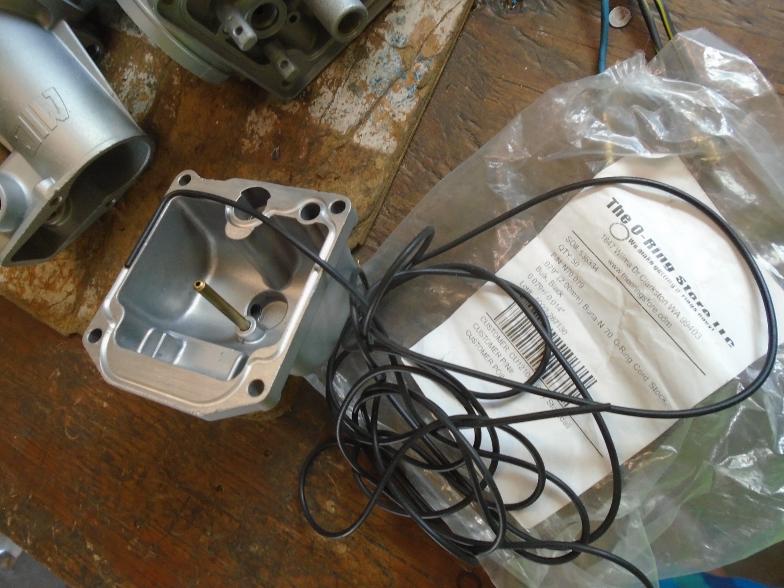

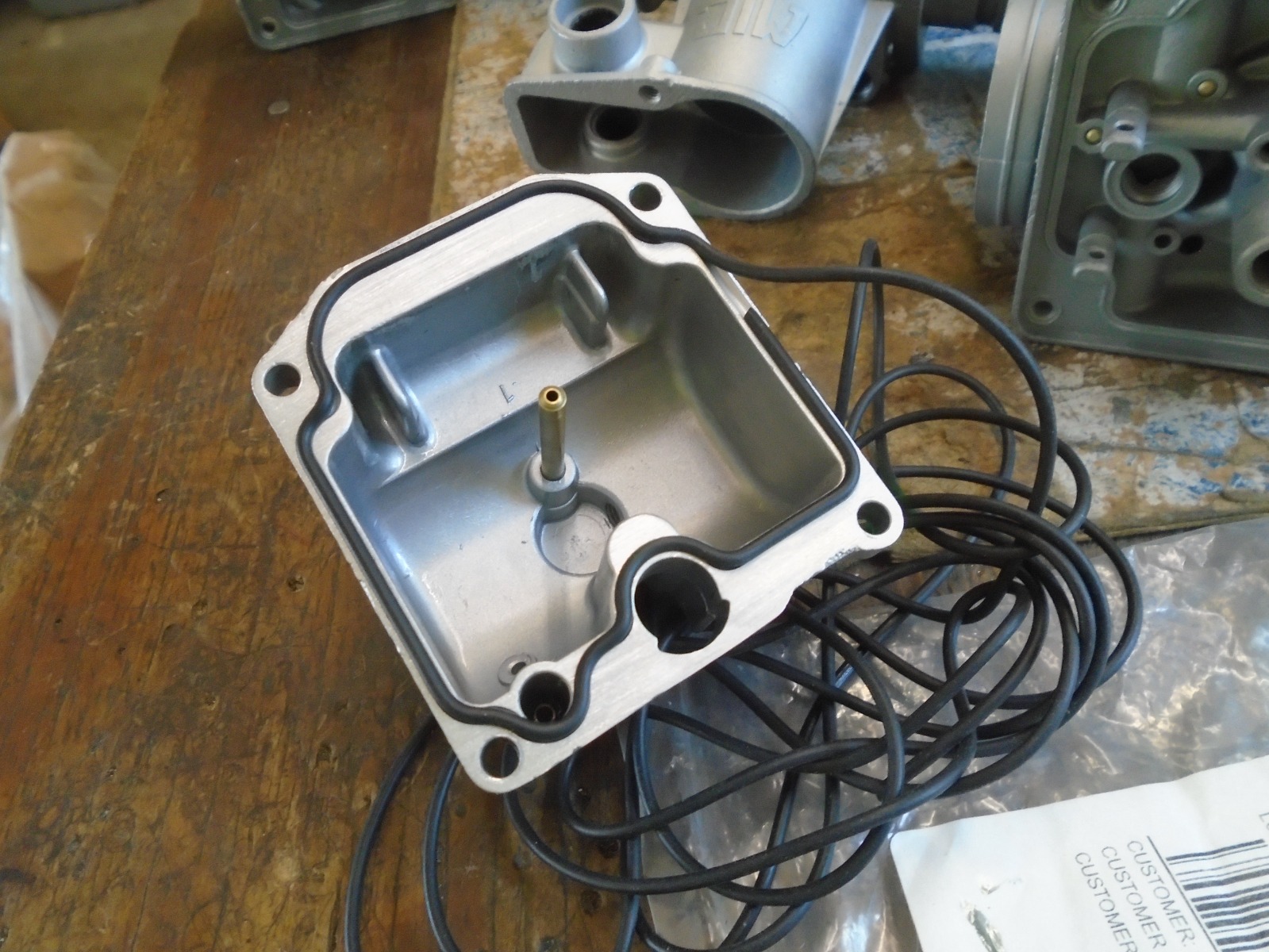

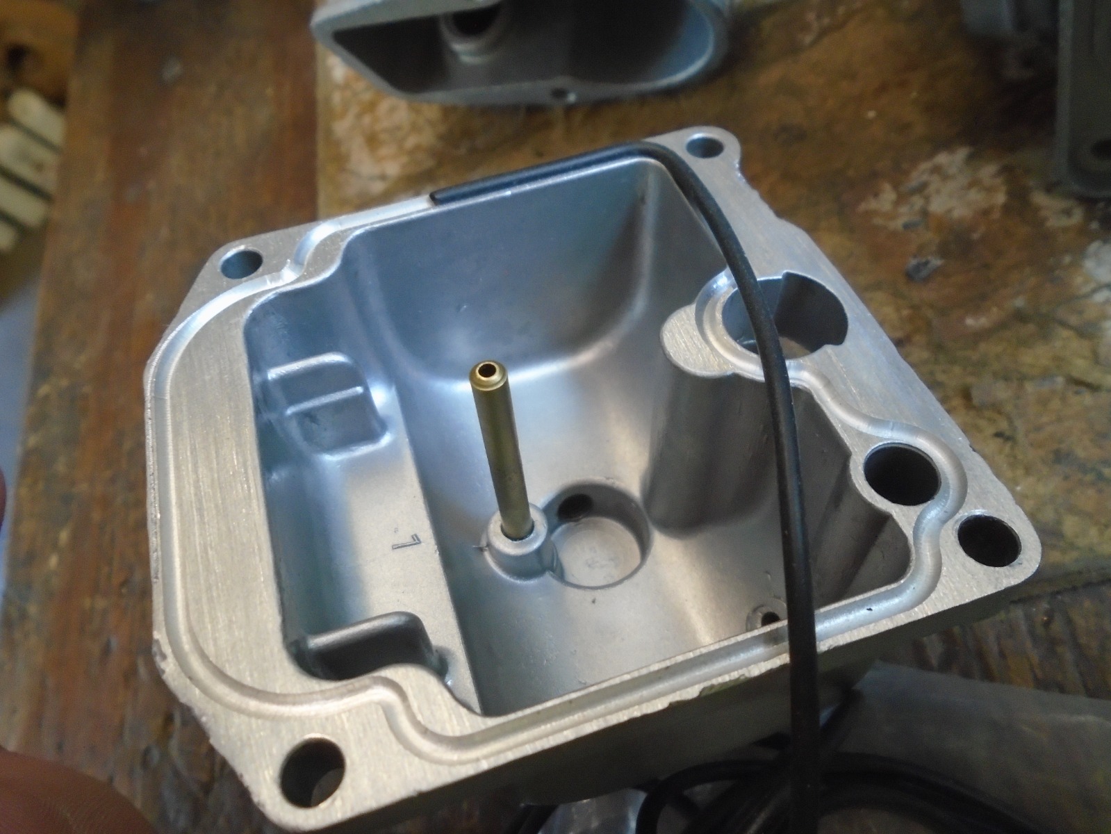

Build it and they will come a knocking Daveo! I'm sure you've considered the advantages/disadvantages of this compared to just removing the head since valvetrain has already been dropped out. As you're aware a simple valve guide seal renew is often just the tip of the iceberg of other needed valve guides and valve seating issues. From my experiences "just" having to replace seal(s) wouldn't of fixed anything on these 4cyls. But keep experimenting, i know i do all the time. Not all things are covered in a FSM. My distain for paper gaskets used on the VM Mikuni carbs has lead me to this resolve. Not anything to really Patent but more of a modification of existing bits to fend off those weeping original gaskets that leave brown stains down your float bowls. Have Fun Daveo!!Â

Nice solution for the gasket problem.
O-rings may be ideally suited for my tool as well, but that would require having grooves machined...which probably is not a big deal.
I would seriously consider replacing old valve springs and seals if a feasy method (short of head removal) was available...
Cylinder 3 exhaust
...Come to think of it, might swap these in the next time I'm under cover...

I like the simple but effective nature of it

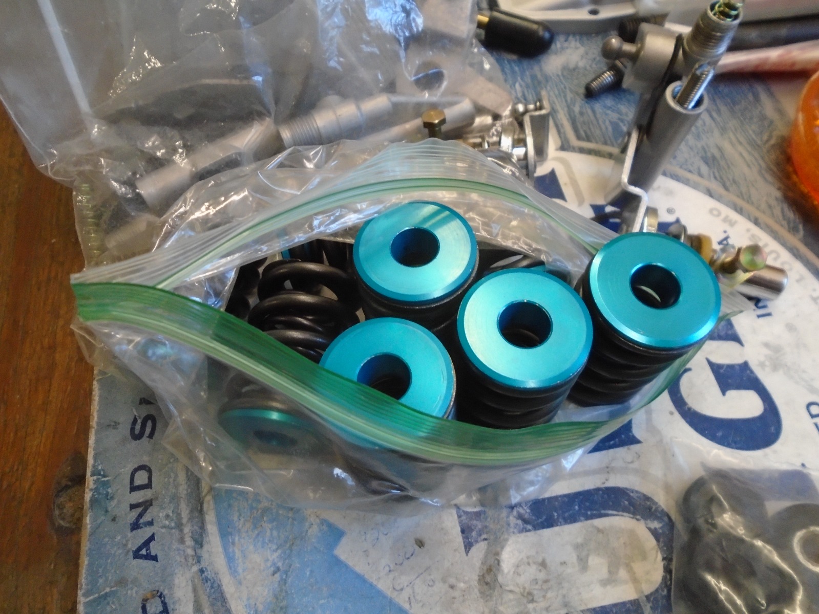

Nice and tidy Daveo! Thought it was going to be more elaborate?Â

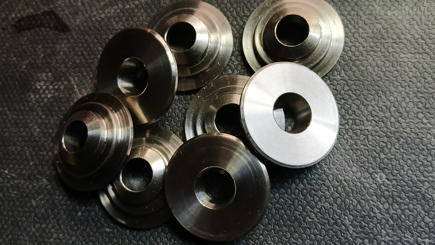

Want some of those keeper retainers in Blue hehe.

  Excellent in its simplicity!
  Have you considered thread durability re: aluminum as material? We can see a shop using that tool to expedite seal replacement. Many, many repetitions of use in a commercial shop environment may tax the wear strength of threads in aluminum past their expected lifespan.
  A hobbyist / restoration enthusiast working in their home shop may never have delved that deep into a head. That person may be attempting a one-off project on the head. What method / advice would you include with the tool to keep a valve from dropping into the cylinder when the keepers are removed?

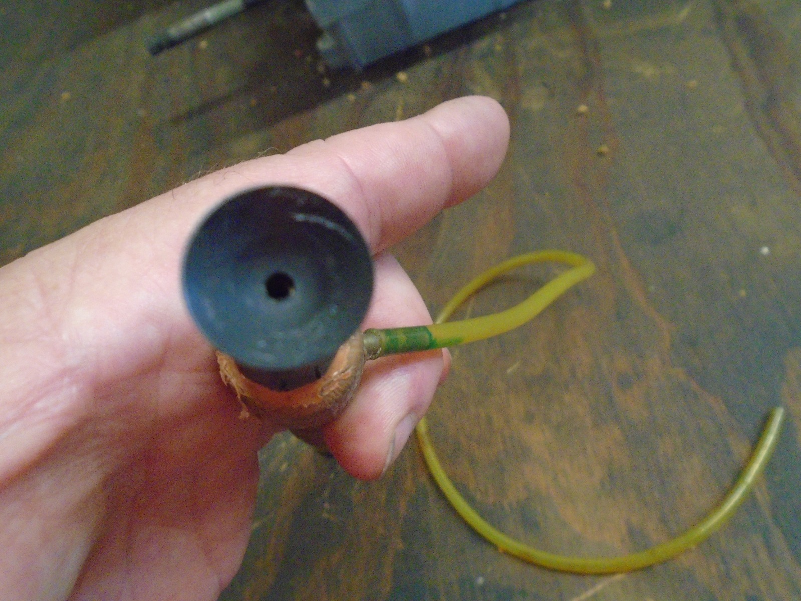

Here's a unique take on a lapping tool Dave. Made this probably 20yrs years ago when doing those Honda 1979 and later 4 valve heads. The lapper kept sliding off those tiny valve heads/tulips. This way i could vacuum them in place and with flexible tubing to connect to a vacuum source still swivel and finish my task. Actually thought of refining it and shuffling the concept to prosperity but was waay too busy at the time raising children/construction which took all my time to complete. A multi-use tool though, not constrained to a particular Make/Model. That makes All The Difference for production and acceptance. Â
Still use it occasionally, just another tool in the box. The Only flaw i can see in your concept is the Often initial "smack" required to set loose the half keepers from the keeper. They are often bound but i suppose the way you designed your tool you could just put pressure on one side to break that "memory". I truly wish You success!!Â
