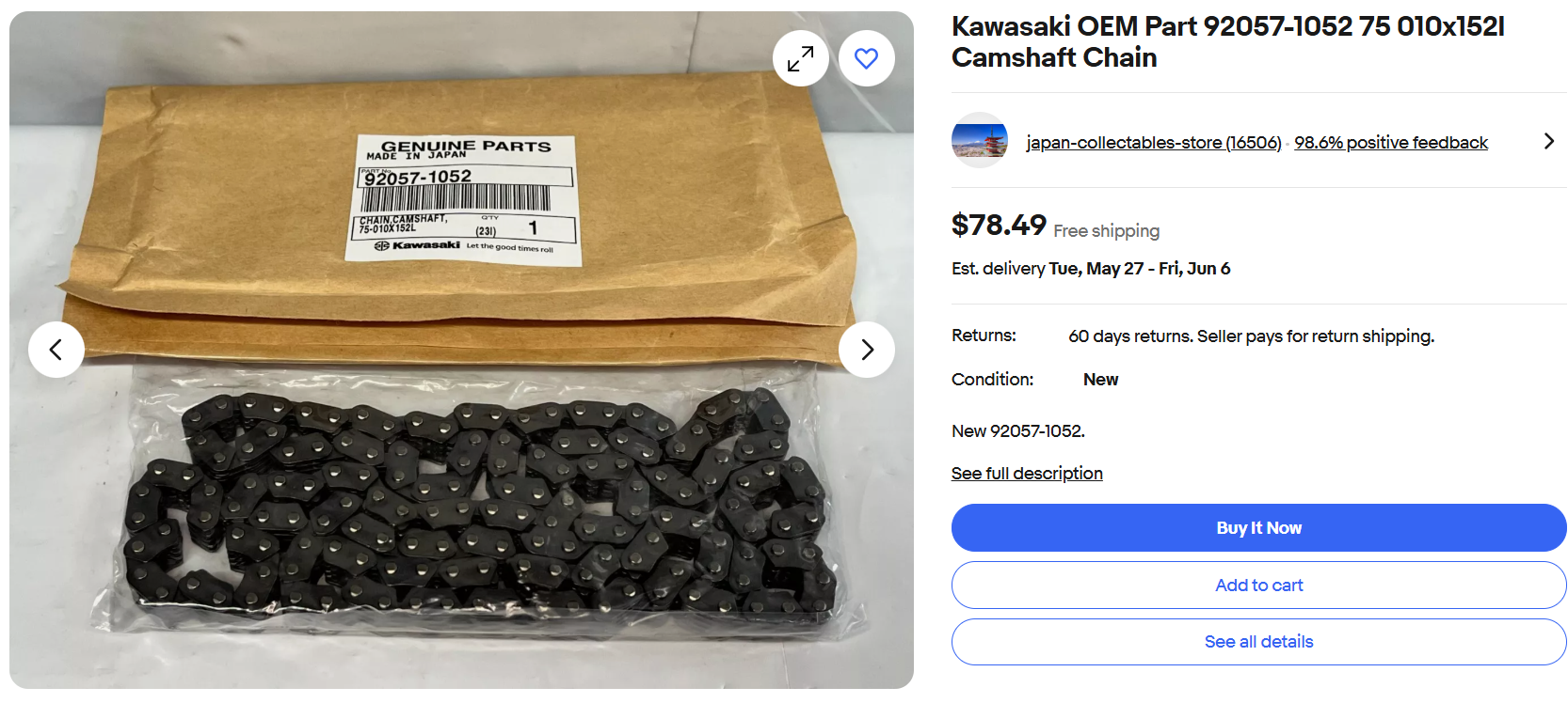

Buy a new OEM chain. It's cheaper than a quality chain tool. Plus, I'm not even sure you can buy this type of chain in bulk.
