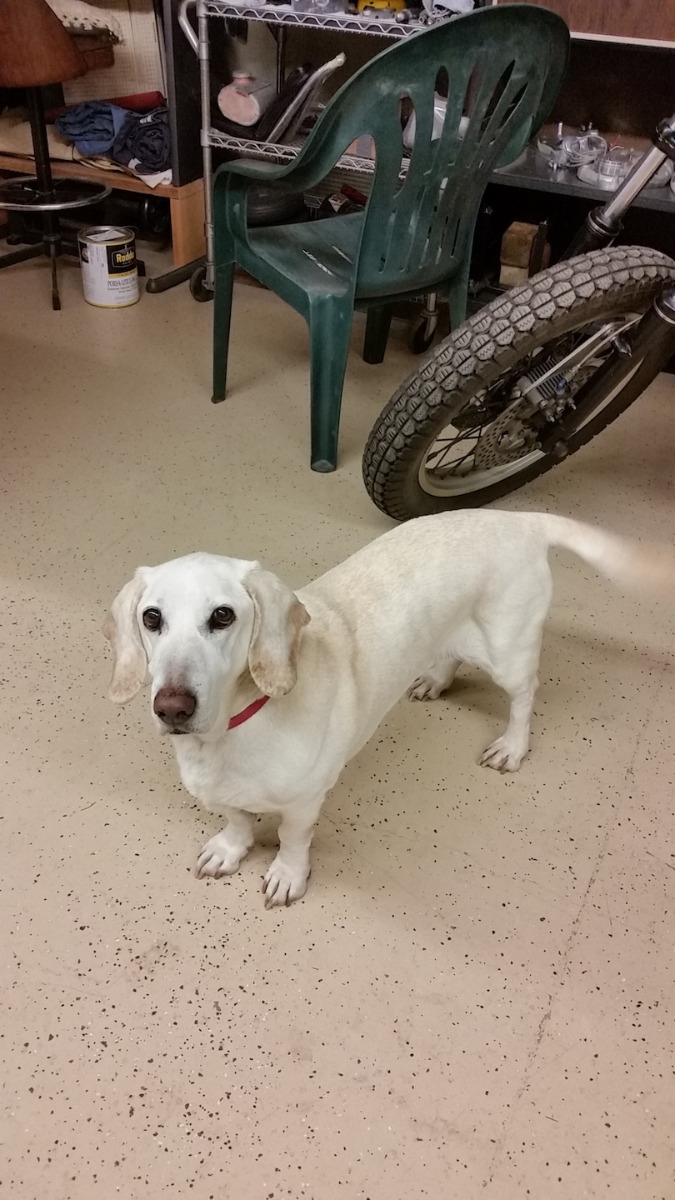

21 Aug 2024 10:05 - 21 Aug 2024 10:23
I used the Rustoleum 2-part epoxy kit and it's held up well for almost 10 years. To me, the speckles are too large and make the finish too coarse. Yes, it makes finding very small parts difficult. Also makes cleaning up spills harder.
