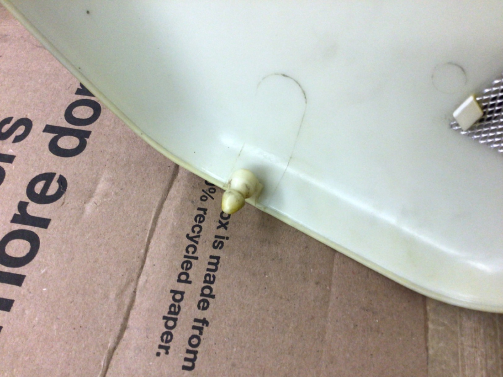

I discovered this magic plastic repair product years ago and since then it has saved me a ton of time and money.

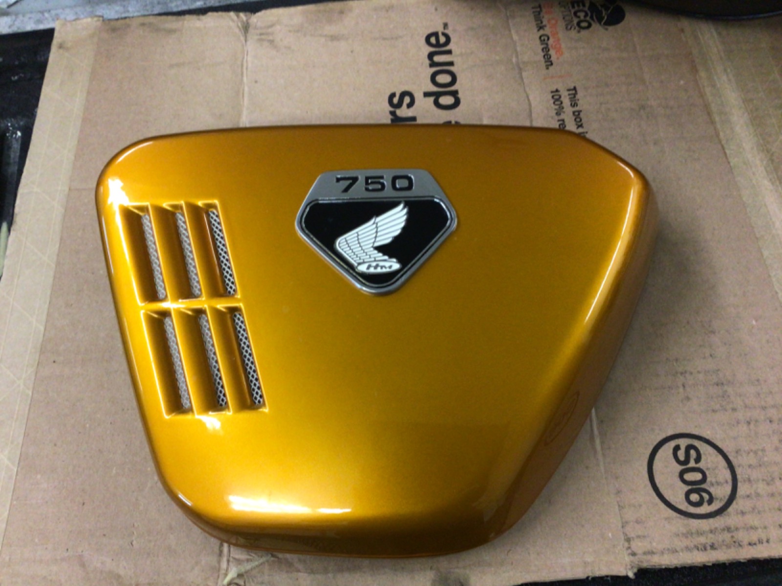

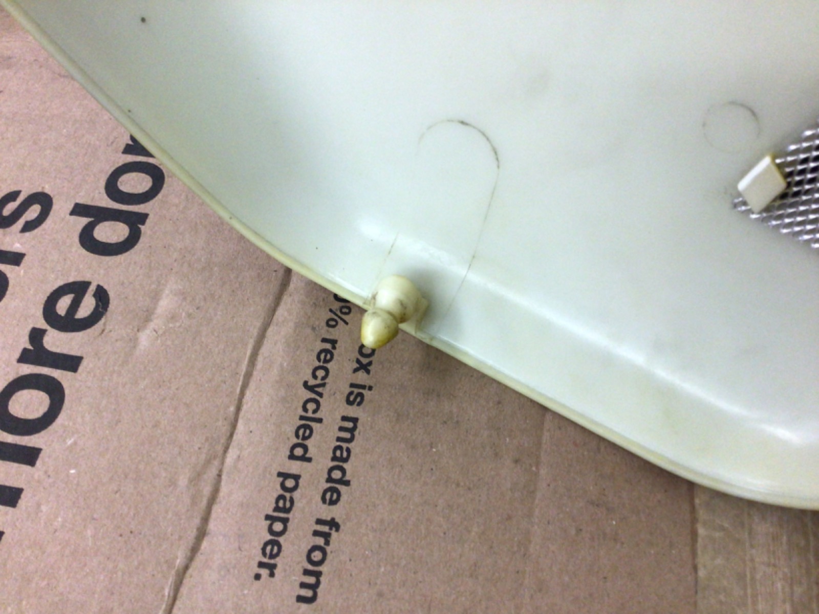

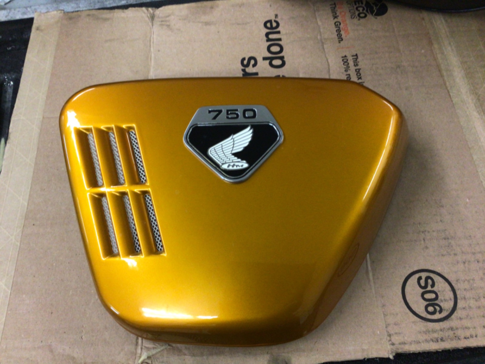

Most recently on my CB750 side cover. I was pulling it off to do some cleaning and to my horror, the bottom tit was broken off and still in the rubber. The thought of having to replace this cover and having the paint color match was not a place I would want to go

End result, my cover is good to go again. I usually do a 2 or 3 step process to ‘build up’ the bonding to ensure it doesn’t break again.

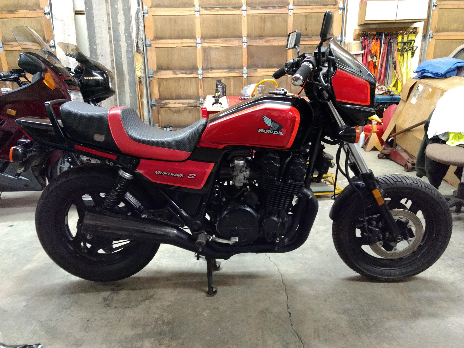

I've used an identical product called PlastiFix for years now. Powder and a curing liquid. I have fixed a stack of side covers and a couple of fairings. On my buddy's 84' CB 700SC Nighthawk fairing I had to build up a section below the headlight that the broken out pieces were missing.
