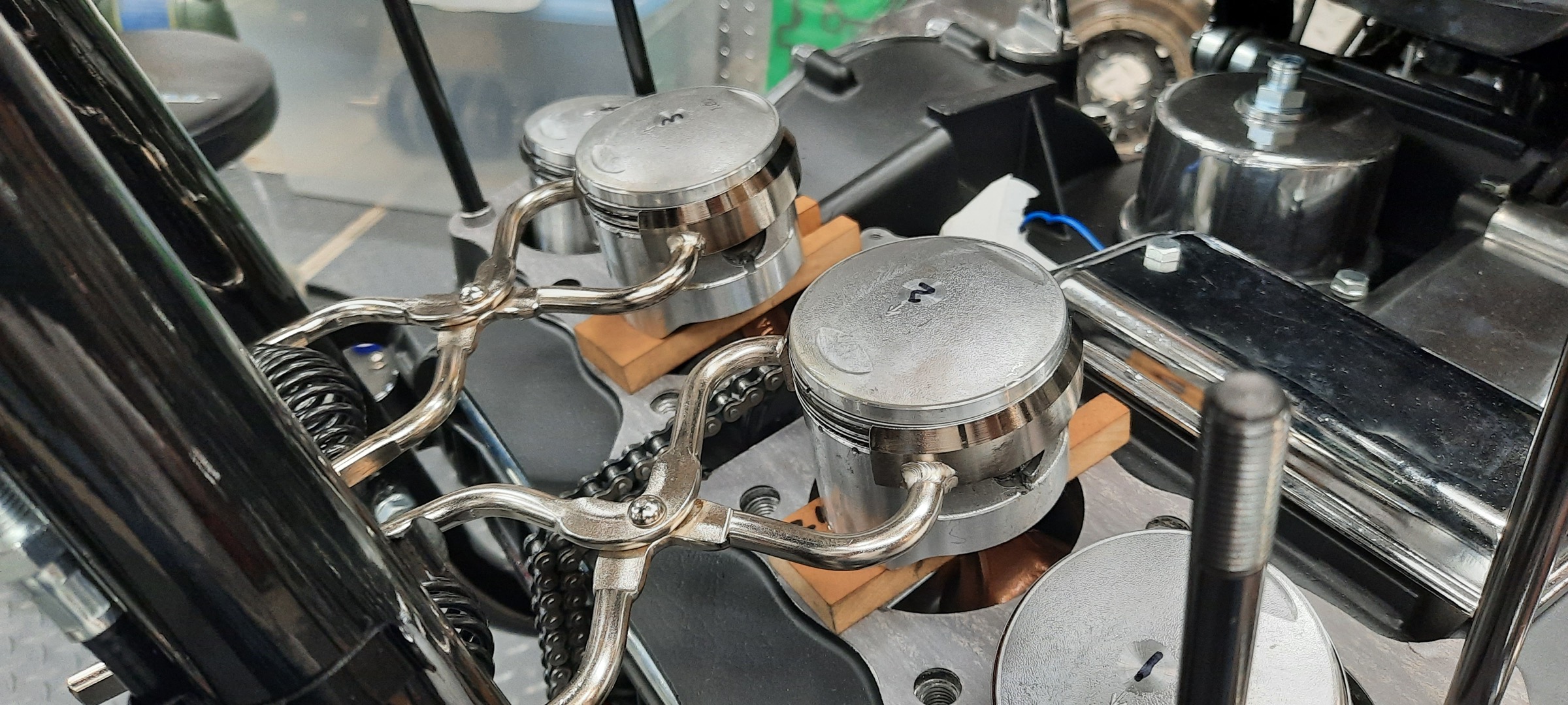

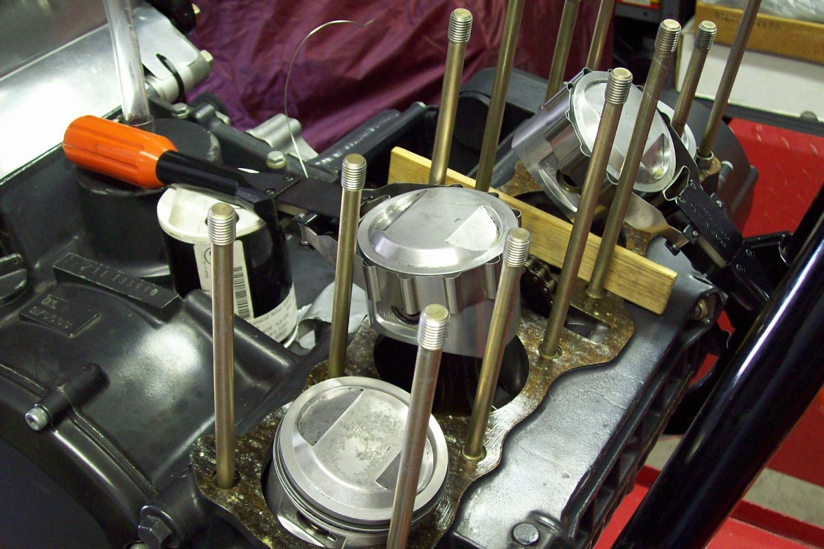

Like a fool a few years back I had to sell my Kawasaki Kz1000 ring compressor tool. I used that Kawasaki tool on 72mm and 73mm pistons on my Kz1000 motors. I still regret selling that ring compressor to this day. What I use now are the band type ring compressor tools. Only need two of them. You do the two inner pistons first, then the outer two. I use two pieces of wood cut to fit the pistons I am using in that motor to sit level as I then slide the barrel down on to those two inner pistons. Then I move the two outer pistons to near TDC and then level those pistons and gently tap the barrel down over the last two pistons. Still wish I had my fancy Kawasaki ring compressor tool......

23 May 2023 20:40I like these Honda Ring compressors for the CB450 and The piston blocks are 1/2 inch MDF with correct cutout for the rod and long enough to support the piston.
