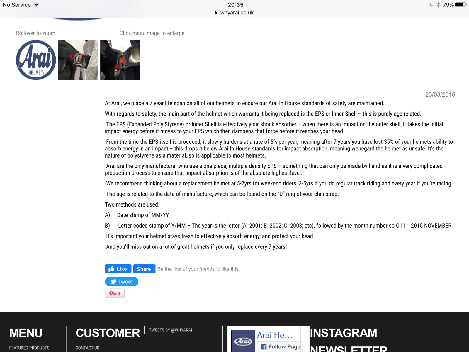

17 May 2023 12:40 - 17 May 2023 12:42
As I said, the choice is yours to decide on the risk level you are comfortable with. However I think the below from Arai is interesting with regards the invisible degradation that effects the "impact absorption" properties (the cynics could say it's a sales ploy !!). Ultimately you "pays your money and takes your choice"
(you won't get past scrutineering at most motorsport events with an "out of date lid")
