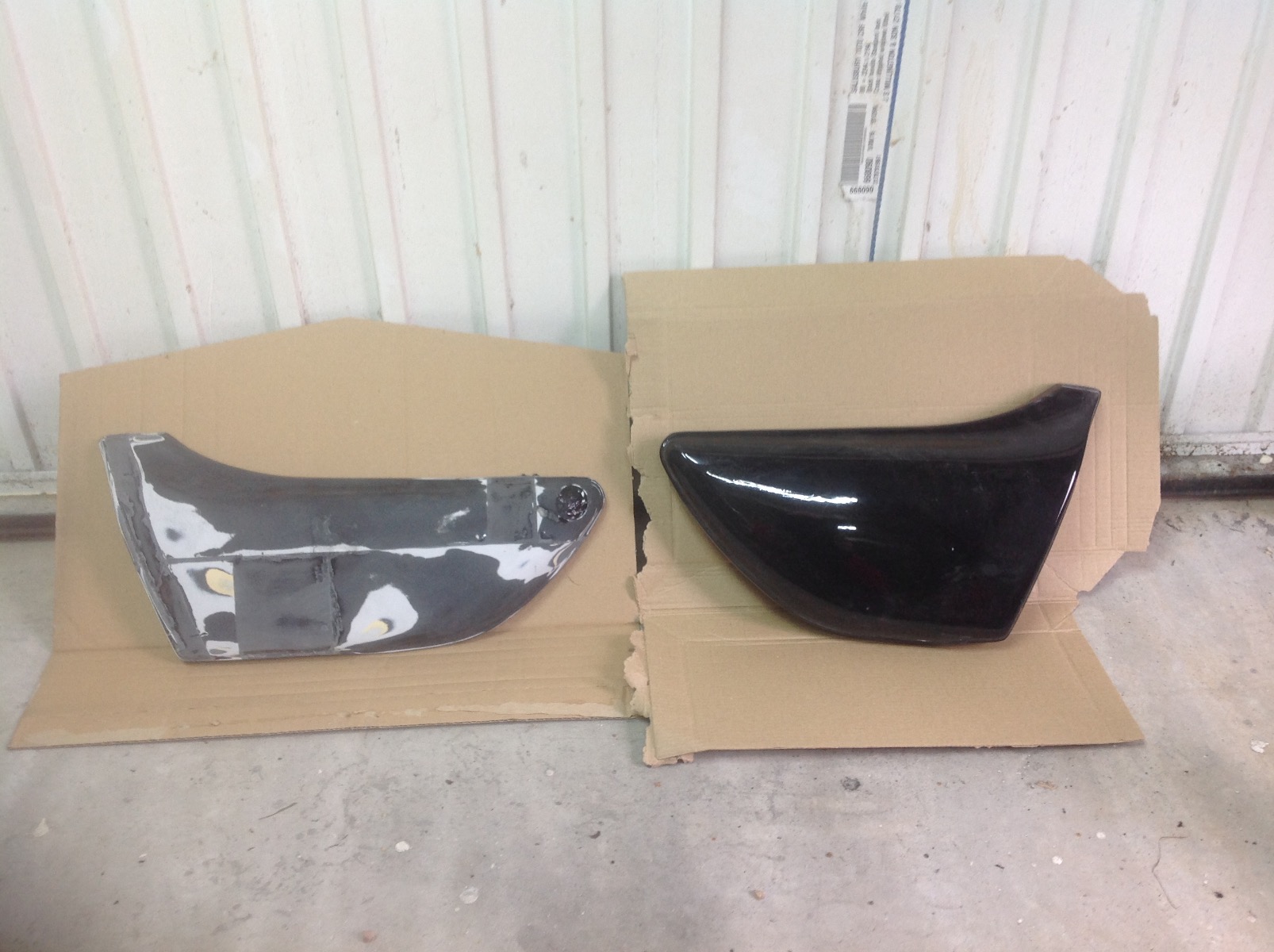

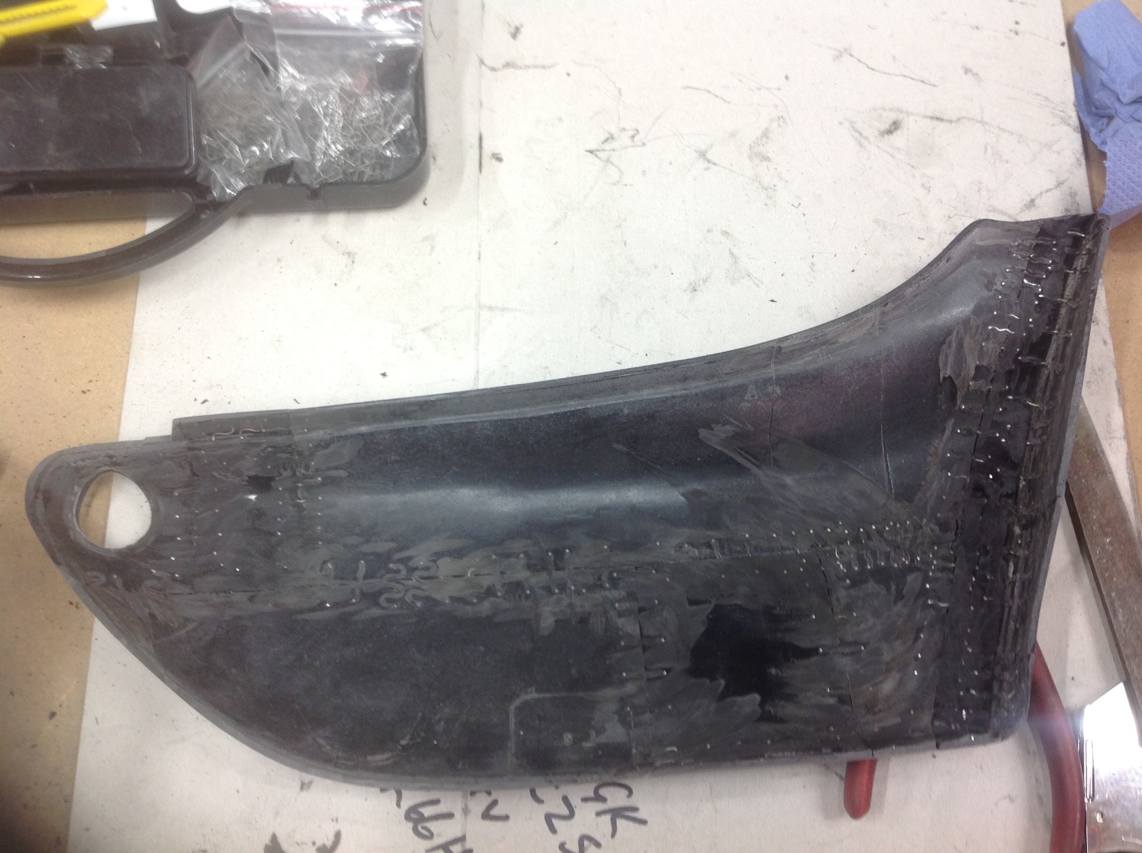

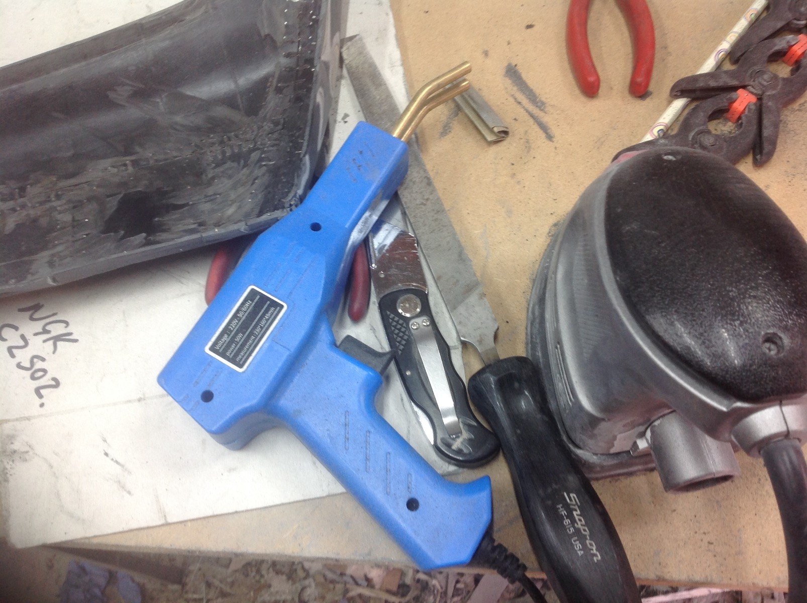

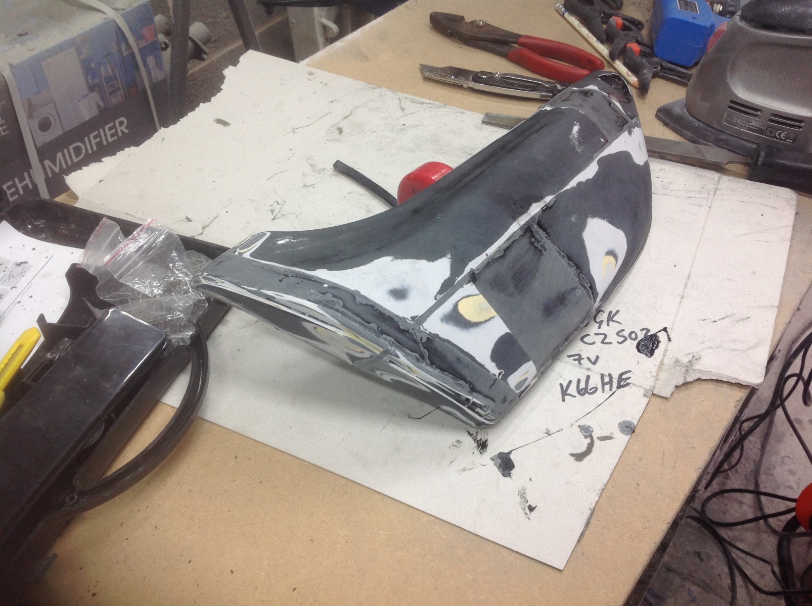

04 Mar 2023 11:32Check out the section of my build where I reworked the side panels, I have used these hot staples extensively and they work really wellI don’t know if this has been shown here but it is very cool. I can see it would work.

27 Mar 2023 02:12 - 27 Mar 2023 02:16This is an interesting article Bill, however given that the kits are only around $25 on Amazon I would definitely recommend you trying the "hot staple" method. One of the biggest advantages (especially with awkward shapes) is you can hold the pieces together (no need for clamping) while you apply a staple, blow on it for a couple of seconds and it's held firmly. You can then adjust the pieces if necc and continue to add more staples along the joint (when I did this I left a very small gap so that once stapled I could run adhesive into the joint. If it is ABS you can also dissolve scraps of ABS in acetone to make a paste which you can apply over the repair with a paint brush. As the acetone etches into the piece then evaporates off it leaves a layer of ABS over the joint which can be sanded if required.Kawasaki side covers are made from ABS plastic.
