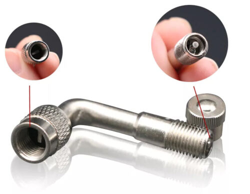

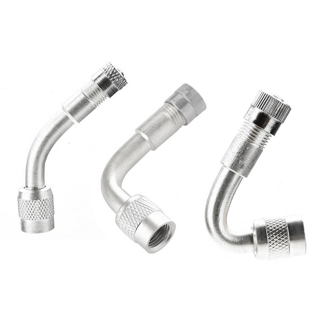

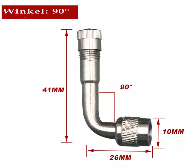

Any good car parts or tyre shop should sell angle adapter for tyre valves.

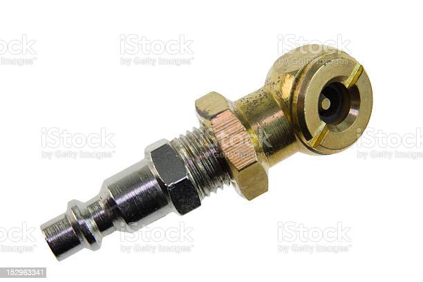

Aka a push-on compressor line. Sure, that would work too. Just haven't got one. I've got a car cigarette-lighter-powered inflator, and a freestanding bicycle pump. I don't mind buying stuff, but the angled adaptor makes more sense as I'm pressed for space.

For a quick fix, that 90 degree adaptor should do the trick. But it does provide another junction for an air leak. The next time you replace tires, put in 90 degree valve stems.
