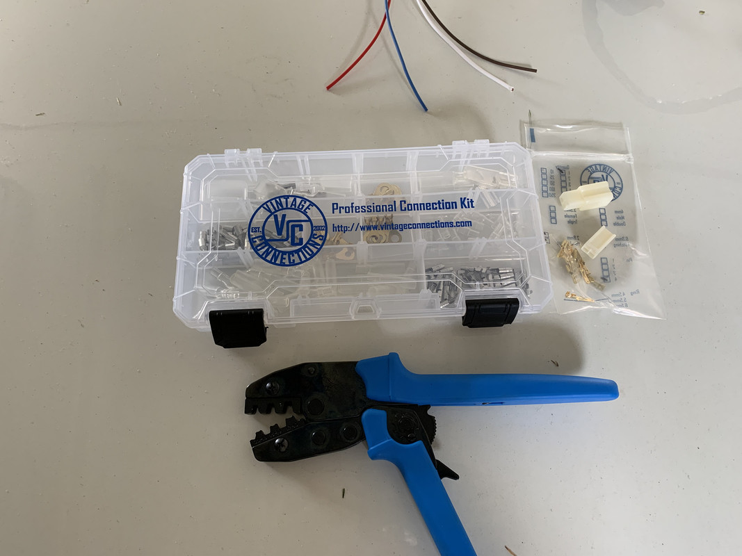

Mikaw dropped a link to this place a while back vintageconnections.com ......what a great website! If you own a bike you should invest in some of their stuff. Super fast shipping and I can make crimps better than OE.
The following user(s) said Thank You: Mikaw, Wookie58

They will get more of my biden dollars for sure. I spent $75 bucks just in case I may need it during a rewire and ya know what, I have needed it 3 or 4 times now..........Thanks for the heads up!!! Great Company.

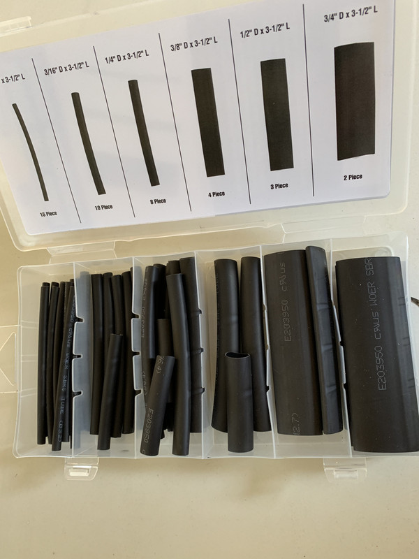

While this isn't really a tool it's nice to have on hand. I bought this at my local Harbor Freight for something like $5.99 which I think is a very good deal for marine grade heat shrink.

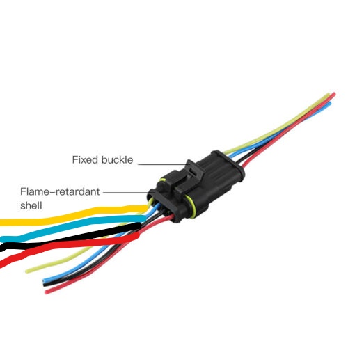

No eBay APP ID and/or Cert ID defined in Kunena configurationHas anyone tried these to make a wiring loom?
They come in 2, 3, 4 and more pin configurations. The yellow seal looks pretty waterproof, and there's a decent looking snap latch to keep the 2 halves together. I'm sure they're more bulky, so getting them through smaller holes could be an issue. But hey, no free lumch!

I will be using these throughout the wiring on my build when I get to that stage, these are basically an aftermarket version of what the car industry has used for years on everything outside the cabin. A word of warning though, they come in a range of prices and quality - if you go with the cheaper housings buy some quality pins from the likes of "Wurth". Also if you have seen any of my posts about electrical fault finding you will see I always recommend taking voltage readings on a "live" circuit. That is not possible with these without damaging the seals unless you replicate the tools dealerships use. Buy at least one more of each pin configuration you are using then join the male and female half's together with approx 200mm of cable. "T" off from each cable with approx 100mm of cable and put a female bullet connector on the end of each. when you need to test you disconnect the plug on the loom and plug this addition lead in series, you can then operate the circuit as normal and test from the fly leads while the circuit is liveHas anyone tried these to make a wiring loom?
