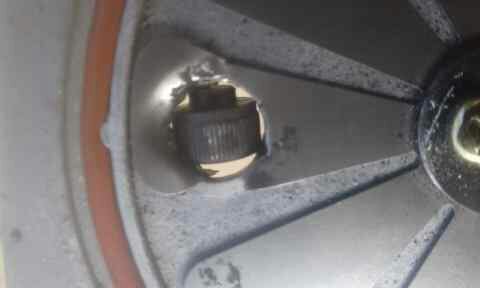

LOL This is what happened last year first time I fired it up, the head broke off of allen bolt that's recessed into the piston top. Made a whole lotta racket! he he
