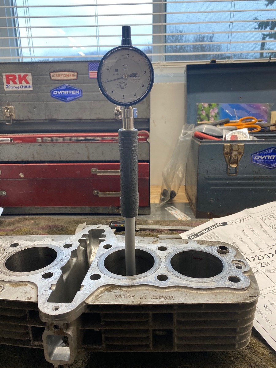

I added this tool to my tool kit so that I wouldn't have to rely on a friend for measuring cylinder bores. It finally arrived today and I've been trying to figure how to use it. The instructions are the worst I've ever seen for anything. Just a couple of sketches to illustrate what it should look like. No actual instructions on how to use it. Their website is just as bad. So I'm looking for help on whether I'm using it correctly.
This is a photo of the gauge. I'm trying to measure a KZ650 cylinder bore with a spec of 2.4407 " to 2.4411 ", with a limit of 2.4449 ". I am using a 2.362 " probe with a 0.08 " washer, giving me a measurement diameter of 2.442 " The gauge is a bit tight, as expected. In fact I think the gauge always had to be a bit more than the bore in order to get a good measurement.

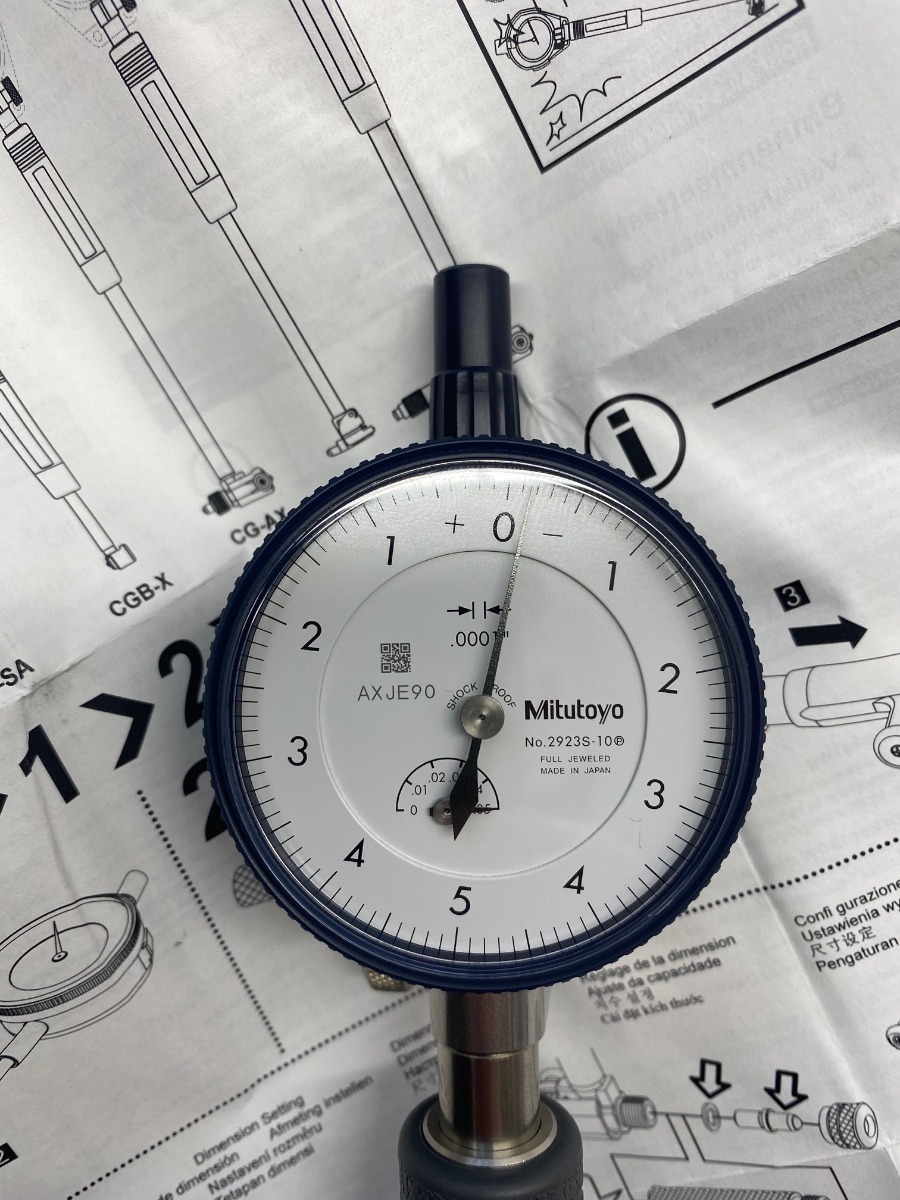

The dial indicator was zeroed with the small gauge on 0.05 " and the outer dial on 0.0000 ".

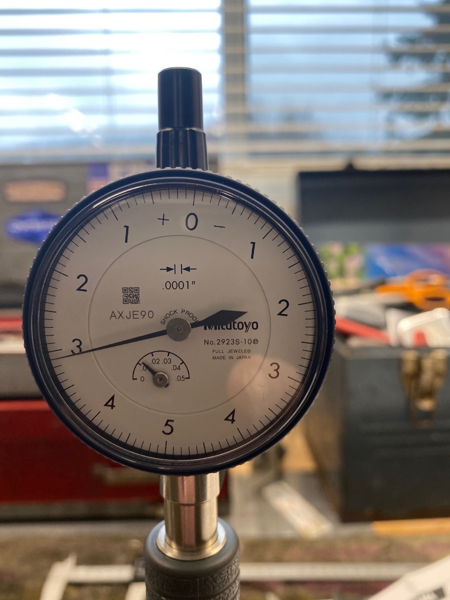

Once in the hole the gauge measured minus 0.069 ". When I subtract this from the total gauge probe length I get 2.373 ". This is well under the spec so I assume I've done something incorrectly.
Last photo shows the gauge instructions....Item 4 in the photo. Nothing specific, just some illustrations to show how to calibrate etc.
Does anyone know how this thing should work?

1) find the right combination of extension length such that when you insert the bore gauge into the cylinder sleeve you have needle movement but it doesn't run out of travel.
2) get a real deal micrometer, one that reads in .0001" increments and is properly trustworthy. Adjust the mic until it's exactly on the nominal bore size: 2.4409" (62mm)
3) Insert the bore gauge probes between the mic anvils (yes, it's fiddly) and rotate the dial until the pointer indicates 0
4) Carefully remove the bore gauge from the mic and insert it into the cylinder sleeve bore
You can now read the bore size by adding the reading on the bore gauge to 2.4409". Wobble the probe back and forth so to speak and look for the smallest reading so to speak. That's how you know you found the proper diameter at that point in the bore.
Check in various places in the bore, at 90 degrees from each other, and top and bottom of the bore. There should be no more than .0010 out of round or taper. The actual bore size is less important. If the out of round and taper are okay, so will be the bore size.
Interestingly, when doing this on my KZ750 I found the bore over nominal, even when measuring in locations in the bore where the piston doesn't travel (such as at the very top.) WTF? I still don't understand that other than to blame Kawasaki about not caring.

At the position in the bore below the dial shows .0017" over the nominal bore size.

I'll try your method but first I have to get a larger micrometer. Mine are 1 in ch and 2 inch only.
After reading your method it seems to me that you are putting your borehole gauge into the micrometer just to set your gauge to zero at the nominal width of the cylinder. Am I understanding it correctly?
If so, then what I was doing should work.
I start with a known dimension for a particular insert. (This dimension is slightly larger than the borehole.) I insert the gauge and read the change in the dial gauge. This number is subtracted from the known dimension to get the borehole size. Does that sound correct?
