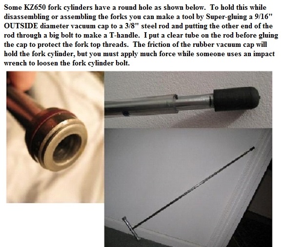

Some KZ's had a round hole in the top of the fork cylinder and others had a hexagonal depression. Check to see which type your bike has. If it has a round hole, like my 1977 KZ650-C1, you can either make a tool as I did (see image below) or you can buy a tool for the job as shown here: www.racetech.com/page/id/70 .
