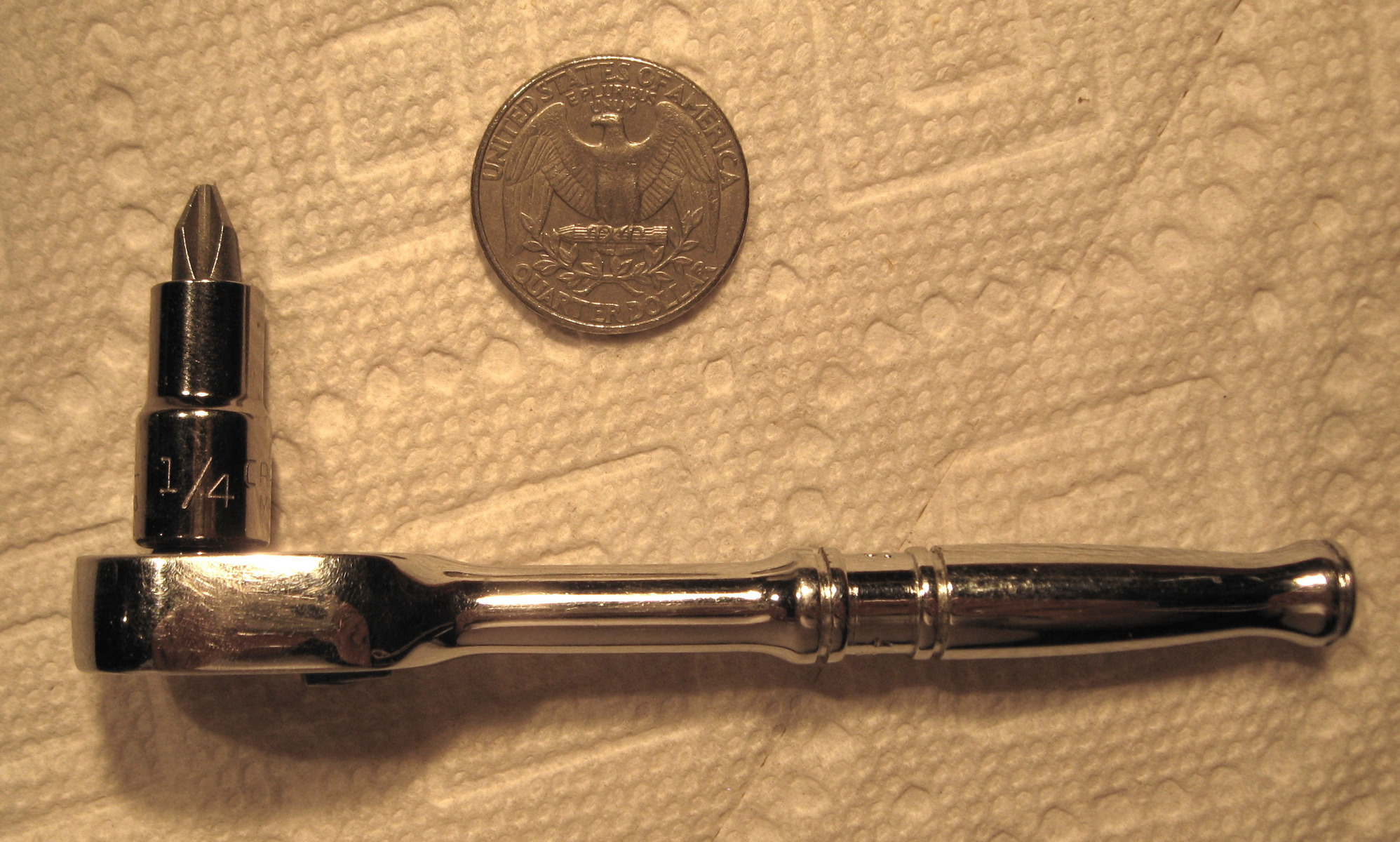

I need a JIS screw driver to get to the carb holders. Two came in my tool bag and the larger one (~1/4 in diameter) fits the screw but I'm not sure if it is a P2 or P3. Does anyone know?
I need to purchase a shorter (stubby version?) since I have less than 6 inches between the air box and the carb holder.
Also, if you know of a good screw driver that is short I'm all ears.
