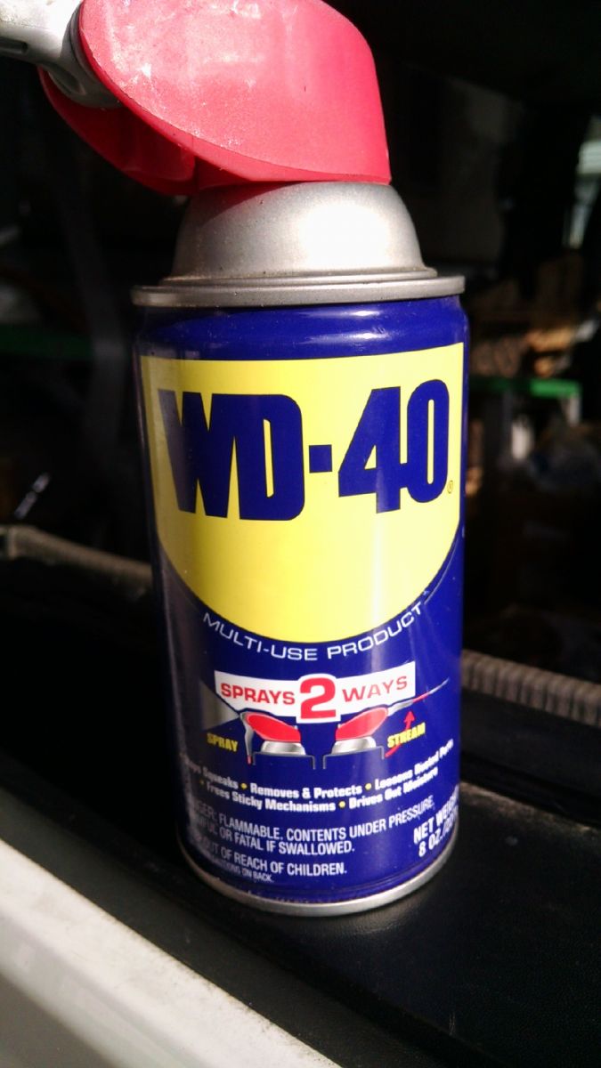

When you say wd, do you mean regular wd-40 or one of their new wd40 penetrating oils? Because regular wd40 isn't really a penetrant. : )

Yes Martin. WD-40
This stuff. :-)

WD-40 is a petrochemical cleaner/carrier along with light oil. The MSDS can be found online.

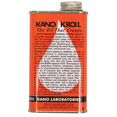

Based on a recommendation from a very experienced engineer friend of mine I use Kano Kroil. Over the past couple decades I've used it on some extremely stubborn bolts & screws and it has always worked extremely well. I let them soak for 2 or 3 days and Kroil breaks the bond. Here's the flavor I use. Ed
