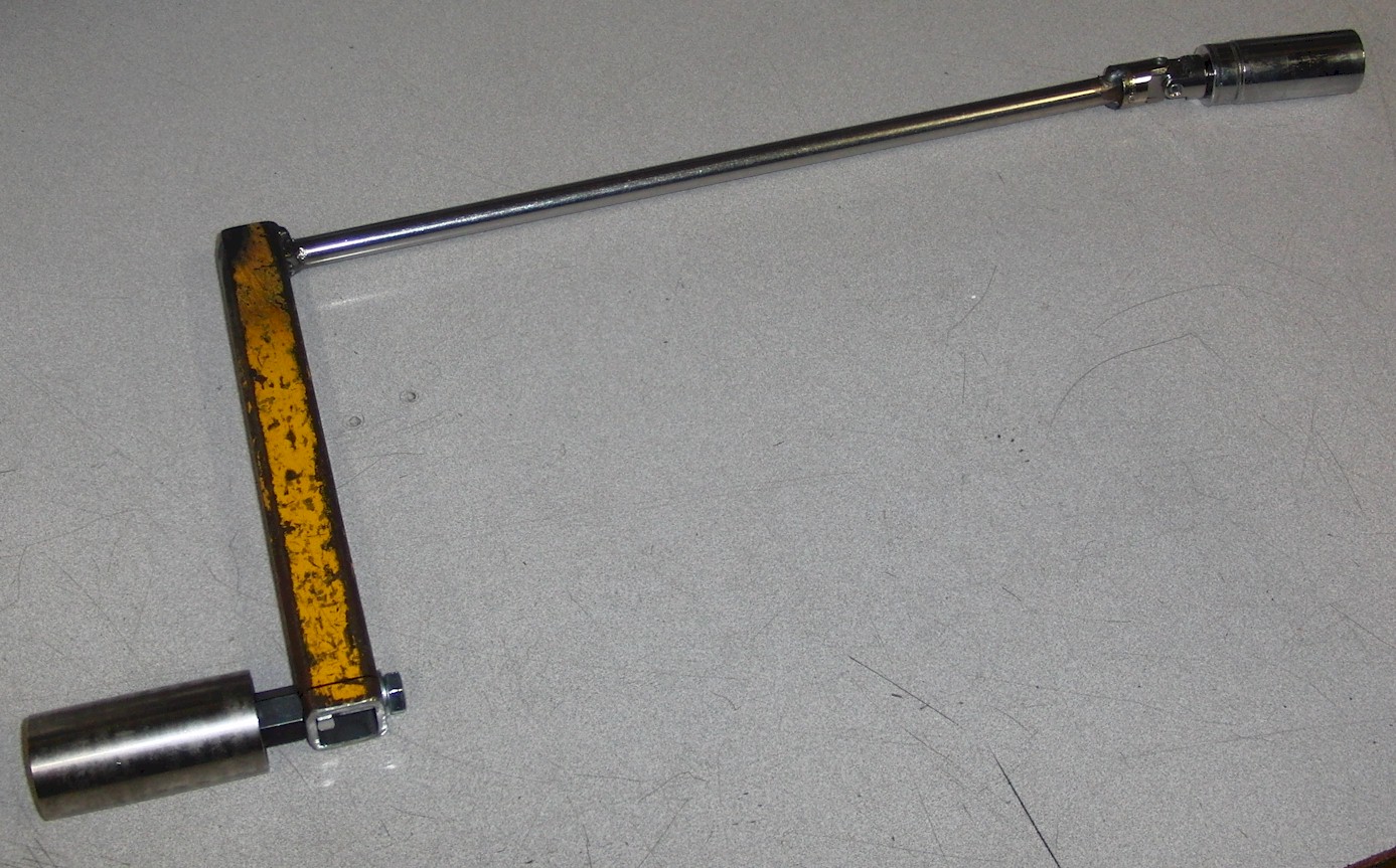

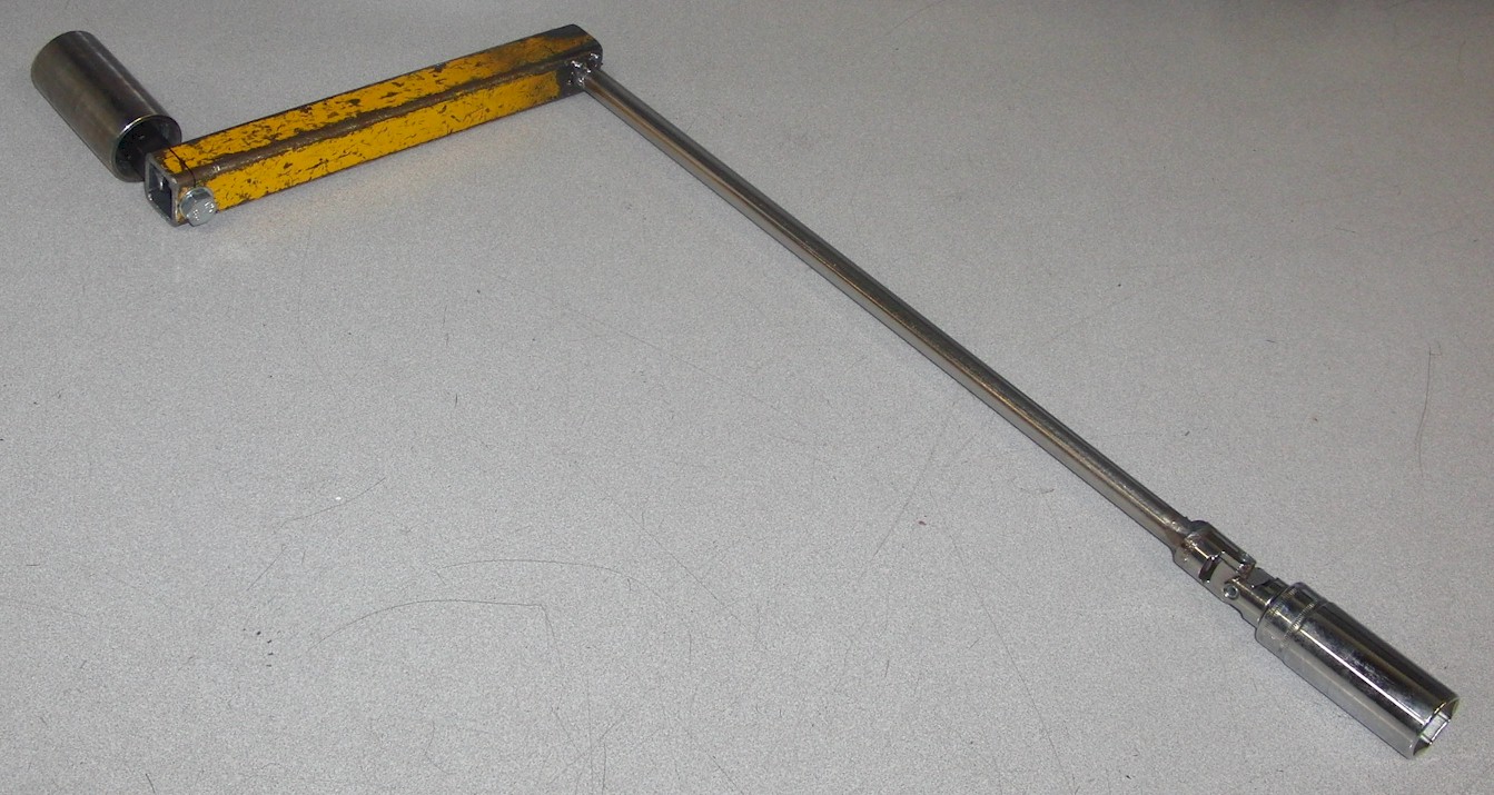

Anyway, if you've ever dealt with a multi-piece scissor-jack handle you know they are pretty much crap. You have to hope it stays together while cranking the jack. It's always pretty slow and clumsy. I find I'm more often changing flats (on my car or wife or friend's) in bad weather, especially winter, so I want to minimize the time and effort.

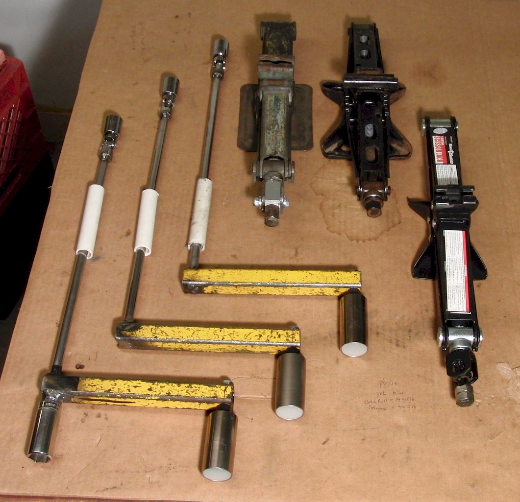

Well, at work I've been trying to get this old Hobart RC256 wire-feed welder tuned up and needed a project for testing. I decided to make some one-piece jack handles to get the welder dialed in. The square-tube scrap material i pulled from the dumpster is used for tow hooks so it's very tough, hard, and does not rust easily, but still very magnetic. I don't know what it is, but the E71T-GS wire (same general-purpose wire that comes with consumer hobbyist welders) seems to weld to it pretty well. The welds are a bit porous and not super strong, but the penetration is good and way stronger than it needs to be for this application. I did a lot of destructive testing on other pieces.
The first attempts were with plain steel wire and argon. That did not work very well on the hard scraps. It was more gorilla-snot and would roll off of the scrap with a lot of spatter balls. The E71T-GS is flux-core and works much better. Either wire worked well on the hardened round shaft and tool steel.

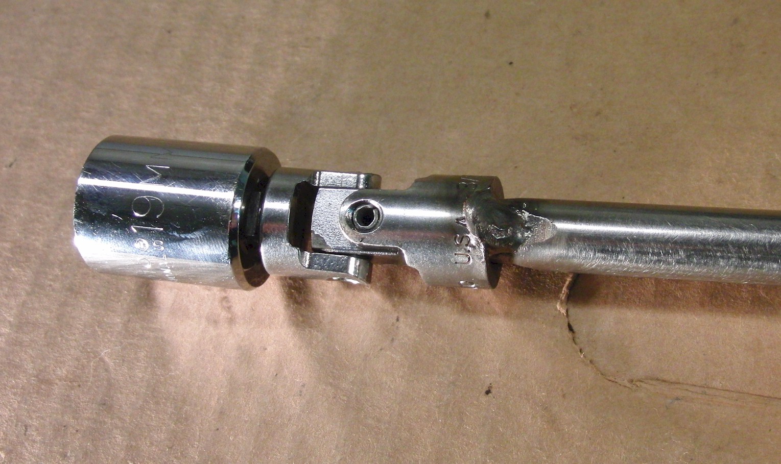

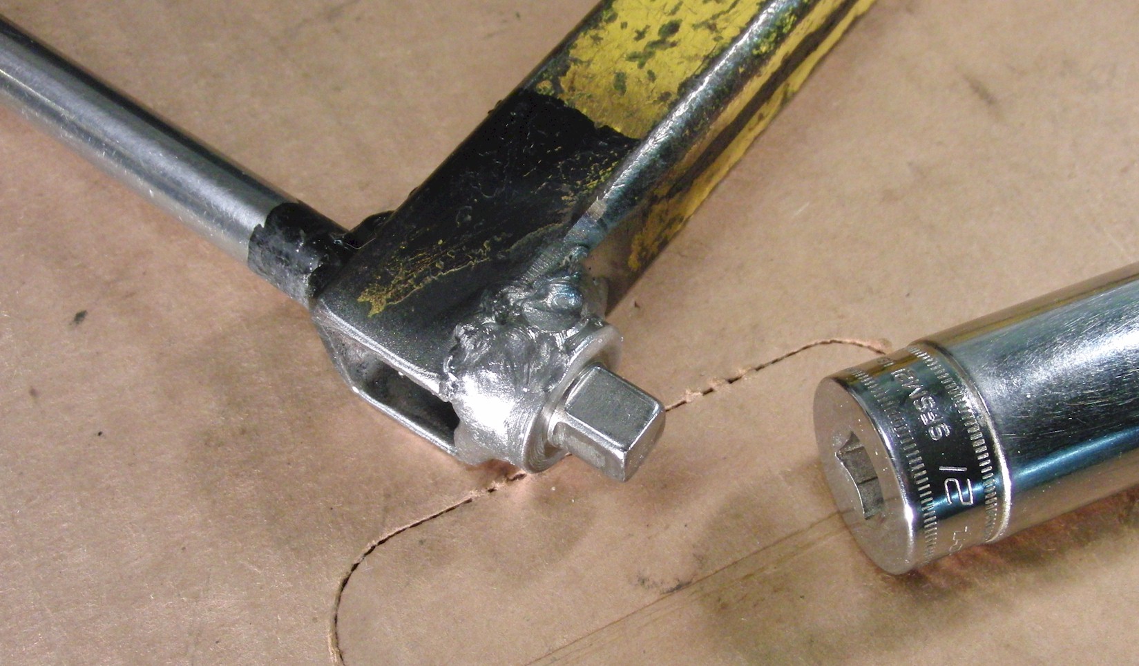

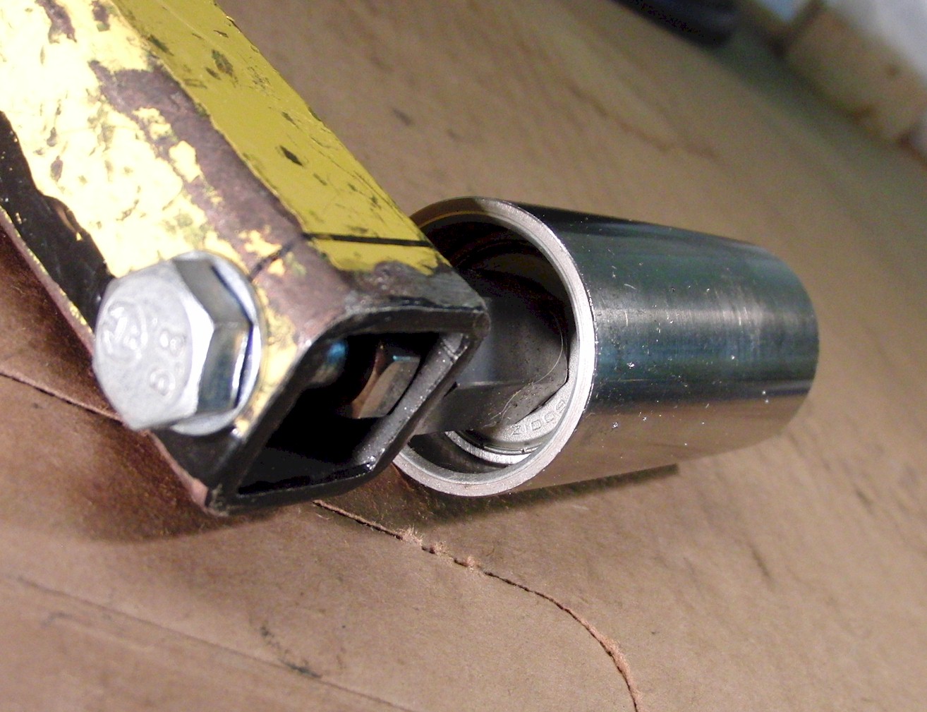

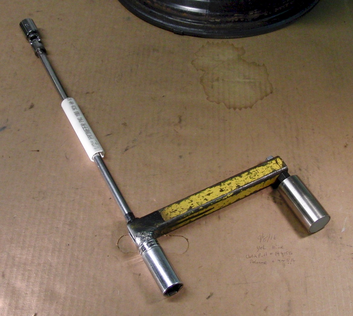

I found some ball-bearing rollers to use as the rotating handle, then just slid on a piece of PVC as a slip grip for the shaft. The socet is held to a 3/8" u-joint which is welded to the shaft.
I found a Jack that used a 19mm (3/4") hex as the jack input. So I modded a couple other jacks to work the same way. The first handle worked so good, I made two more.

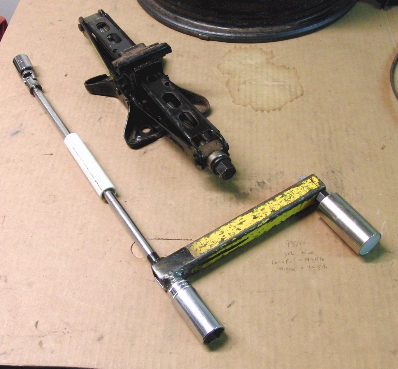

Now I could two-hand crank the car up in just a few seconds. But more importantly it was smooth and soo satisfying!
As a side note, the jack with the hex was a GM jack of some sort. It works pretty good. The dirty silver jack is my old Nissan 260Z jack that I've had for 30 years. I've used that as my primary jack for most of my life and it's still by far the best one I have... solid and smooth. The cheap Harbor-Freight jack is garbage. It flexes and feels crunchy even after thoroughly cleaning and lubing.
I went to a junk yard to get some replacement rims, and they gave me one of those GM jacks for free! (Normally it would have been $11.) They had piles of jacks... that's where you go. Forget HF for small scissor jacks.

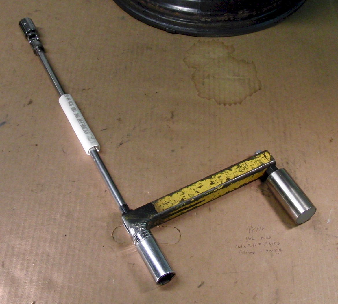

So you might notice one of the handles has a second socket attached. Well the jacks use 19mm hex but Nissan lug nuts are 21mm. I wanted to be able to also use the jack handle as a speed-wrench for any stiff lug nuts, so i needed a second socket. But the second socket kept rolling loose in the trunk making noise so I added a perch for the second socket on the handle. It is just to store the second socket.
