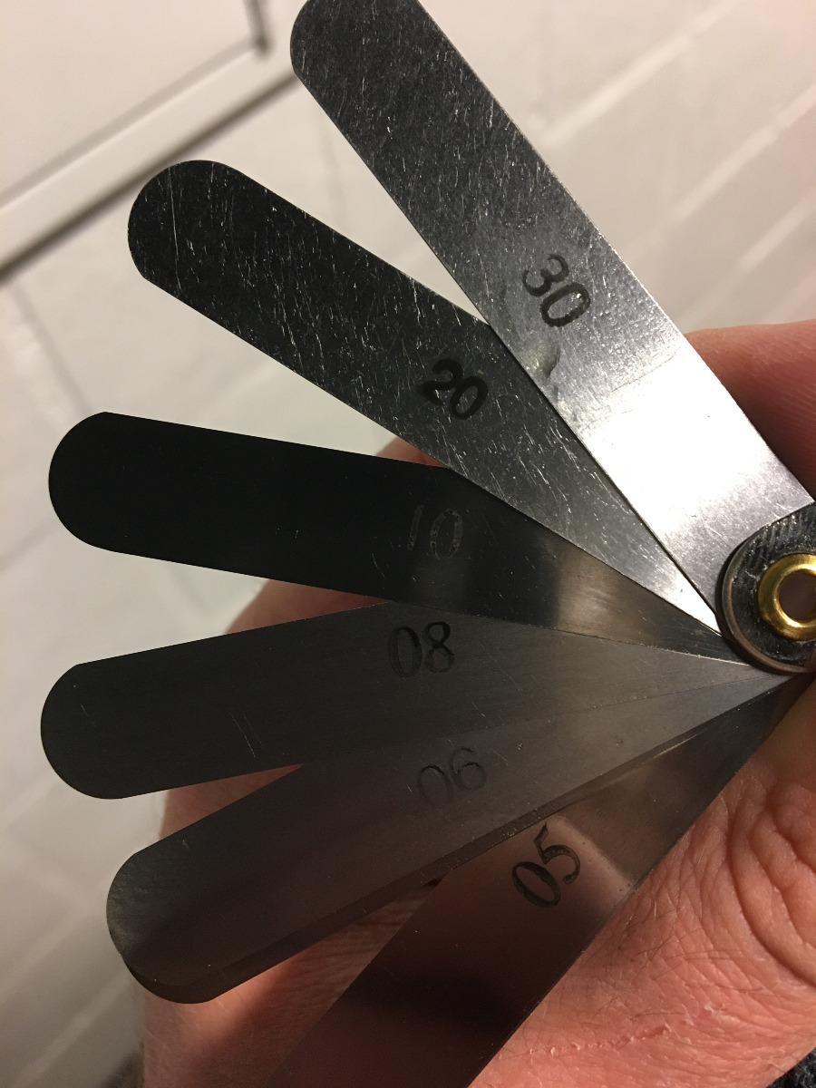

I received the feeling gauge today, but these also have some gap ?
It jumps between 10 and 20, how can I measure where I`m between ?
For my engine the tolerance is 0.10 - 0.15, so I want to be close to 0,15mm ?

Put the 10 and the 5 together,or is this a trick question?

That is what I have done before also, but thought it was a bad solution 10+5 = 20 + X (since you adding two blade together = 17 ?
Oil between the blade give some extra thickness ?

13 Nov 2018 08:43gordone wrote: Oil between the blade give some extra thickness ?
I always felt this to be the case too. It would be easy enough to check with a caliper or micrometer, but I never have. Whatever it might be, it would be trivial.
Wiping the feeler gauge blades clean is a must. Debris can also be stuck with the oil.
But, yes, it would be best to use the proper thickness, assuming it is the proper thickness to begin with.
