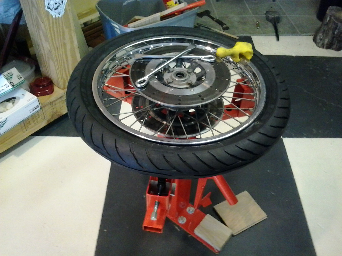

The Rabaconda is exclusively for enduro /dirt bikes. I was banging around for possibilities and spent a fair amount of time on the No-Mar site. I'd pretty much settled on do that and buying the Cycle Hill model. It occurred to me that I should check out Craigslist so I signed on. It must have been my day. 2 weeks ago a guy had the CH-200 for sale because he was moving. Used it to change one set of tires, then got injured riding dirt and is giving it up. It is perfect and snagged it for $450. No shipping, no waiting, I'm really jazzed. I bounced online and and ordered a 3 pack of 14 inch spoons, a Tusk static balancer, wheel weights, a couple Motion Pro rim protectors. Now I'm good and dangerous. Tally ho. The link below for as long as he leaves it up. Has pics

Nice catch, that should come with a lot of accessory's hopefully he has the YellowThing included and the ExtraHand is also good for keeping the old tire in the low while removing it.
I installed anchors in the floor so the stand can be moved in less then 5 mins .

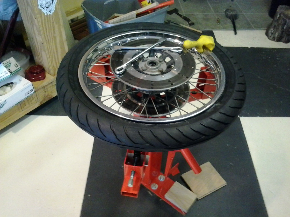

I bought a Yellow Thing from Amazon, should be here Friday. As I watched the videos, that looked like something that was more than just handy. I watched three videos from three different sources. Honestly, doesn't look like it could be any easier.

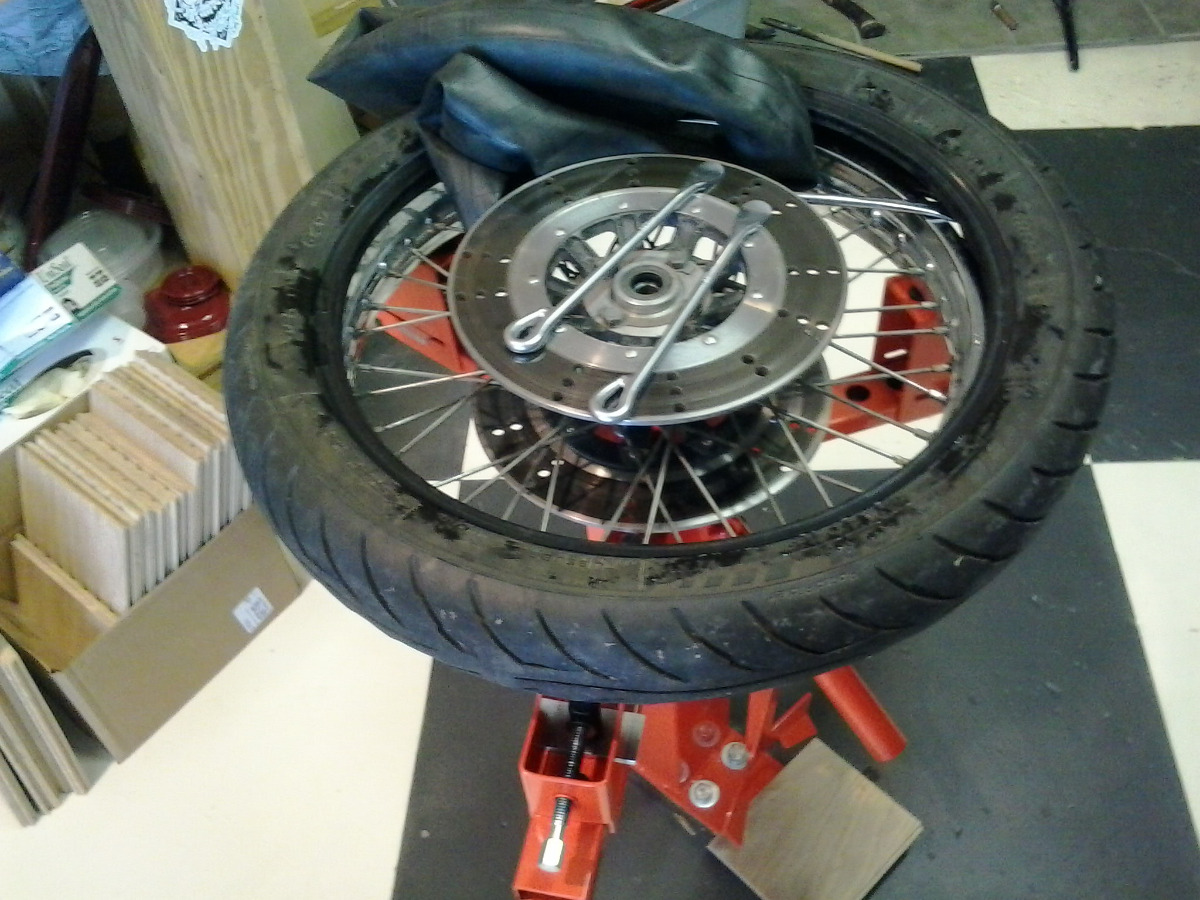

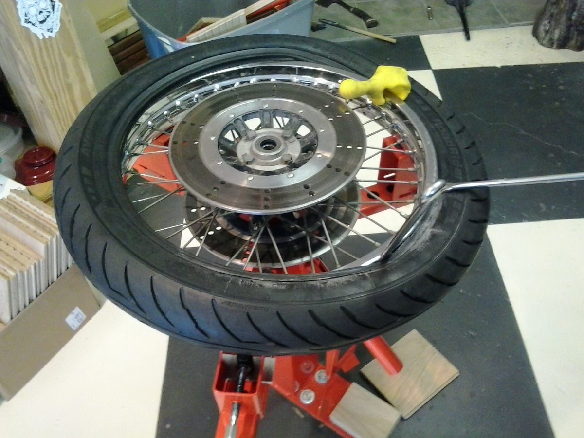

Most of those vids deal with tubeless, that bar is no help with a tube tire.
using the Thing to hold one side of the tire in the low part of the rim and working your way around with a good set of spoons is key.
The ( Extra hand ) works well for removing the tire.

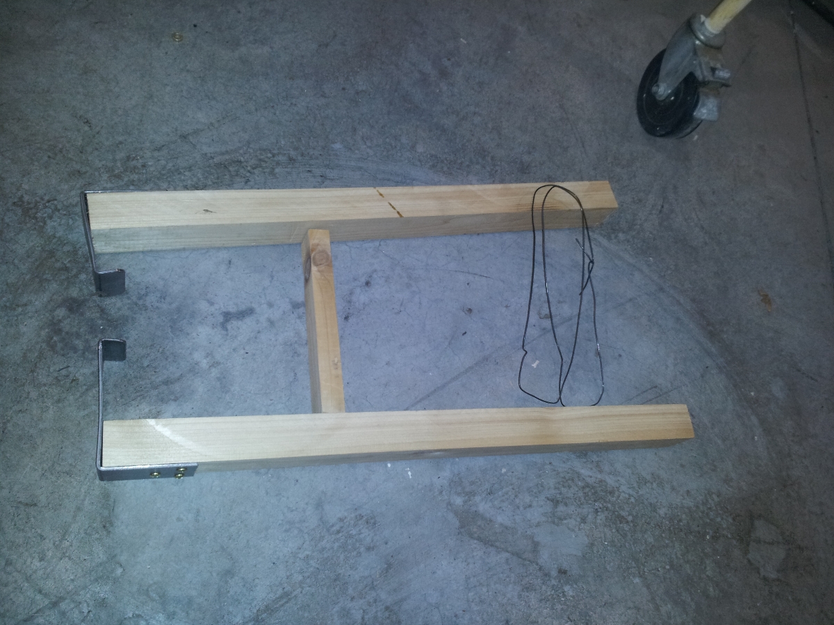

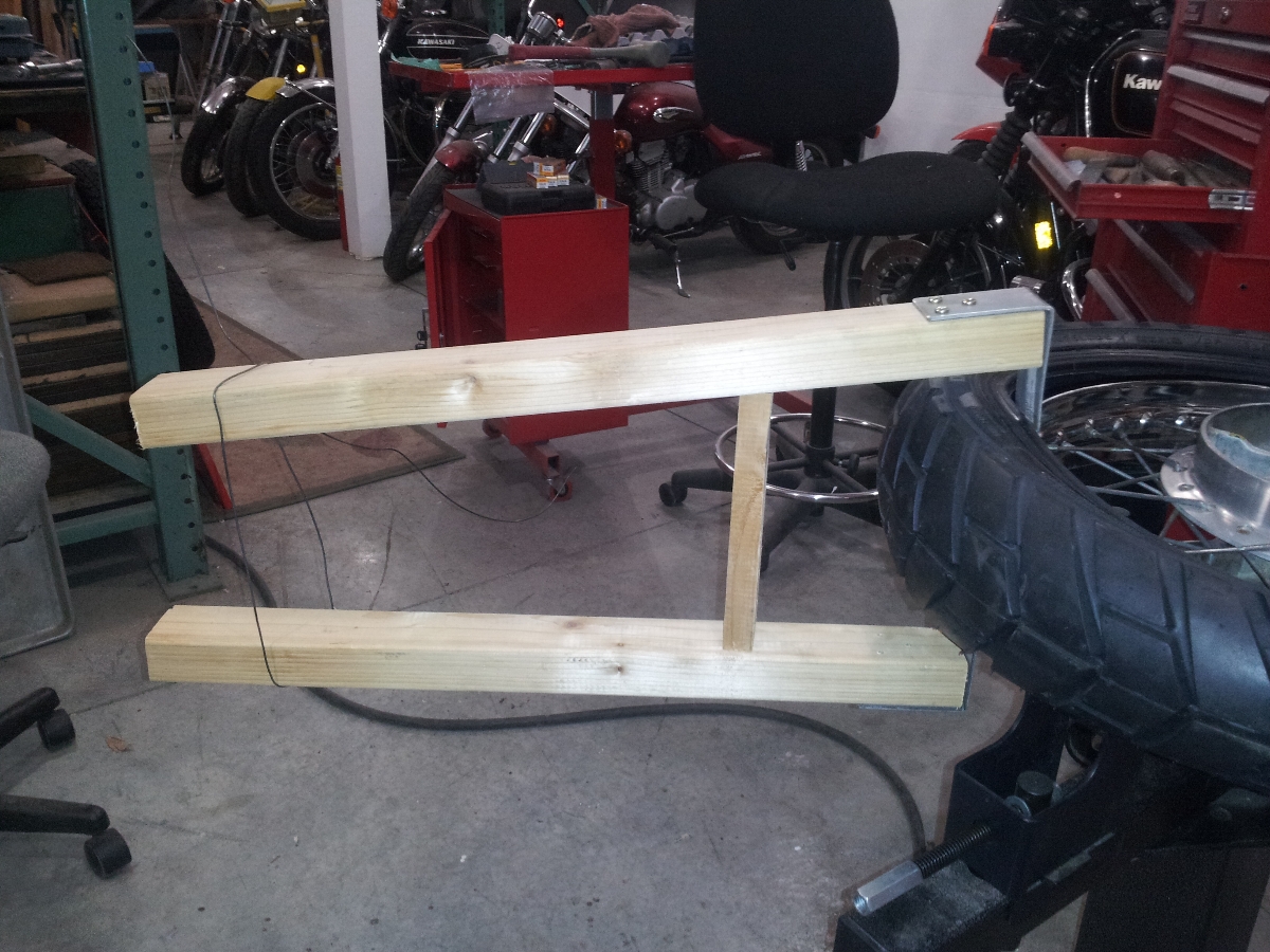

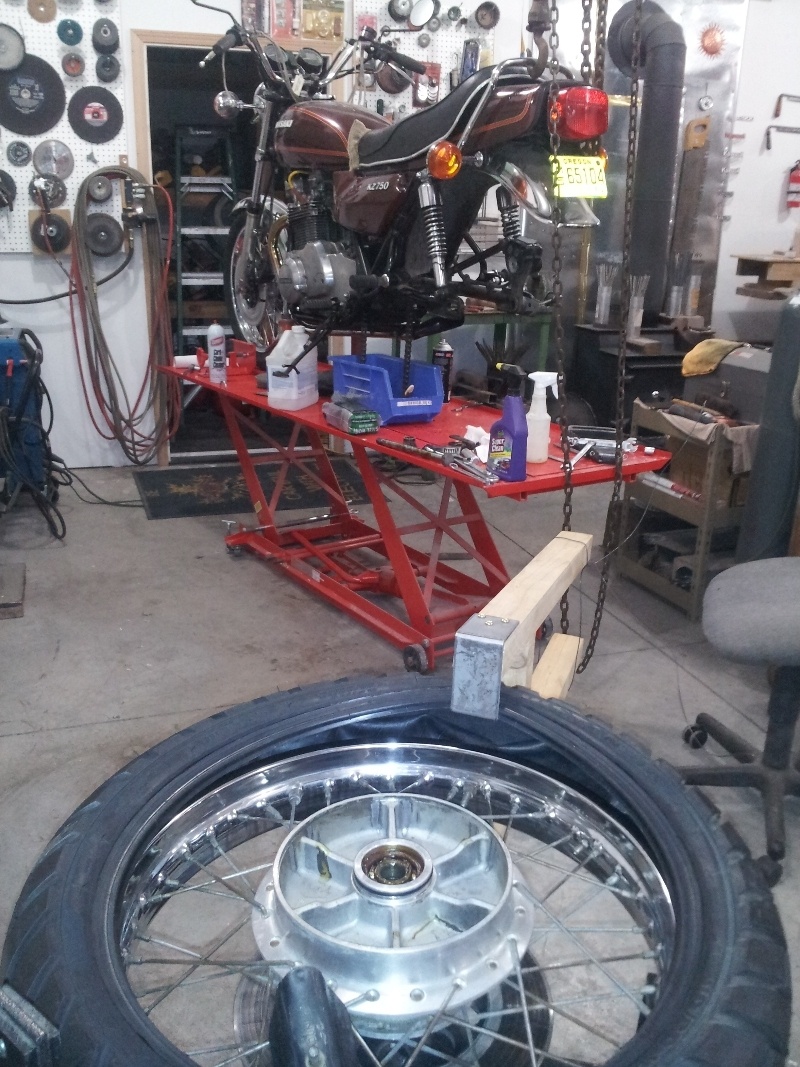

I have a No-Mar changer as well.and found that it does great on tubeless tires. For KZs tube types:
I suppose my hands are too big. As I was trying to fit my tires and bead locks at the same time all I was accomplishing was scraping the bark off of the backs of my hands. So I slowed down and built at pair of bead spreaders. They worked great.
Now if I could invent a tool that made installing intake boots as easy as these bead spreaders make installing bead locks, I'd be a rich man.
Bill
Bill

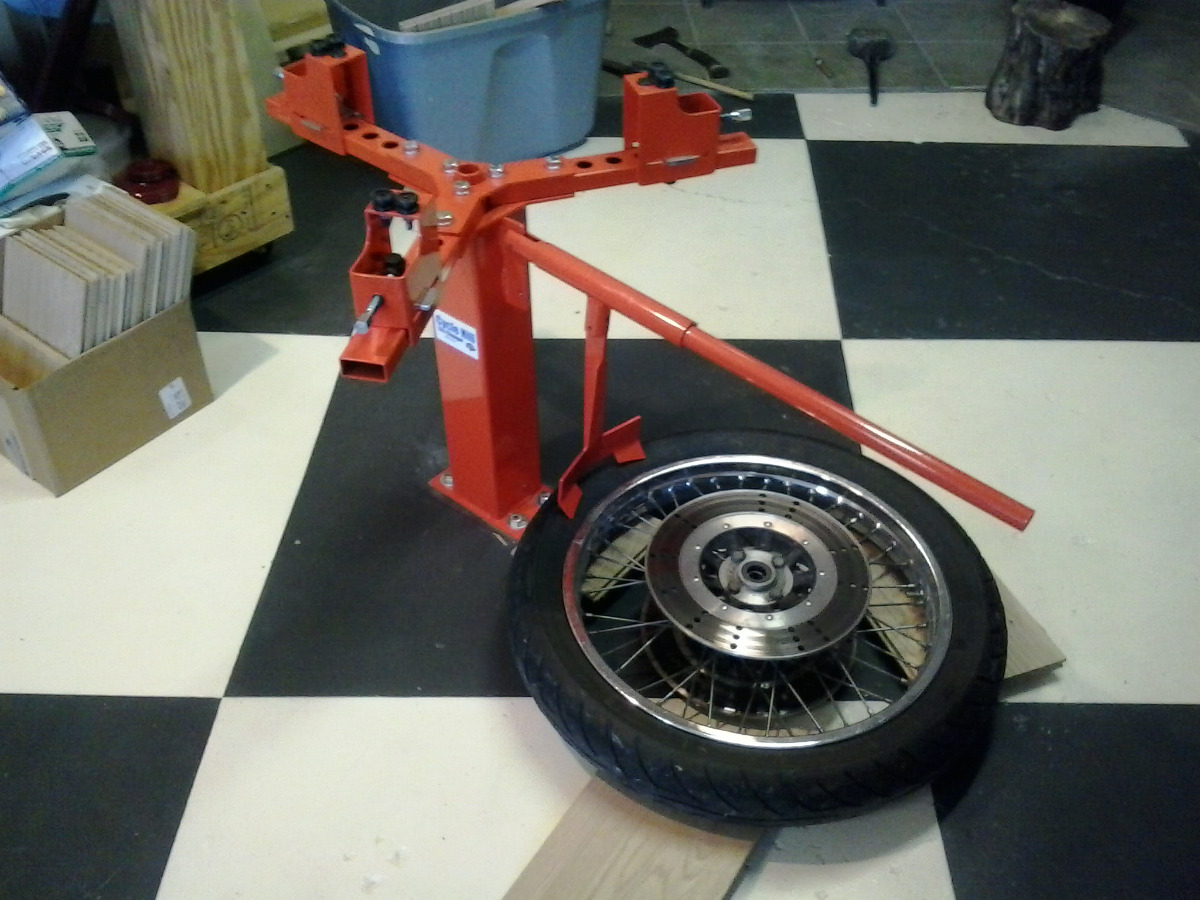

No-Mark mounted in the floor with female Redhead expansion anchors in the floor and bolts through the top. I also had to chase down about 5 missing fasteners. The balancer showed up late in the day. I hope to give it a whirl today and post some pics.
