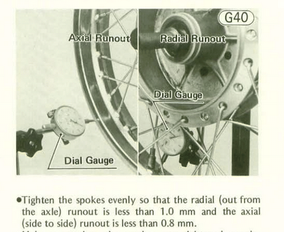

Having nice tools is nice but not necessary. I have a wood setup similar to Kidkawie. I have built several sets of wheels and the set on my kz1000 has been to 120mph many times. Its possible to get very good results with the simplest setup. I took the first set of wheels I built to "The Wheelmaster" in Auburn, WA and had him check them out; he said they were good to go. There are loads of videos on how to do this yourself, dive in! I prefer to measure off the "bead area" on the inside of the rim rather than the outside like the manual shows.
