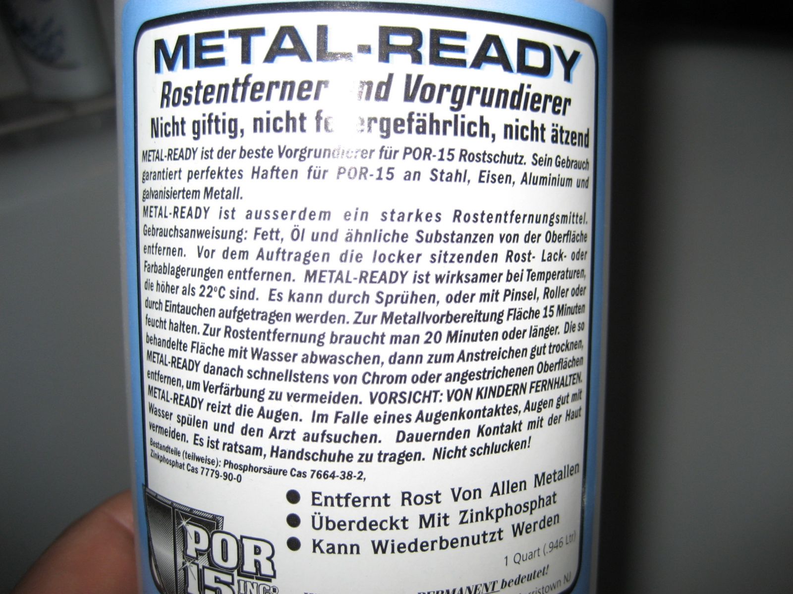

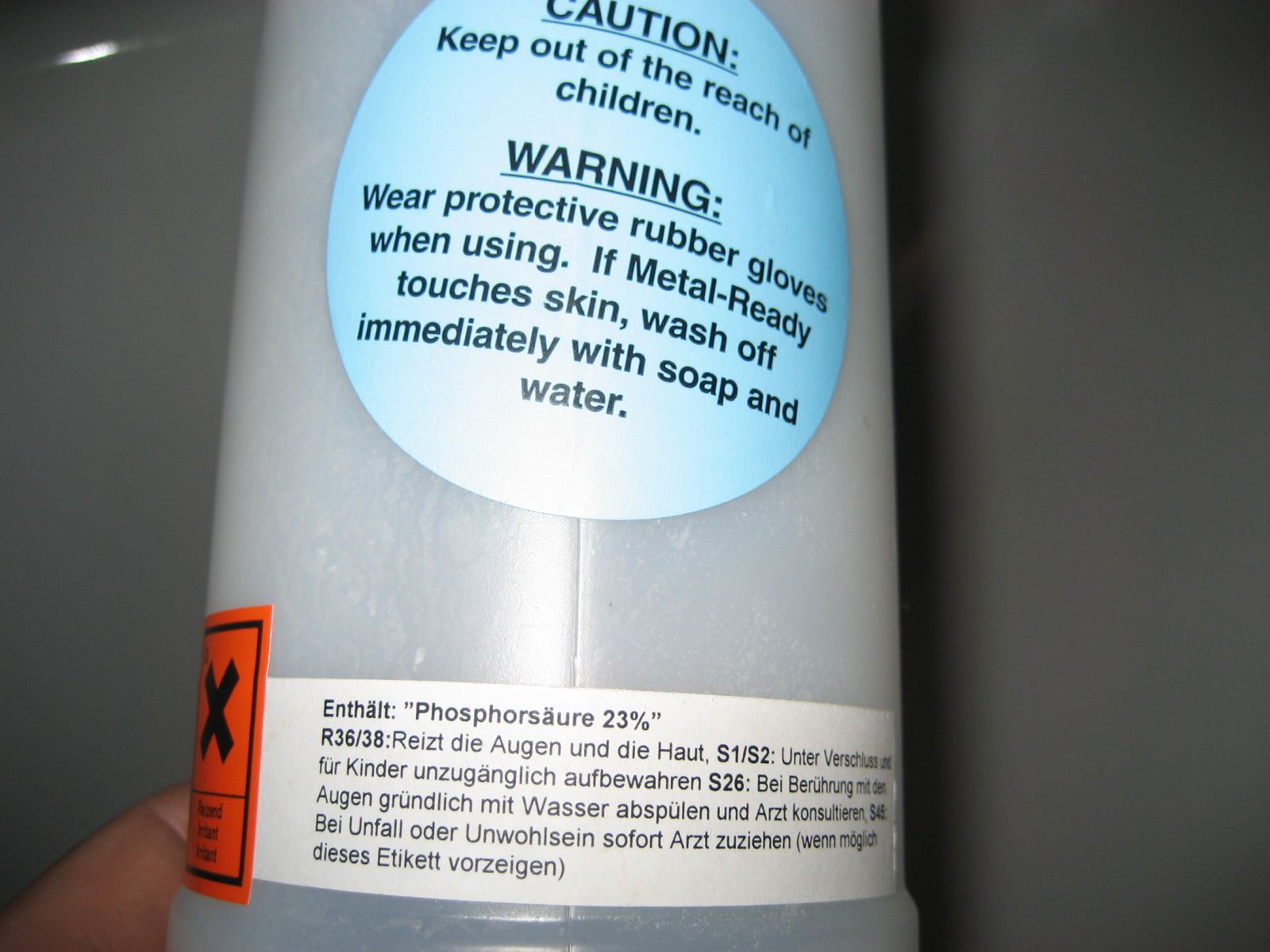

Why bother with vinegar? Phosphoric acid is a superior product for derusting. That's what the pro's use. It leaves behind a phosphate coating which retards flash rusting on rinsing as well. Save it and reuse again and again.

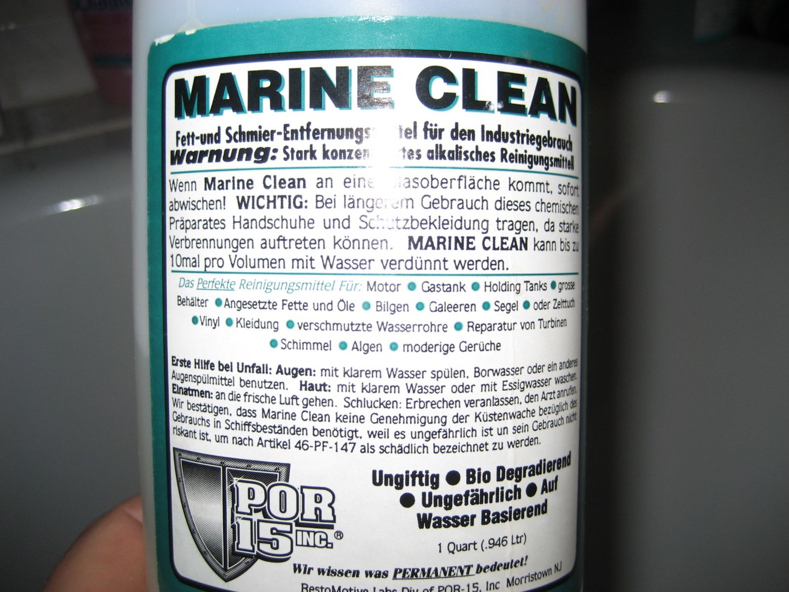

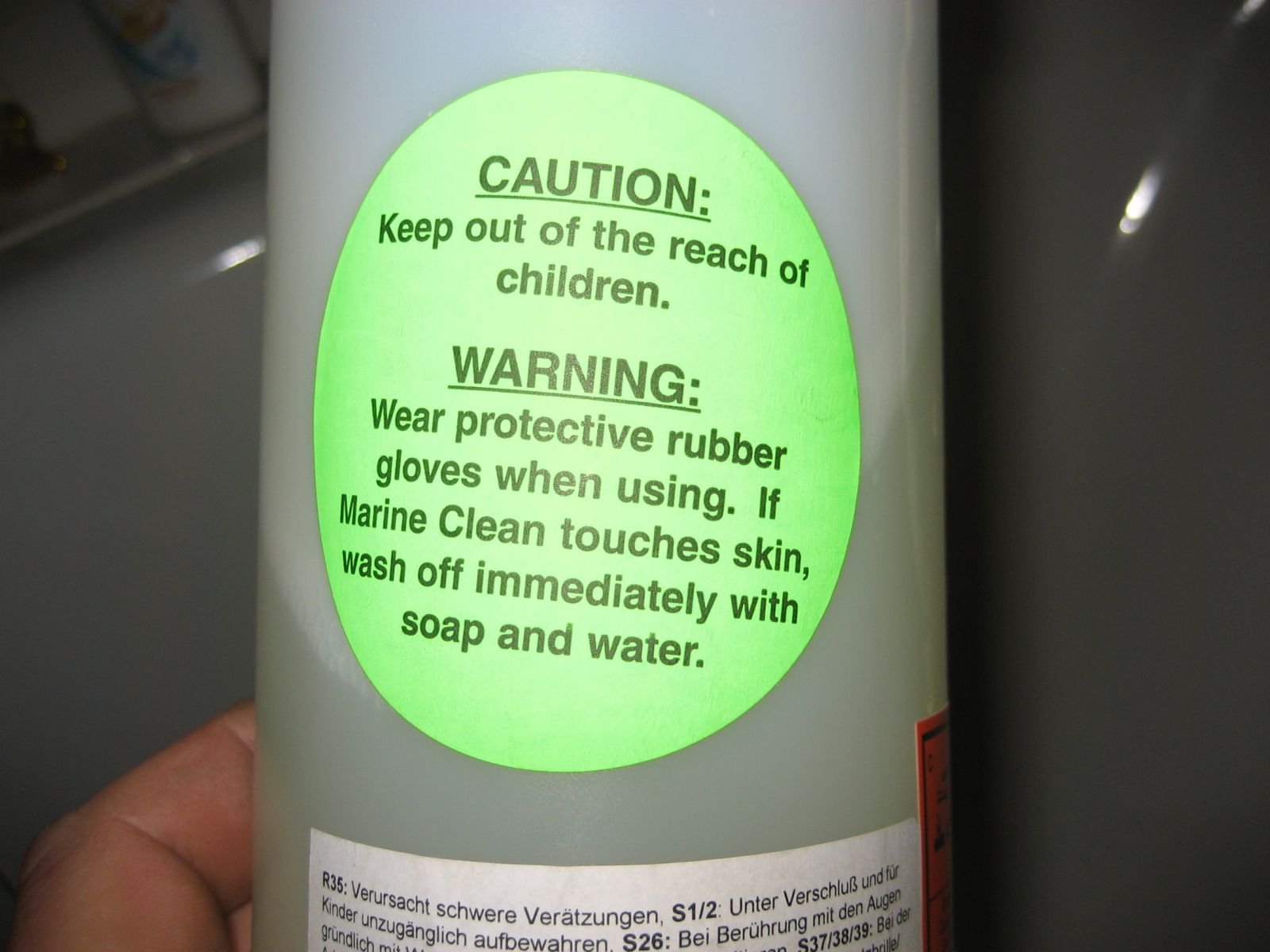

Nessism is right,phosphoric acid is the best way to remove any kind rust and it leaves behind a zinc coating on the inner tank surface.
Before you use any kind of acid and a better effect,you have to degrease the inner tank surface with a strong soapy degreaser
like Marine Clean to remove cracked fuel and dirt layers that protect the rust of any kind of chemical acid reaction.
Wear safety glasses and gloves, it will be remove your finger prints!!!
The rust remover
