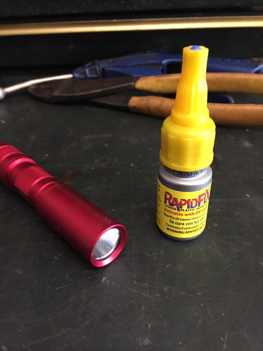

Purchased this from the local Napa parts store. It link of like super glue but UV light activated. Works good on plastic.

I tried it on rubber...does not work at all. just a note.some plastics it works better than others too. sure beats glueing your fingers together!!!! doesn't leave the "burn" marks that super glue does in some plastic.

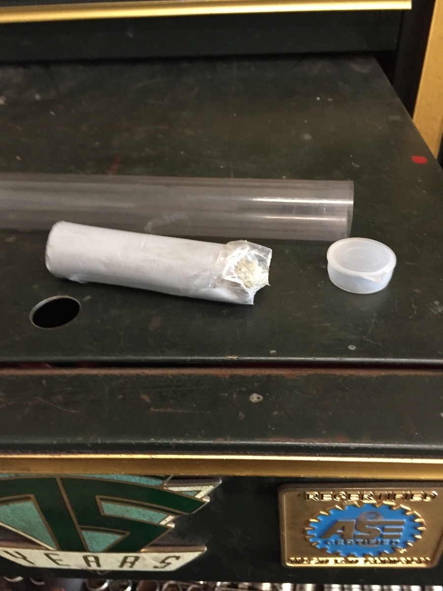

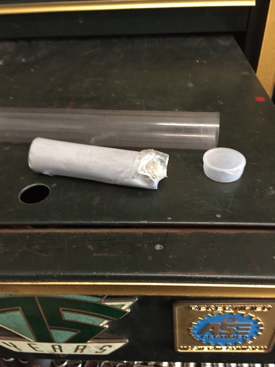

Another great product that I always have at my shop is plumber epoxy. Can't tell you how many times it's bailed me out..... everything is plastic today..... and beaks all too often!! Most any hardware store or big box stores like Home Depot have it in the plumbing section. I found that Home Depot has the long tubes of it at a very good price.
The following user(s) said Thank You: JR
- TwoCam
- Posts: 133
- Thanks: 57
Re: Glue
18 Jul 2017 07:23
one thing I found totally by accident.........before the epoxy putty cures.....if you give it a squirt of brake clean.....you can smooth it out real nice, no finger prints......gives it a nice finish. it cures in about 10 minutes, depending on outside temp/humidity. in an hour it hard as a rock. can be filed,drilled, sanded after too.

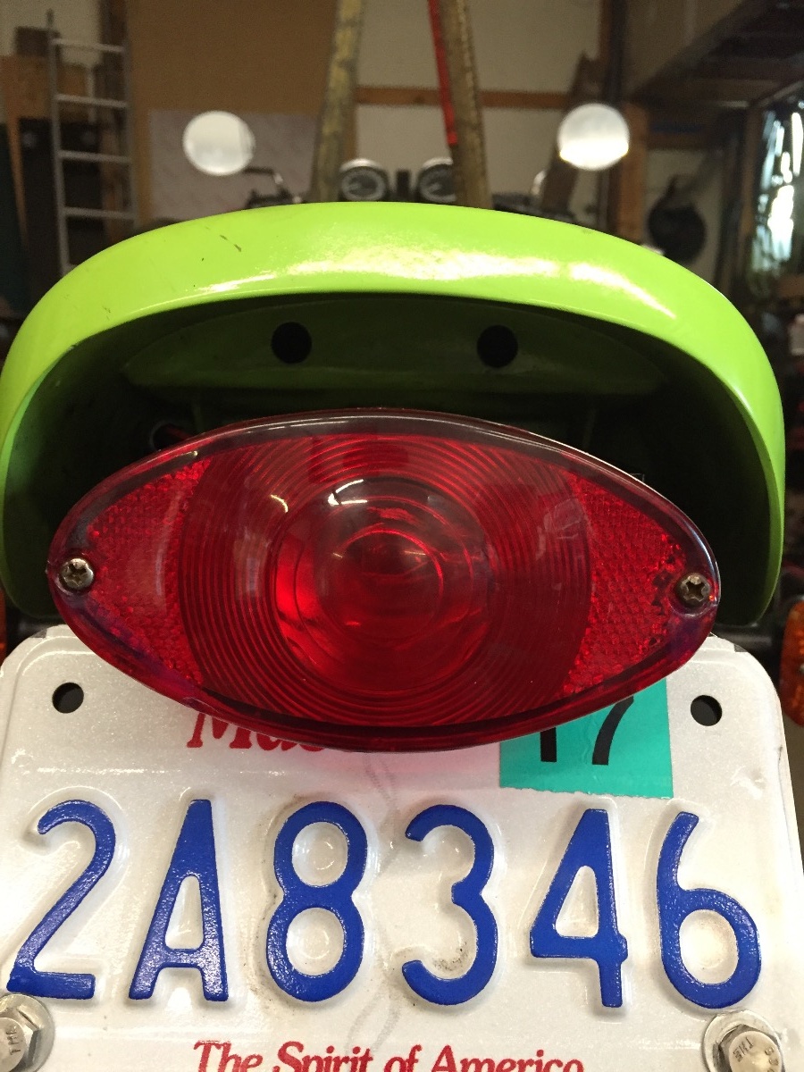

Used the UV glue on my tail light......pic of it fixed.... and a pic of where the glue is with the UV light.
