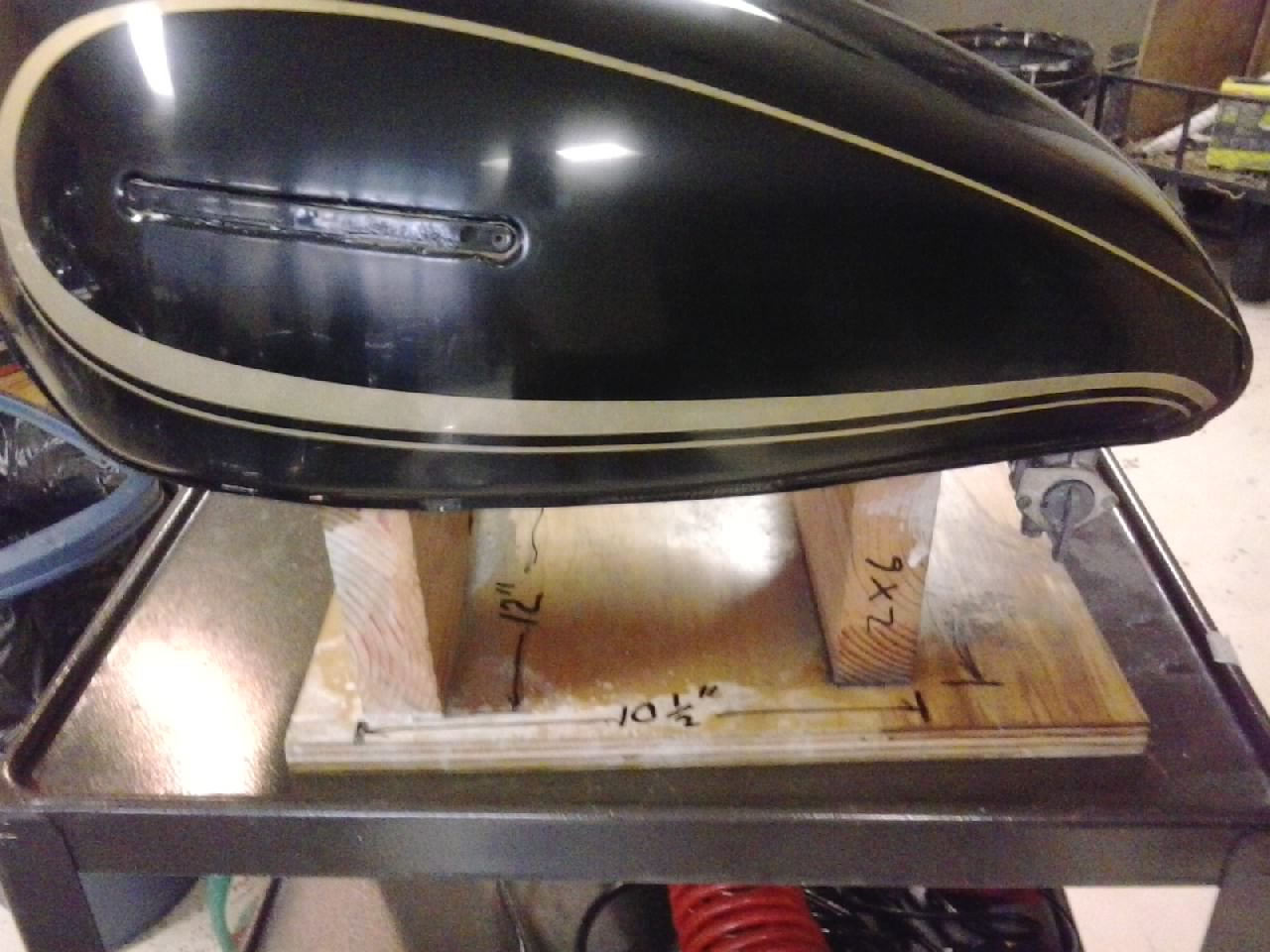

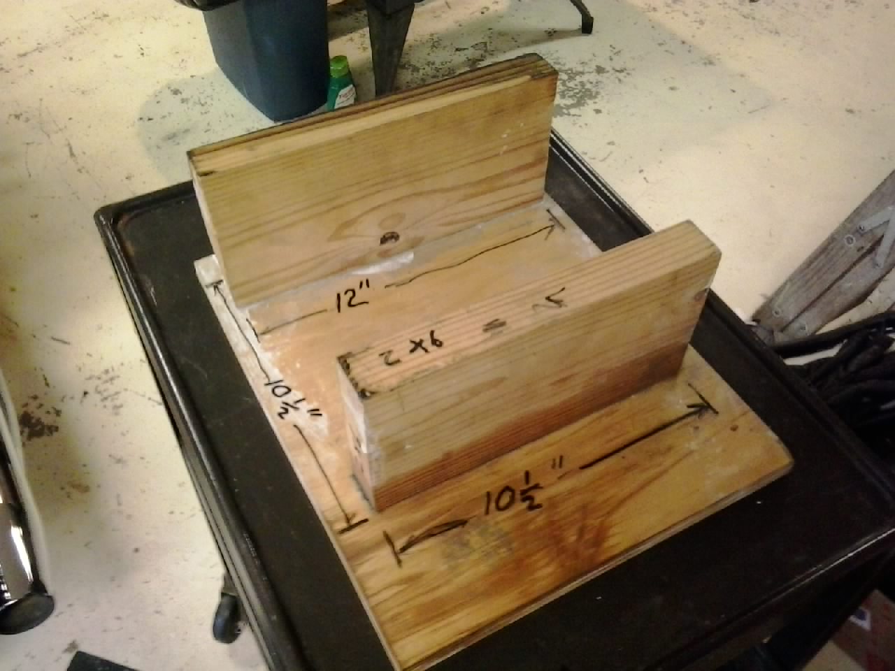

I built this a while back for stock 77-78 kz650 and kz1000 tanks and will probably make another one soon.
It makes pulling the tank and finding a secure place to set it real easy, the 2x6's fit in side the curved lip of the tank and prevent it from sliding forward or back wards.
Very solid even a full tank of gas

Nice! This is mine. You can swap the front piece 180 degrees to fit either the KZ or ZRX tanks.

Very nice...can both of you give us the How to build one plans.
