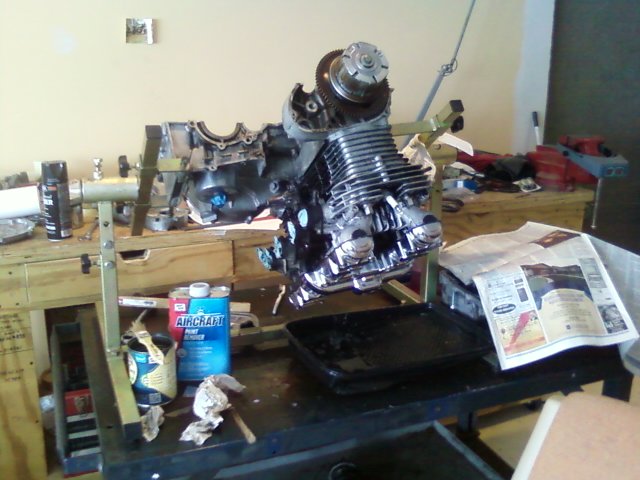

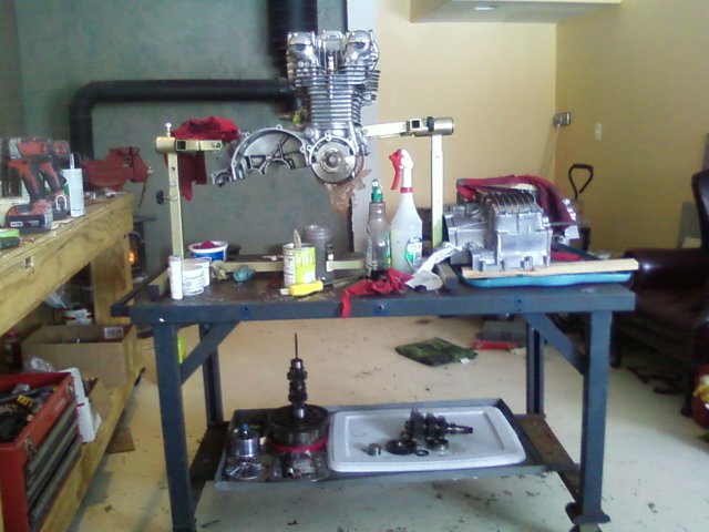

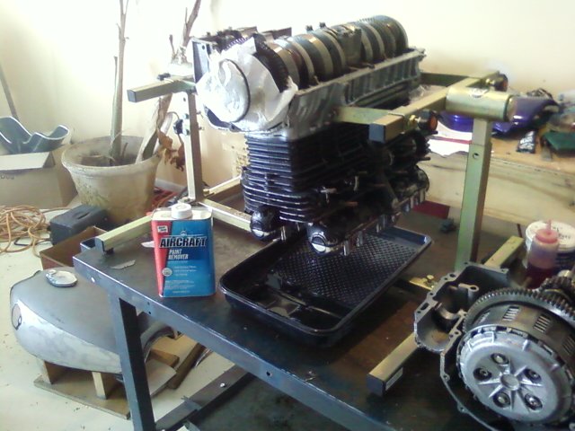

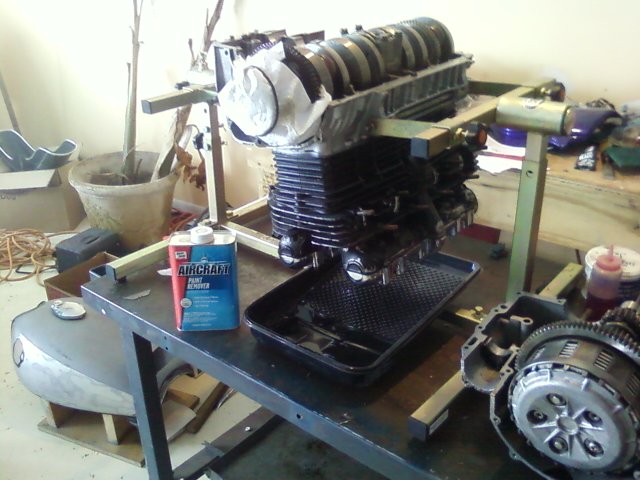

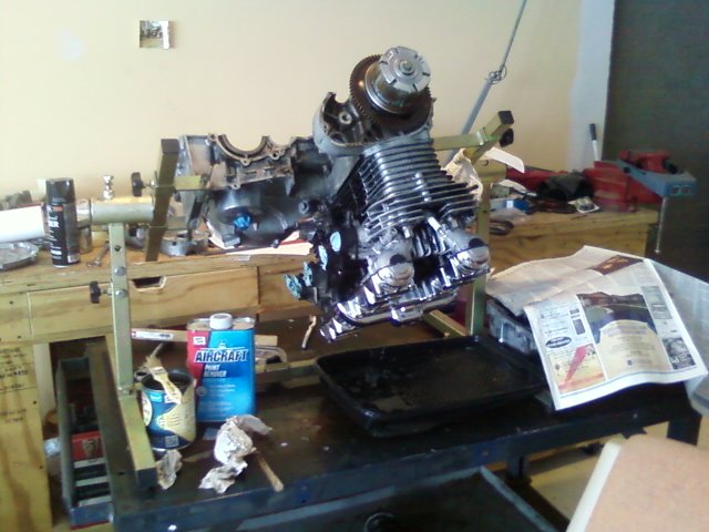

This is what I did.....
www.kzrider.com/forum/21-tools/596363-little-afternoon-project
Here is my engine currently on it. Can get everything off and back on.....
Cory
Cory
