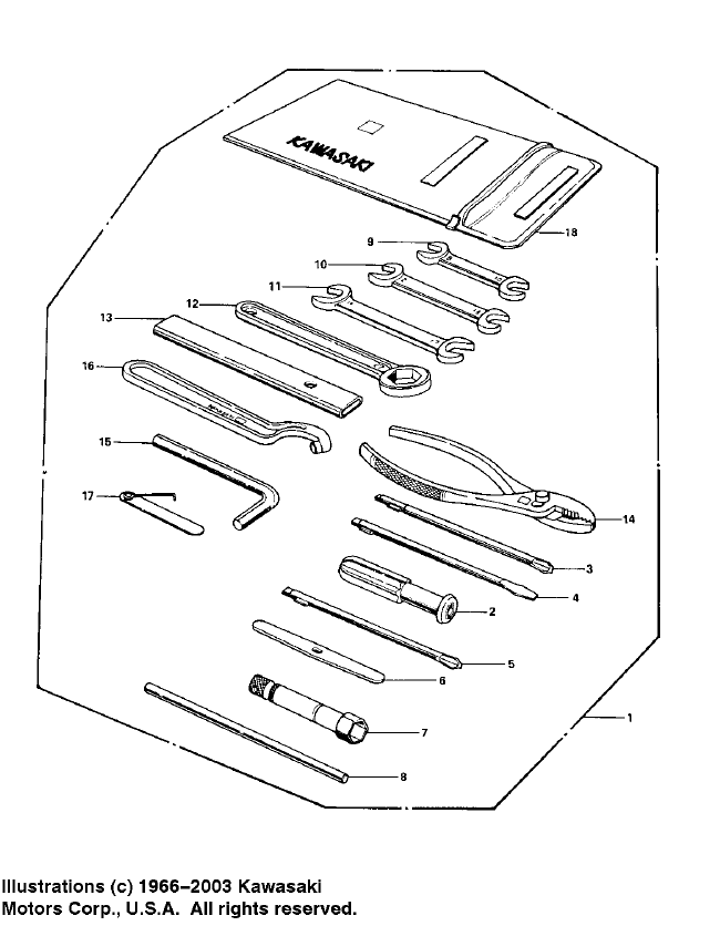

In the perhaps similar Z1 toolkit, #13 extension sleeve adds leverage to #12 rear axle nut.
Don't remember whether or not #13 also fits over #16 shock pre-load adjustment tool.

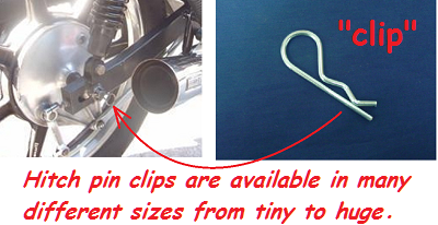

In any event, would suggest using a hitch-clip pin to secure the axle castle-nut, instead of the more common skin-slicing rag-grabbing cotter pin aka cotter key.
