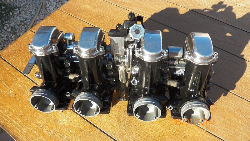

I was thinking of the same thing. I took advice from others here and completely disassembled them and soaked them in diesel fuel for a week then I soda blasted them and painted them. Make sure all the passages are clear buy using Patton's VM28 cleaning process. You can download it
HERE
Here is how mine turned out.
