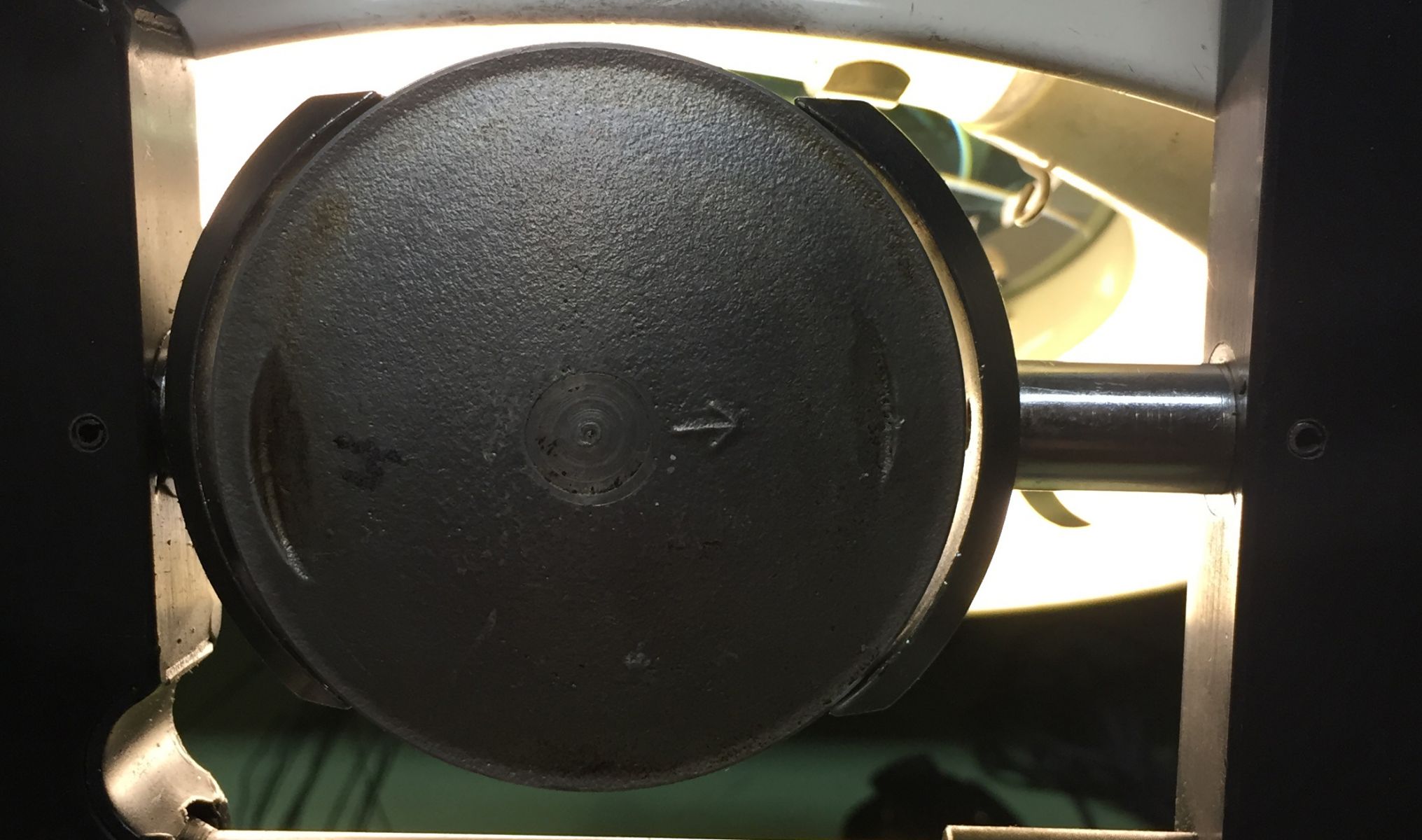

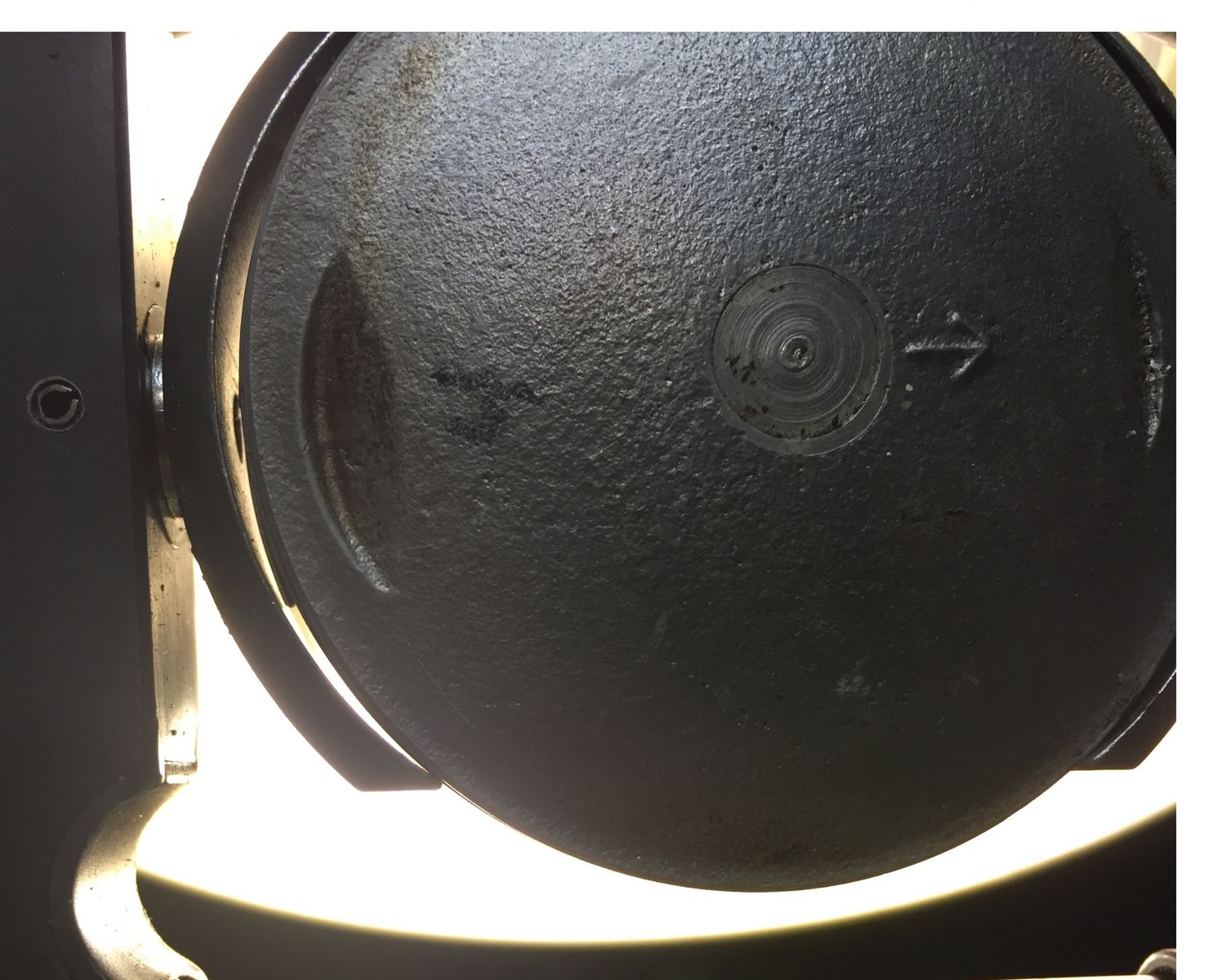

The T57001-112 works only on the 66mm or so pistons. The curvature of the actual pieces that butt up against the piston don't come close to matching the 70mm pistons of the KZ1000 motor.
The T57001-532 ring compressor I have used on up to 73mm pistons in KZ1000 motors.
If you have ever used one of these ring compressors, you would never go back to anything else. I could put the cylinder down on the pistons in about 10 minutes by myself!!!!

I have one for the 900 and wish I had the +72mm one... darn it.
below is the result of using my 112-1 compressor on an old KZ1000A1 piston.
yes it is tight enough that the points of the cups might be digging into the aluminum of the piston.
Note the giant gaps in the center of the compression cups.... and how the piston rings are not compressed into their grooves!!! I'm afraid I'd break the rings trying to shove the cylinder block down on four pistons...
I wish I knew how to use this on the larger bores.... I have a 1075 Wiseco kit with a different cylinder block bored, honed, piston fitted and ready to use on my bike, but I am not risking breaking rings with the 112-1 compressor.
