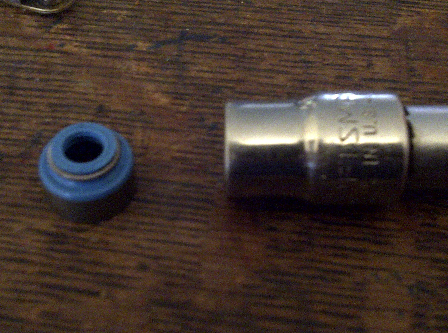

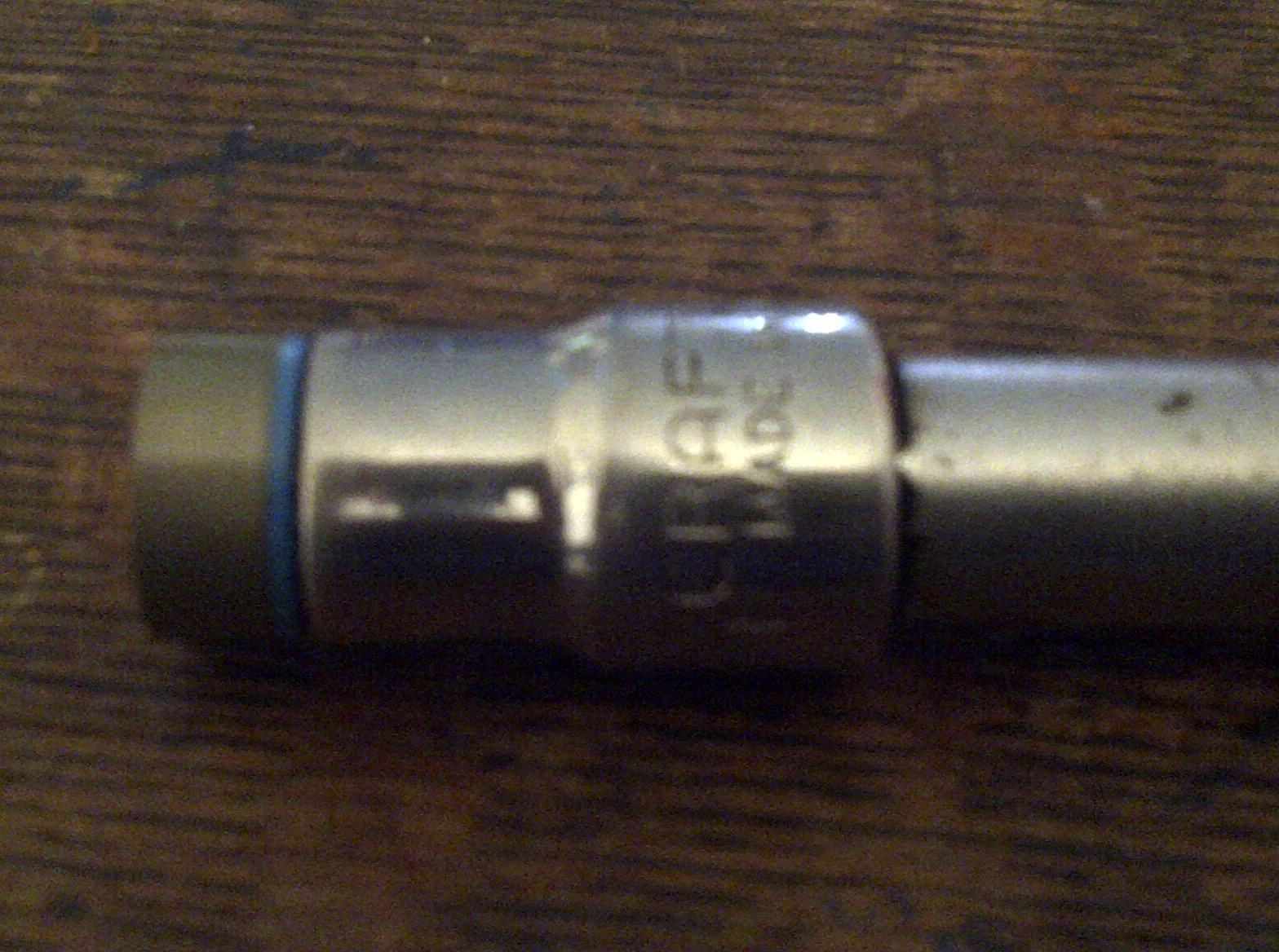

This is what I use to install viton valve seals. Crafstman 10mm socket. Just slides right in. then press them on.

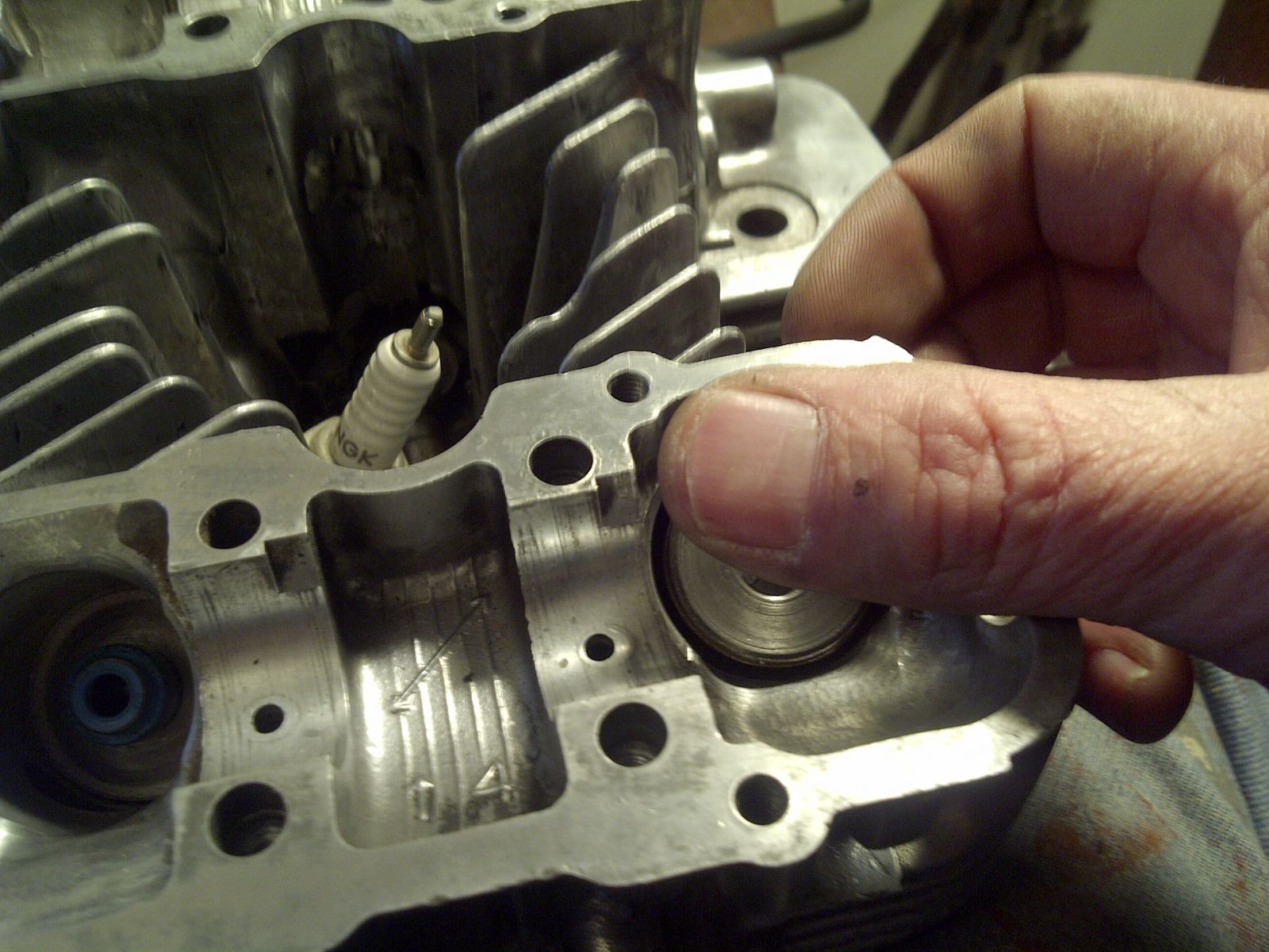

You have the hi-tech answer...I just use my finger

I put oil on the bottom of the seal and top of the guide..push the seal right on with my finger. I don't like those metal jacketed seals.
