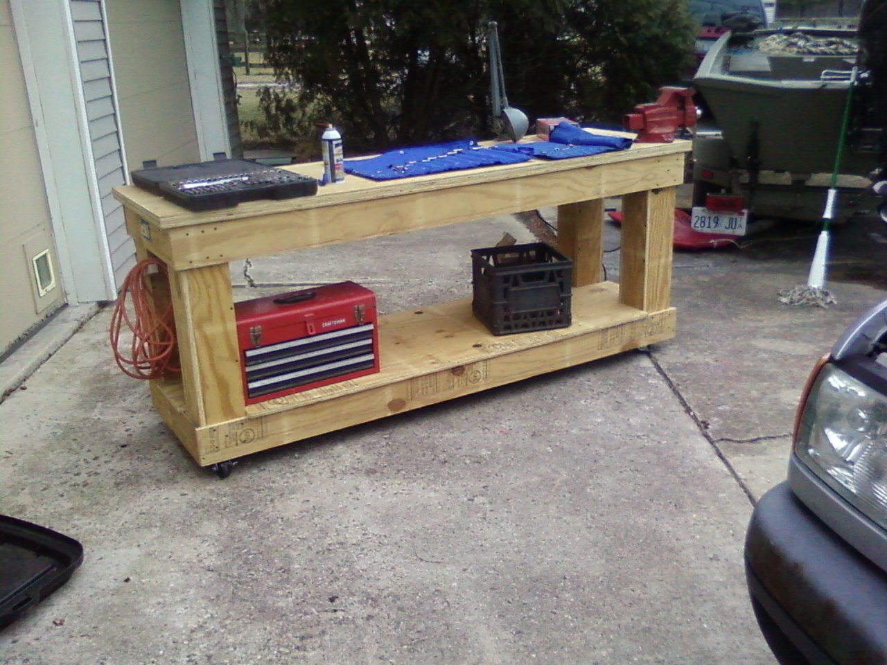

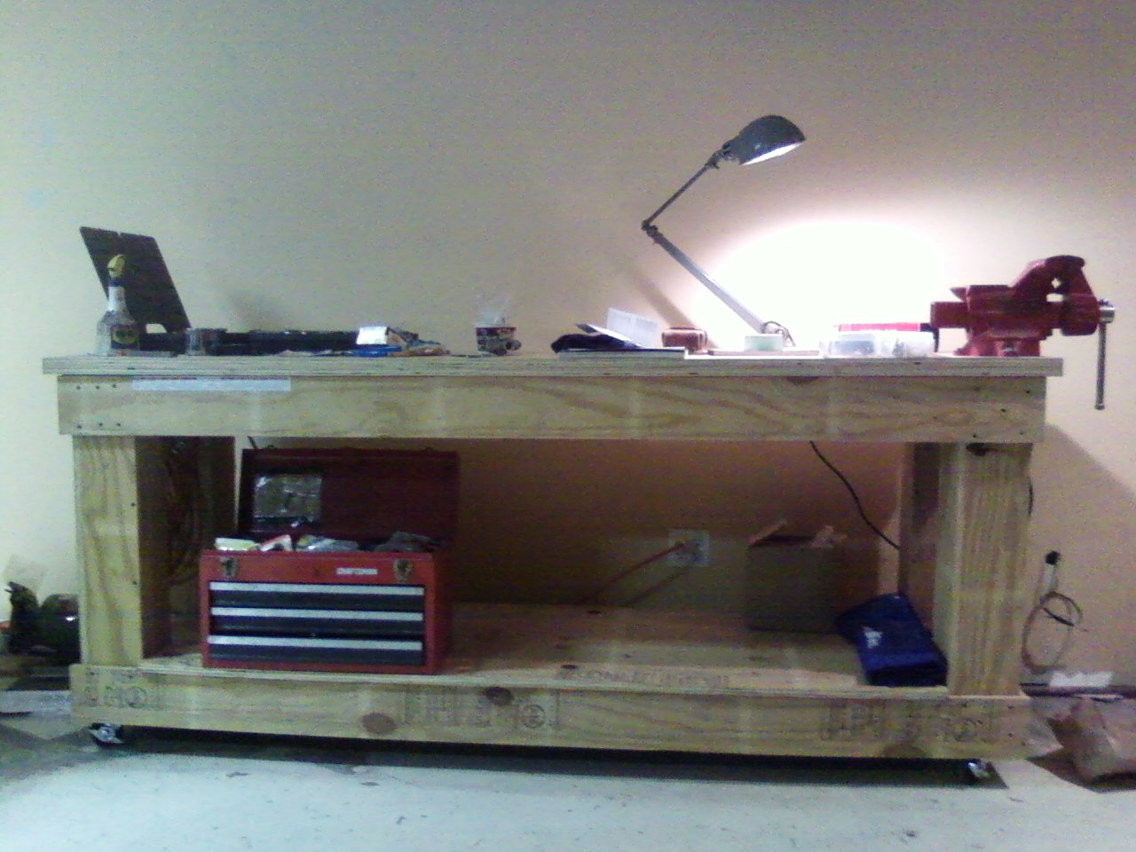

I built this bench entirely from recycled 3/4 subfloor plywood.
The only costs were the casters and the GFI.
Right now it's in my walk out basement next to the bike but I can wheel it out to work on stuff in the drive way and stash it in the garage when I'm done.

Nothing wrong with that

looks great, so when can I bring my bike over, to give you something to work on ? :lol: :lol:

Hell Blue... Attach a temp ramp on that well built beast, roll/drive the bike up nice and high for service and sell them on e-bay...

02 Mar 2013 10:39LarryC wrote: Nice work bench

02 Mar 2013 13:47Very nice portable work bench!bluej58 wrote: I built this bench entirely from recycled 3/4 subfloor plywood.
The only costs were the casters and the GFI....
GFI
On a side note -- and without having ever reasoned exactly why -- my vise has always been attached to the front left side of the bench top. :S

02 Mar 2013 14:34Because youre right handed,puts long pieces over bench when your working on them.Patton wrote:Very nice portable work bench!bluej58 wrote: I built this bench entirely from recycled 3/4 subfloor plywood.
GFIGround Fault Interrupter?
Or maybe you have a fear of falling off the end of your bench while youre working,this according to Dr Sigmund Rocks new book:Im nutz,but its ok! :laugh:

Hey thanks guys,
Pete I don't think you really want me to work on anything of yours, I just do my stuff out of necessity because I can't afford to pay anyone else to screw it up for me :silly:
I have been thinking about making a ramp system that flips up horizontally and can be broken down and stored away, stay tuned.
Yes it has a 20 amp ground fault system and I just thought that the vise looked good over there ,it also rotates 90 deg to the front .
I got the idea from a cabinet shop that I work at part time, everything is on wheels .
Everything is glued / screwed and solid as all get out, the casters are only rated to 880 lbs combined, I wish they were beefier but it was all I could get that day and should hold up if I'm careful.
It took about 2 1/2 sheets of 3/4 plywood to make.
JD
